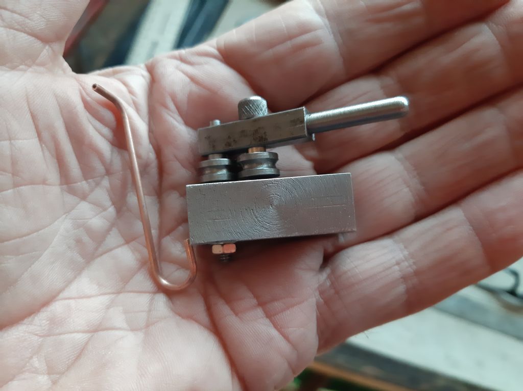

      I have been making the mini bender for 1/16" pipes.
      A few more errors I believe!!
      Nothing to serious but here we go…..
      I think the lever should be 3/16" square stock and not 1/4" as shown. No size given in issue 64 but if you check the fulcrum it has a 3/16" long spigot.
      The 0.094" size on the former is wrong, should be 0.0625". the 0.094 is correct in issue 64
      There is a size missing for the position of the left hand hand hole in the base, i.e. from the end of the plate to the centre line of the hole. I guessed 1/4" would be ok. Size also missing in issue 64.
      Geoff

        Further to my last post here it is………
        All the tiny bits really do test your patience but glad I made it as I will be using in the near future
        If anyone else is planning to make it, do have some valium on hand!!!
