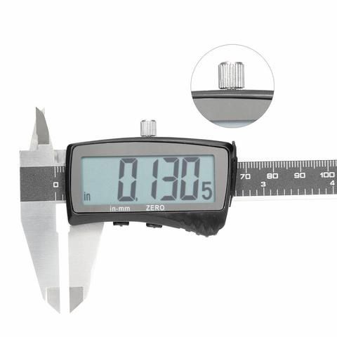

            My Mitutoyo cost me about £120 in the very early 90s and is satisfactorily accurate, remember this is not a micrometer but a digital version of a vernier caliper which you would be deluding yourself if you expected an absolute accuracy better than a couple of thou. It is better than that. A while ago I bought a caliper at the machine dro stand at one of the shows, for £26 I got a caliper with a very large display which is the next best thing to Braille, I can comfortably read it without my eye crutches and after a very quick polish is now as smooth as the Mitutoyo, accuracy is well within what I would expect from a caliper. I would not hesitate to recommend both calipers but for value for money the MDRO wins hands down. Unfortunately it does not seem to be a current stock item. This picture is the same item from another source.image.jpg

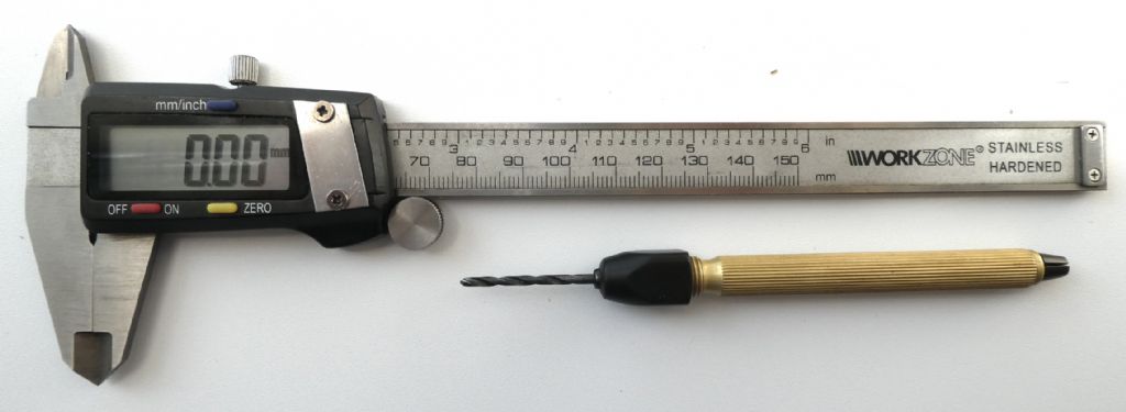

                                    I have two of the WORKZONE make and apart from one small thing I am quite content with them. The one "small thing" is the flimsy battery cover on the "instruments" which over time on one of them has worn on one edge and fails to lock the battery in position without an unsightly winding of sticky tape.
                                    I performed minor corrective surgery this afternoon using a thin alu strap and ended up so:
                                    I used the hand held pin chuck to drill the plastic case as I suspected there would be circuit/components below the screw holes (2.5mm) and so it turned out to be
                                    Only a piddling job I know but I no longer have to wince at that mess of tape.
