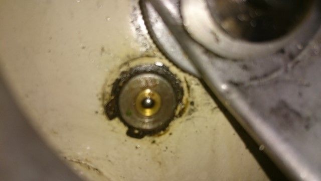

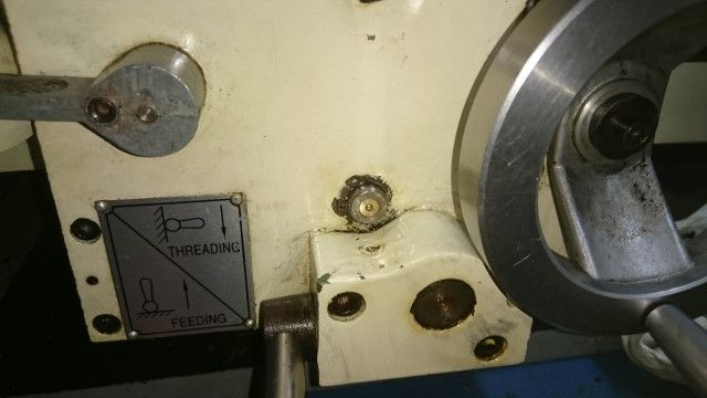

                              #278102
                              Mark Eisen
                                @markeisen61287

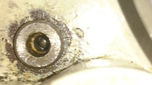

                                Sorry about being blurred trying to get a close up, but the is what it should look like.
                                #278105
                                Mark Eisen
                                  @markeisen61287
                                  Here is the stuck ball I think the silver/shiny bit on the L/H is the spring.
                                  Edited By Mark Eisen on 16/01/2017 10:09:21
                                  #278106
                                  Mark Eisen
                                    @markeisen61287

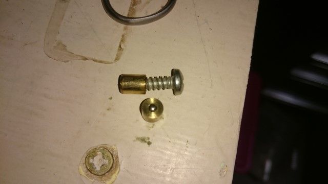

                                    Old and new Push Button oiler.
                                    I screwed a self tapper in to the old one and used a claw hammer to lever it out.

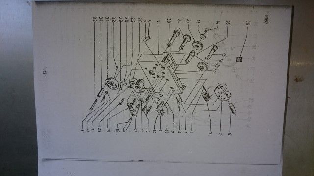

                                      The next two photos are from the very high quality loose leaved chinglish manual that came with it.
                                      PS I just worked out how to add more than one pic at a time to a post.embarrassed

                                        #279809
                                        Mark Eisen
                                          @markeisen61287

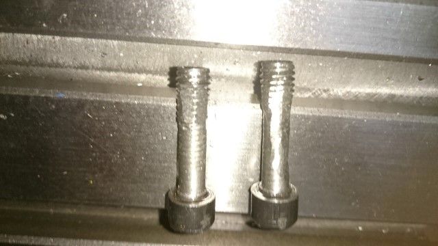

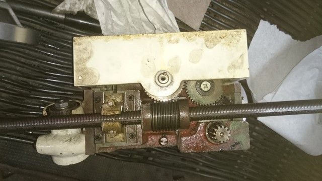

                                          Success at last.
                                          Remove the shear pin on head stock end of the lead screw,
                                          undo and remove lead screw bush block on tail stock end.
                                          Loosen the two tension cup-head screws, undo the two big cup-head screws at the front of the carriage cones of easy as pie.
                                          Note the bonus finger prints, someone with smaller fingers than me, quick scrub with kero wouldn't budge then.
                                          The two cup-head screws that hold the apron on.
                                          I will get some new ones next time I go down the street.

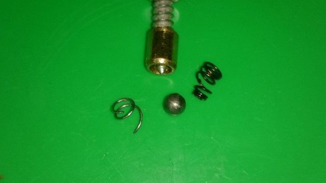

                                            Here is the culprit, some reason it had a double spring it was the one on the left I could see.
                                            Good as new.
                                            Thank you every one for all you help and advice.
