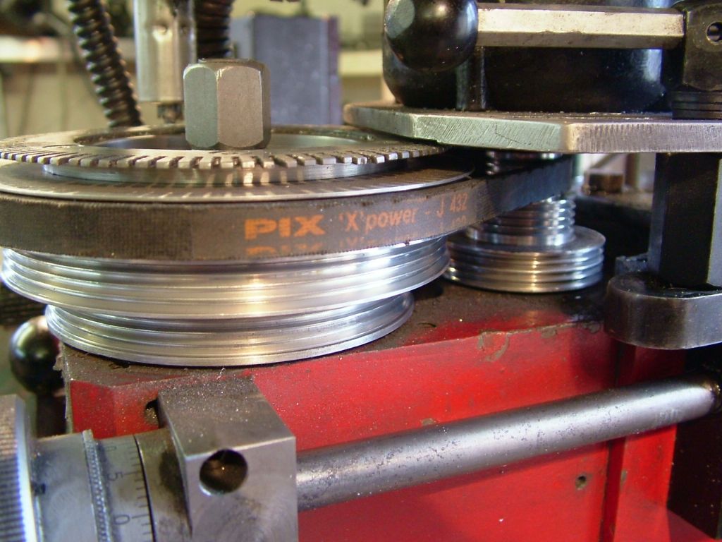

            My motor pulley has OD's of 25 & 35mm and the spindle pulley is 60 & 75mm. The V's are 4mm wide x 3.2mm deep

                    Posted by Oldiron on 22/06/2020 12:17:17:
                    Thanks, is that on a similar machine? Do you use the low speeds much?

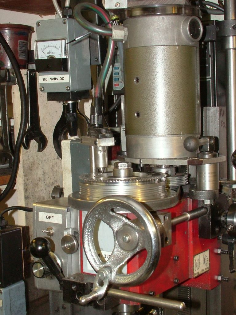

                      Hi
                      After buying an X2 Mill drill over 10 years ago with 2 speed plastic gears and spring assist on the cutting head. Rebuilt it with Taper roller bearings spindle. Fabricate and fitted Two Speed poly vee belt drive four ribs "J' section. Sold off the motor and controller and replaced with a 1.25 hp DC motor with a AC to DC variable speed Minarik Regenerative Quadrant 4 Drive Controller. Ditched the spring assist for an air spring mounted inside the column with adjustable yoke assembly to get maximum travel of the spindle. Now it is hard to recognise as an X 2 mill both in looks and performance. It is not pretty but is practical.

                        Posted by oldvelo on 22/06/2020 22:28:05:
                        Hi
                        Crikey, there should be a separate thread for most radical X2. Looks as if you've addressed the terrible fine feed as well, does the spur on top of the spindle pulley drive a powered feed?

                          oldvelo
                            @oldvelo
                            Hi William
                            "does the spur on top of the spindle pulley drive a powered feed?" No it is a slotted disc used to generate a pulsed signal to an ABS Brakes Sensor off off a Volvo to the Rev Counter off a Diesel Engine with a 96 tooth camshaft gear.

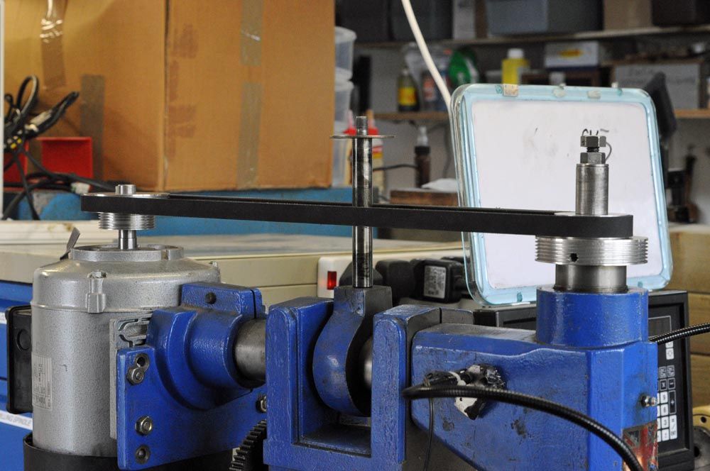

                                  It is a lot less faff making a poly V pulley than for a normal A series V belt. For these:
                                  I set the topslide to be parallel to the lathe axis and just fed in for each groove with a 40 degree form tool. The topslide was moved by the appropriate amount for each groove using the topslide dial. The belt is J form, 6 ribs. I think 4 ribs would be adequate for your purpose. Another advantage, to me at any rate, is that I don't have to slacken off the tension to change the belt on the pulley but that may just be because I have a large distance between the centres. However, you don't need a lot of movement to disengage the belt.
                                  Stay well,

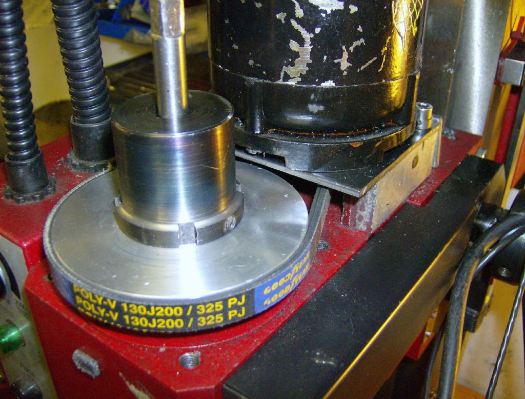

                                    #482017
                                      19mm is the recommended minimum for poly-v in the usual pitch we use (which I can't remember off the top of my head – about 3mm?) That's what I used when converting my X2.
                                      My conversion was featured in MW, some discussion of it here: http://www.model-engineer.co.uk/forums/postings.asp?th=81663

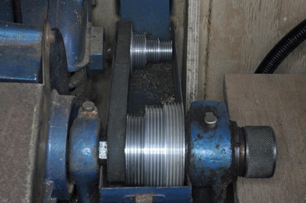

                                        Hi
                                        You may find this useful this method to fabricate Poly Vee pulleys. "J'Section = 2.34 mm.
                                        Number of ribs + 2 6 X 2.34 = 14.04 mm. The outer flange can be a larger than the diameter by 2 mm to 4 mm than the tops of the finished Vees to provide a guide for the belt.

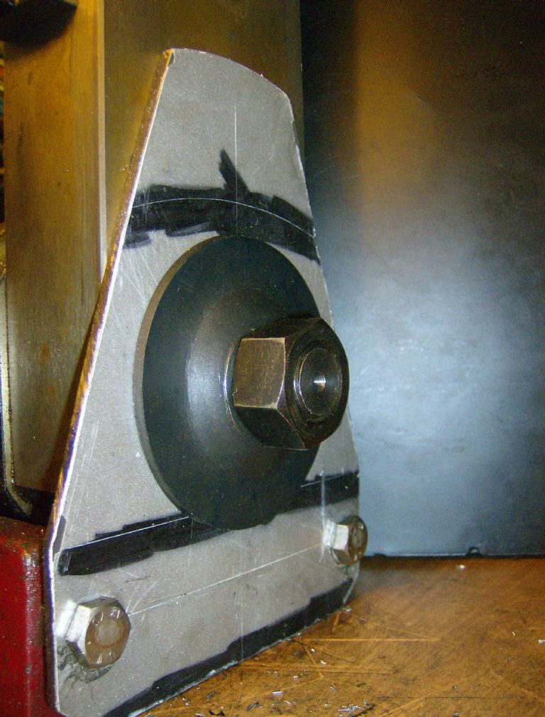

                                            Flange? I've never bothered with one, that's what the grooves are for!
                                            I seem to remember using an online calcualtor that suggested 3 ribs would be OK, two would be 'optimistic'. Mine's a PJ belt, by the way.
                                            I also scraped the base of the column bracket and added this, which makes big difference to rigidity.
