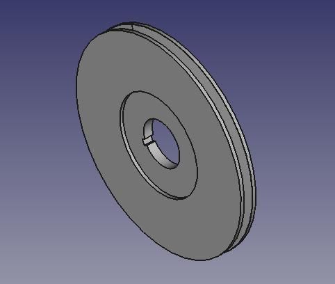

                          Ok chaps, I'm back to pick your brains again !

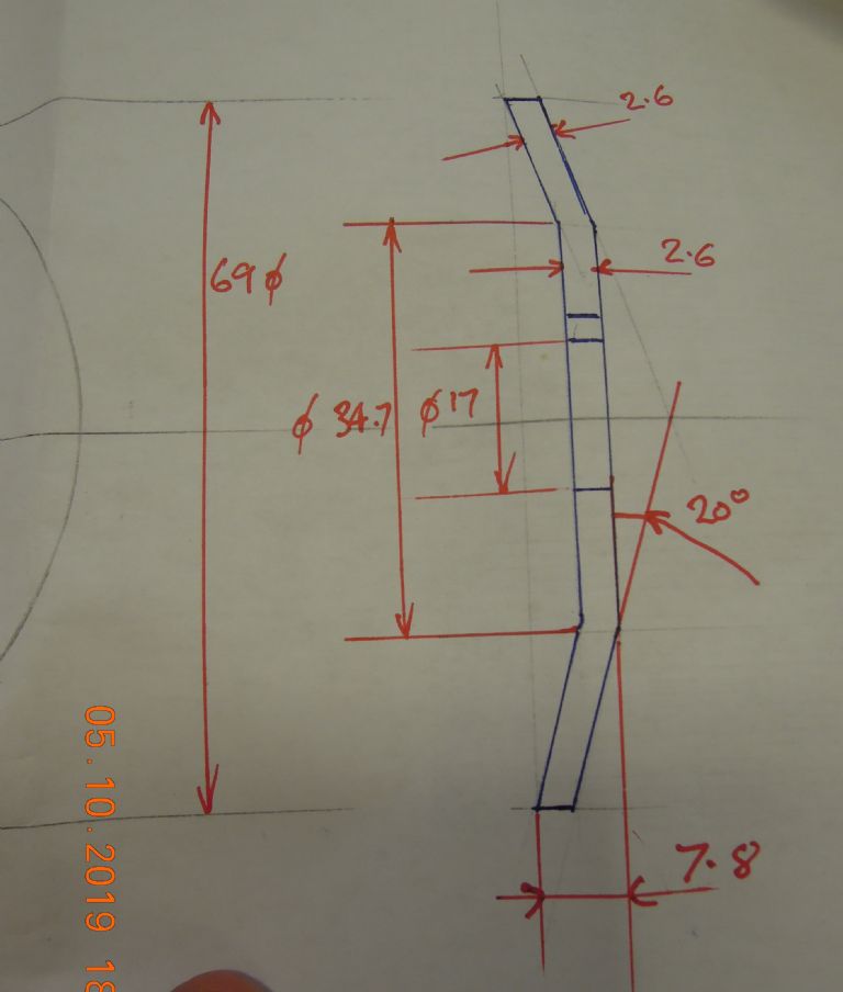

                          My smaller pulley is comprised of two sheaves. I have thought long and hard about how to hold the stock in order to create the required shape. But this stainless (303 grade) is relatively tough stuff to machine, not to mention the swarf that comes off it, so I'm quite keen to do it the right way first time.
                          It doesn't look feasible to machine the flanks holding the part by its OD in the chuck so Im thinking of this… Make an expanding mandrel to hold the part by its bore. Machine the inside face and OD. Remove turn around and machine the outside. What worries me is that the mandrel wont be able to cope with the cutting torque when Im working on the outer edges so I might need a clamping nut to make it secure. Then I have to think about how to hold the part it for removal the metal that will be left under the nut.
                          Perhaps if got it all completely wrong ?! Would be interested in your ideas on this one ?

                            If you are worried about the mandrel withstanding the cutting torque, would it be feasible to make up an arbor, with a flange welded on and trued up, with a spigot for the pulley blank, before being tapped for a couple of setscrews?
                            The setscrews could then clamp the blank against the flange, passing through holes in the blank, and located by the spigot, to allow the blank to be machined,

                              I dont see enough corrosion on your old pulley to cause rapid belt wear on a low-power application like a fan drive. Maybe try buying better quality belt and make sure the fan bearing is not nipping up under load?
                              Back to the machining: I would not faff about with an expanding mandrel. It's not going to hold well on a thin job like this one. Instead, drill a smaller hole in the centre of your blank and make a stepped stub mandrel with a bolt to hold the blank in place.
                              Then hold the finished piece in the three jaw chuck as last step and final machine the hole up the middle and the surrounding hub area to final size. If you have already done the hole in the middle to full size, make your shouldered mandrel to fit that hole and then finish off the centre section with job held in chuck by outer diameter.
                              You are making a chore for yourself by using stainless though. There's a reason commercial pulleys are pressed steel or machined aluminium etc. . Take it steady and you should get there eventually though.

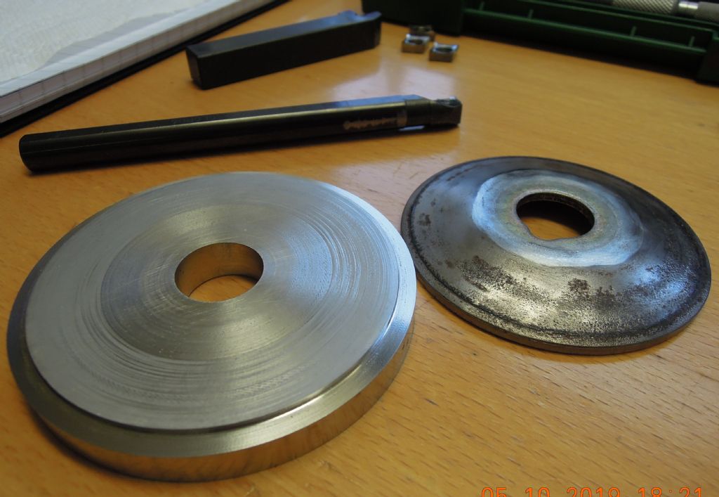

                                  Posted by gerry madden on 05/10/2019 18:52:52:
                                  My smaller pulley is comprised of two sheaves. I have thought long and hard about how to hold the stock in order to create the required shape…
                                  Incidentally, Ive been using the aluminium cutting carbide tips cleaning up the offcuts. I was looking for a speed where the swarf would come off in fine chips but between 100 and 2500 all I get is nasty razor wire spirals…
                                  Is it essential to make the pulley in two halves? The original may be made that way for cheapness; a couple of stampings placed back to back with almost zero machining needed to make them. Is it possible to replace it with a conventional pulley made from a flat disk, thinned out in the centre as necessary to fit. The advantage is the straight line machining is much simpler.
                                  The choice of Stainless Steel is making life difficult too. Many (most?) stainless steel alloys don't machine at all well because they work-harden in a blink and are tough. Nasty, unless a machineable stainless is bought. However, try increasing the depth of cut and feed-rate to produce chips if your lathe is man enough. (My WM280 just stretches into carbide chipping zone with 2500rpm and a 1.5kW motor. ) But I rarely push it that hard, preferring to put up with ribbons rather than overwork a relatively light hobby machine. Apart from anything else, the chips come off in a burning hot spray I find too exciting for comfort!
                                  I'd use Aluminium rather than Stainless.

                                      As regards the corrosion, the pics don't show the state it came out of hibernation in. They have been cleaned up with emery and wire brush, then operated for about 10 hours. Unfortunately, even in this condition, still black dust being generated indicating belt wear. But the bigger issue is due to the material removed from the pully flanks in clean-up (and the belt of course), I run out of adjustment. I can remove all the shims and still the belt is too loose. Of course I could just start machining off material from the centre portion of the flanks but then the 1.6 thick sheave isn't going to be happy about that. As you might have guessed by now Ian, the engine is from a small aircraft so my solution has to be robust rather than 'experimental'.
                                      Hopper – I think your 'process sequencing' is the right one and have nearly finished the nutted mandrel and will let you know how it goes.. I thought it might slip because for some reason I imagined the torque was going to unscrew the nut. Its actually going to tighten it ! Also, I have to put a notch in the bore of the sheave to get the pulley over a key on the fan shaft so if necessary I can use this feature for manufacturing also.

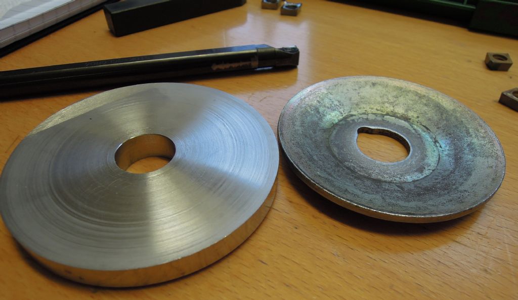

                                          First piece finished……
                                          The biggest challenge firstly was the swarf. Horrible razor sharp stuff and you have to keep stopping to clear it or it gets caught in the rotation and flails around dangerously. I discovered that cutting slowly keeps it in more manageable spirals and later with a big pair of leather gloves you can crush it up nicely and reduce 3 carrier bag-fulls of the stuff into one.
                                          Secondly the 20 degree flank angle meant the cross slide and top slide knobs tended to interfere and I had to work with the topslide almost at its positional limits. This meant that the slide was getting a bit loose in its gibs and caused the 1mm-pitched grooving you can see on the periphery. Its not really as bad as it looks in the picture so I'll run with this imperfection. But anyway I think I can avoid this on the next one with a bit more jiggery pokery.
                                          The bolted mandrel was a fantastic success Hopper and worked perfectly. Not even a hint of slip at any time so.

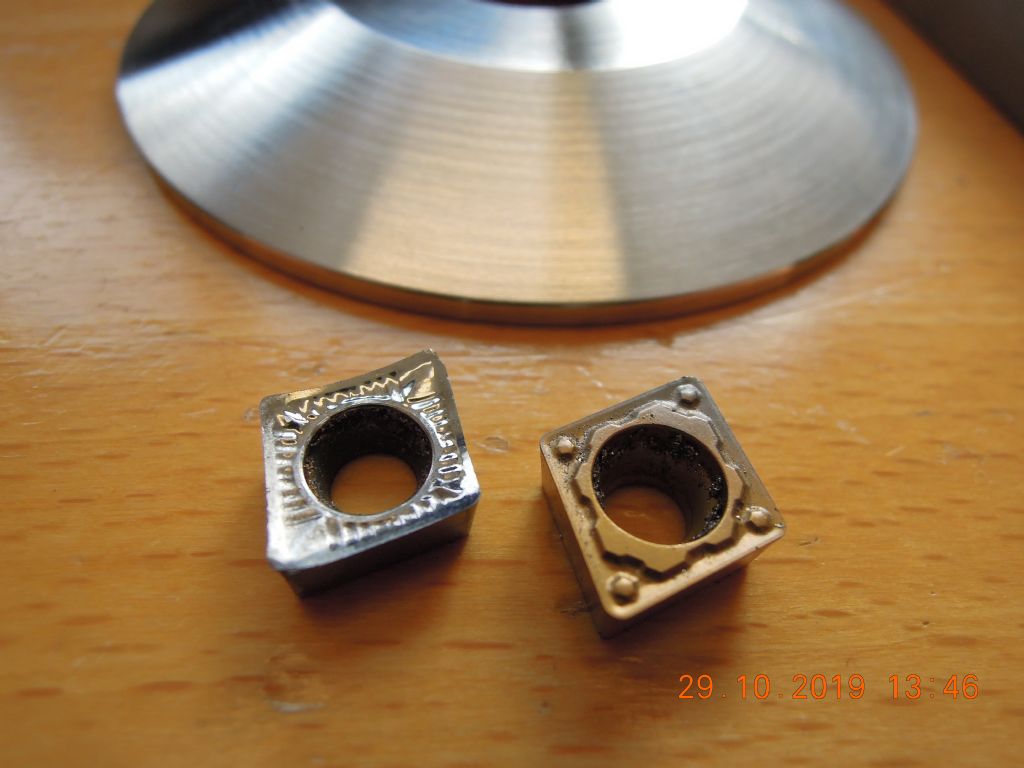

                                          The CCMT aluminium cutting tips worked beautifully at the lower speeds of 300~500RPM. At 2000~2500RPM they frequently chipped. I couldn't work out at first why the cutting quality became progressively worse until I looked at the cutting edges with a microscope and found the reason. This issue wasn't really obvious by eye.
                                          Ian P, I think the reason for the severe wear might be the speed. I didn't think about this earlier but the engine runs almost continuously at a 5000RPM so the fan will be doing about twice that. I do know from the past when I've fitted new pully sheaves the system/belt is almost wear-less. So I don't think there is any other defects in the set-up like misalignment etc.

                                            For the second of the small pulley sheaves I got some tips designed for stainless steel cutting. They look like the one on the right, with the aluminium cutting tip on the left.
                                            Really pleased with them. They seem to cut just as well at any speed and leave a nice finish but usefully don't have that rather fragile sharp edge which is so easily chipped.
                                            I have also leant to get along with the swarf which I really didn't like initially. Stainless steel swarf is quite crushable, unlike aluminium. With a pair of tough gardening cloves on you can collect it and compress it into quite manageable volumes.

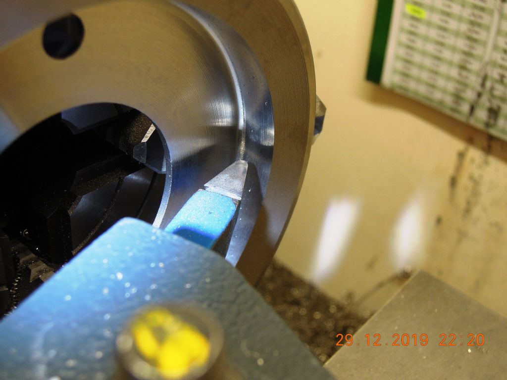

                                              Well that was a welcome Xmas break as I finally managed to finished my crankshaft pulley in stainless steel.
                                              The issues I had with making this one was putting in the corner radii. I have a brazed carbide tool with a tip radius of about 1.5mm. I thought this would do nicely. Unfortunately once the cutting chip-width exceeded about 1~1.5 mm seriously bad structural vibrations started. I tightened everything, reduced overhangs and even tried cutting on the opposite side but failed to make any significant improvement in the cuttable chip width. I guess the machine is simply not rigid enough to plunge this size tool into the workpiece.
                                              In the end I had to form the radius by lots of small bites that blended into each other then clean up with emery cloth. (You can still see a little bit of a chattered surface though.)
                                              Perhaps the material I was using wasn't the best in machinability but I see indexable lathe tips for sale with radii of up to around 5mm for wheel profiling and wonder how others get on with these ? Or perhaps there's some tricks I don't know about ?
