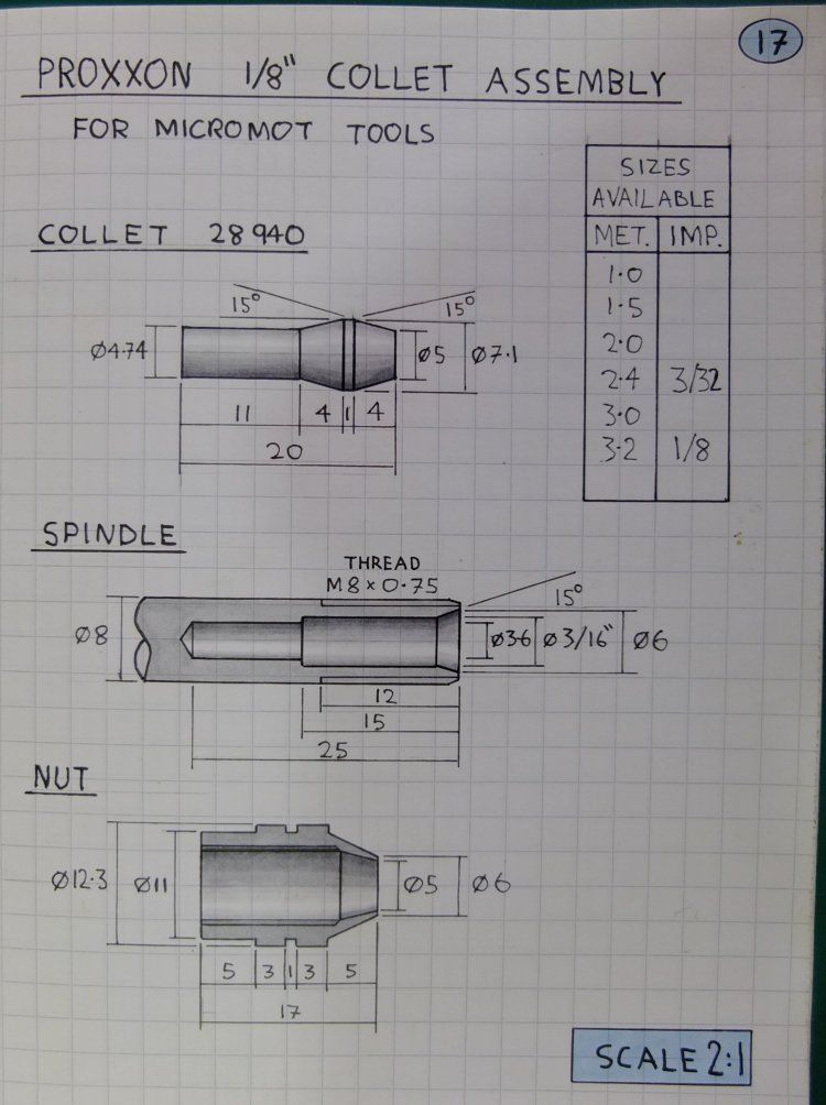

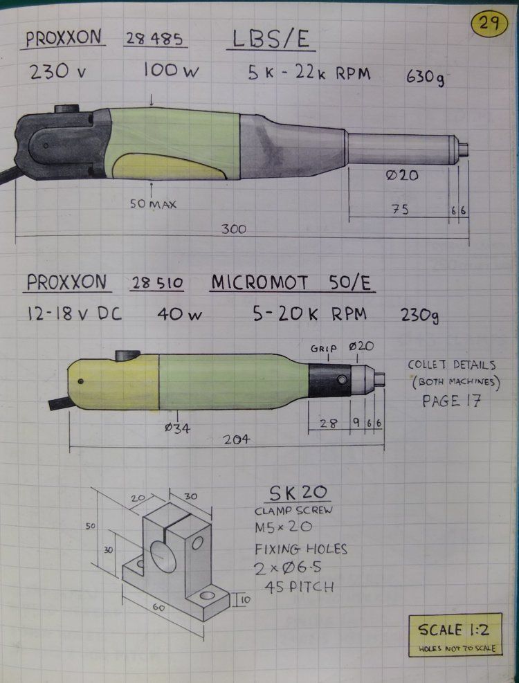

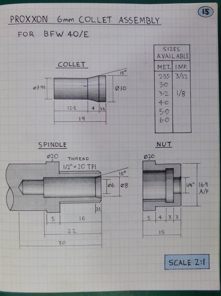

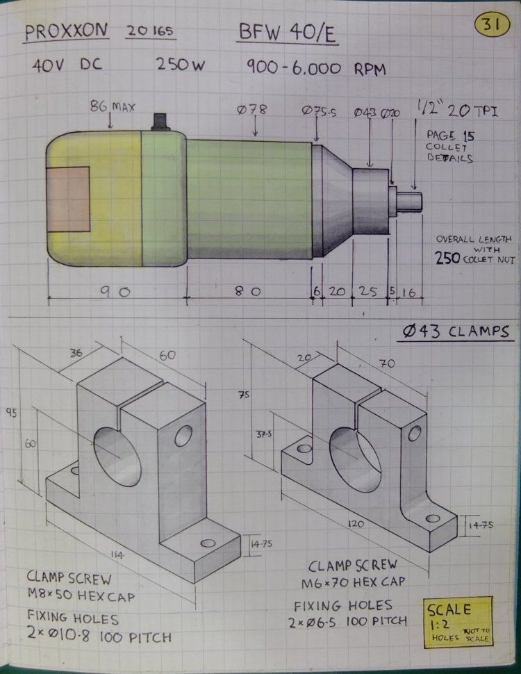

      I use 3 Proxxon spindle machines, the small ones as a Dremel and the larger to drive other tools via pulleys.
      To help me make attachments for them, I've jotted down their vital statistics.
      I'll share them here as they might be of help to someone.

          Lovely drawings, I do hope you post more.

                  Properly drawn, not by CAD.

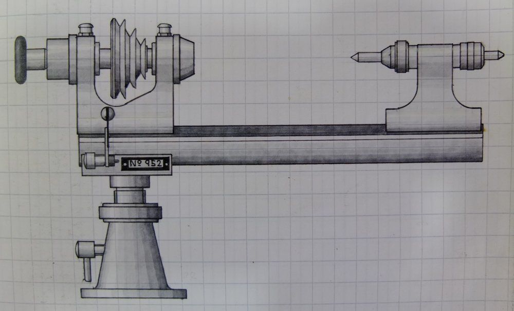

                    A couple more drawings. A Champion No1 bench drill and an IME watchmakers lathe, both driven by the big Proxxon.
                    I have not dimensioned these but they are both drawn to half scale on 5mm squared paper, so each square represents 10mm.
