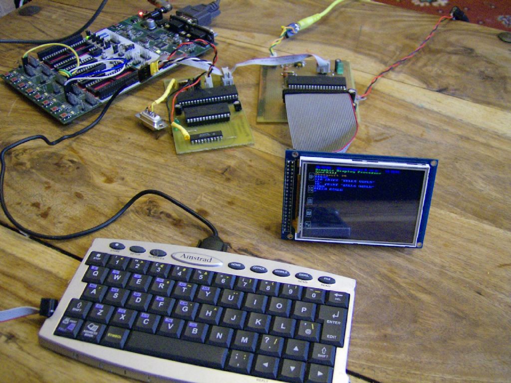

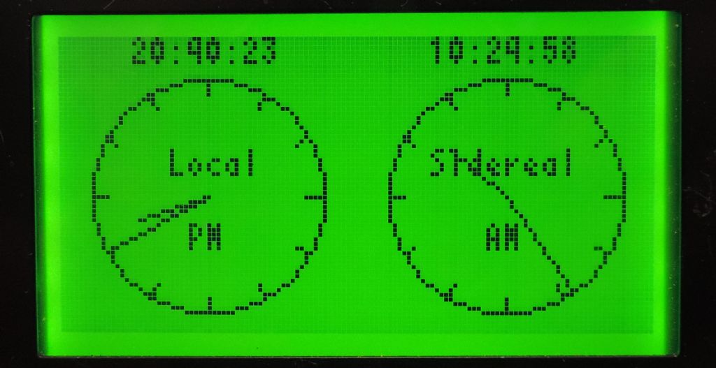

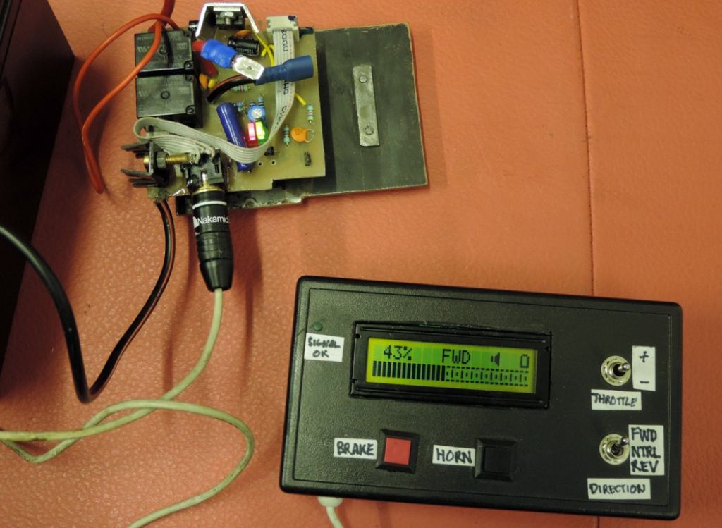

                                              AVR interrupts are rich pastures, but because the Arduino has a whole 'abstraction layer' of its own core functions you lose some of the flexibility.
                                              Personally I've barely done any arduino programming, but have done some really heavyweight assembly language programming for AVR (C is for wusses ). I love that initimate engagement with the hardware and the ability to cut corners and do things like really efficient maths through bespoke code or working only to the level of precision you need.
                                              I've done a few fun things:
