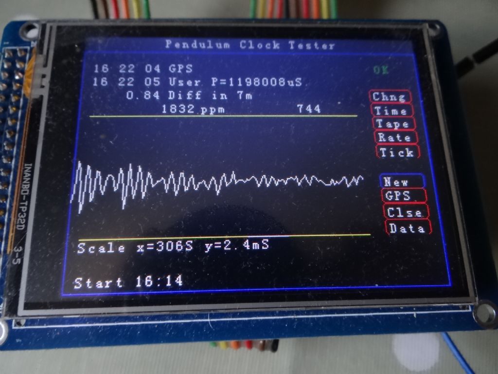

                          My current project uses a Sainsmart TFT Shield with a 3½ screen, which plugs into a Mega. (Although the link is to the US, I got mine in the UK, probably via Amazon.) Display and touch both work ok with the TFT library.
                          The main problem with TFT screens is the large number of connections needed. Lots of wires, and not many Input Output pins left for other work. I find a Mega provides much more room to maneuver than the Uno – more pins.
                          The shield considerably simplifies and tidies up the wiring! It also comes with an SD-Card interface, which may be handy.
                          Getting at the unused pins on the Mega under the shield is slightly awkward but right angled connectors fit OK. The main downside is the cost, but it's a neat solution.

                            Thats impressive! Didnt realize the amount of pins that's needed, rather assuming that I2c would take care of things like that, bit too advanced for my present state of development!
                            Must admit find the cheap1602 type lcd display with white letters very readable but want to progress/learn as you do hence the question.
                            Thanks Peter

                                Posted by Peter Bell on 03/10/2018 11:01:26:
                                Thanks Peter
                                You can deliver a powerful user interface with a Touch Screen TFT so they're well worth investigating. My clock analyser looks like this:
                                The screen does 320×240 colour pixel graphics and there's a fairly simple library for writing to the screen and detecting X Y coordinates when a pen touches it. I wrote a small class library to do buttons, and – because displaying text is amazing slow on a TFT – a class that only updates text objects on change. Not much more difficult to do basic things than a 1302 LCD but knowing C++ helps if you want buttons. (I haven't found a standard library that provides GUI controls.)
                                I'm not aware of an I2C or other serial interface being available for these screens: I guess serial is too slow. Speed problems sometimes cause bother with 1302 LCD displays as well. These are fastest in 8 bit mode, reasonable in 4 bit, and slowest with I2C. Worth checking the display is quick enough if your project is time critical, especially when planning to use I2C. (When not speed critical, I2C is wonderful.)
