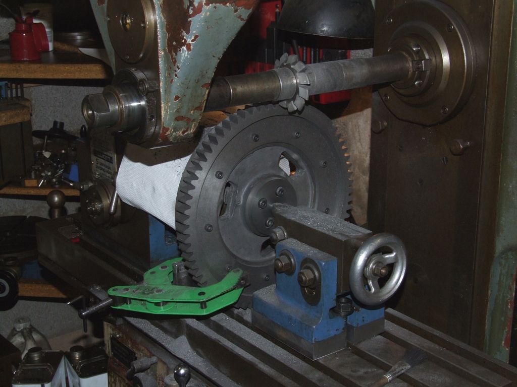

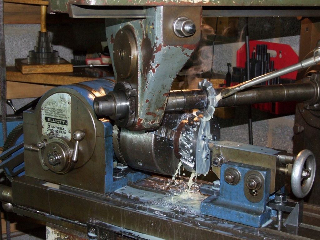

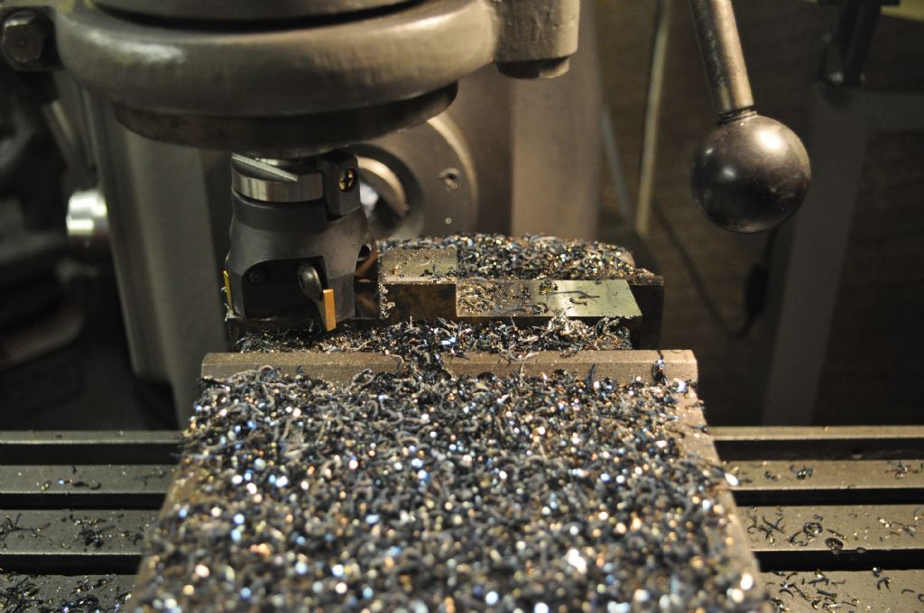

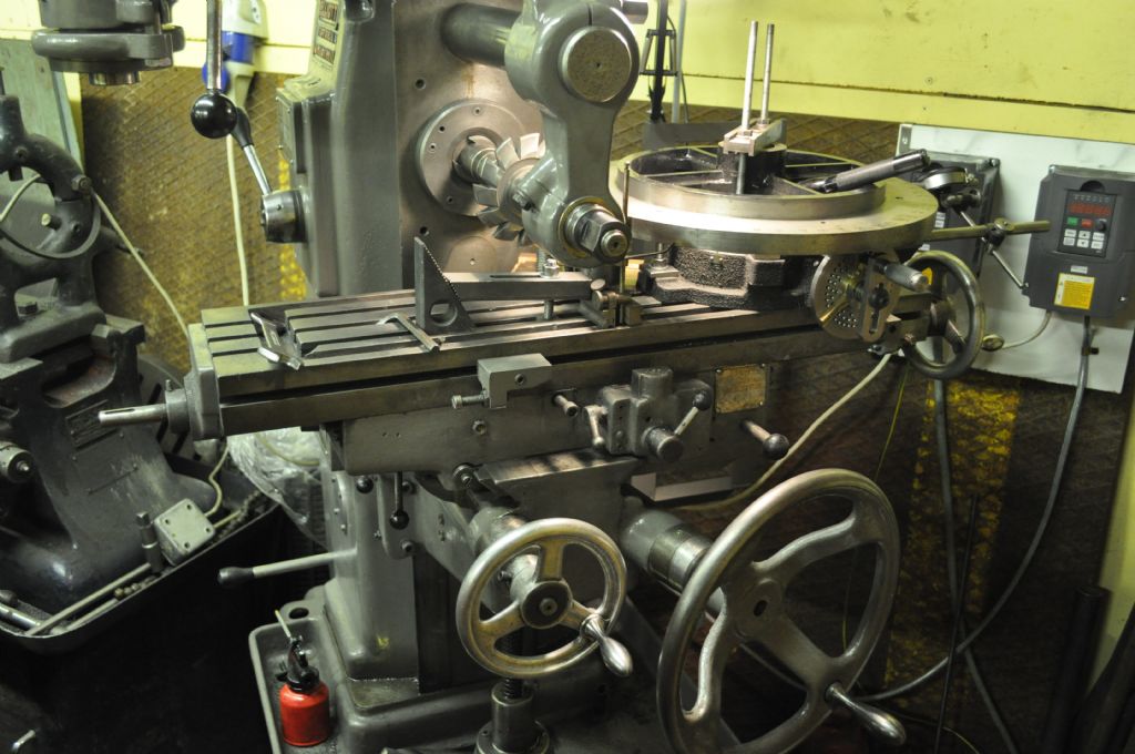

          I've got both vertical and horizontal mills. I do 90% of my milling on the vertical mill (Bridgeport), along with 99% of my drilling. The horizontal mill was an impulse buy, bargain at £175. Some of it's characteristics, and uses are:
          It's built like a brick out house, weighs nearly 2 tons and puts the Bridgeport to shame in terms of rigidity.
          It's powerful (5hp) and can remove metal like you wouldn't believe.
          Although much heavier than the Bridgeport the axis travels are somewhat smaller, about two-thirds or a little less.
          I've used it mostly for gear cutting, spur gears, free hobbing of worm wheels and helical gears
          Other uses are cutting splines on a crankshaft and hogging out large lumps of hot rolled steel much faster than the Bridgeport
          I will be using it to machine the cylinder blocks for my traction engines, both to machine the block and bore the cylinders and liners, as a sort of poor mans norizontal borer
          Although it was an impulse buy I've more than got my moneys worth, and I wouldn't be without it. The vertical mill simply isn't rigid enough to do the sort of things I can do on the horizontal mill. Like cutting large spur gears:
          Or cleaning up hot rolled steel:

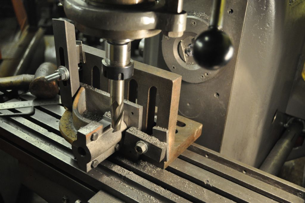

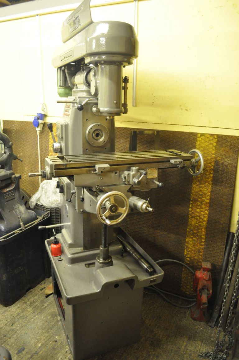

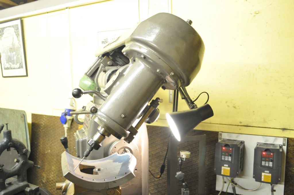

                I would suggest you look out for one of these! They don't seem to come up often but they are brilliant 'little' machines with the best of both worlds. Separate motors for horizontal spindle / X axis feed and vertical head, good range of speeds as standard but in combination with VFD's as they are usually 3 phase, speed control is infinite.
                It's an Elliott Junior (Omnimill). Vertical head moves in and out on its overarm and swivels in two planes and can get to any area of the table.
                That is a 3/4' slot drill on cast iron.
                That is a 2" carbide tipped face mill (on steel).
                That is a 4DP, 56 tooth gear (its about 16" in diameter).
                The knee hand wheel was changed to this bigger version by the previous owner, a very worthwhile mod especially for the amount of handle turning needed on the big gear cutting. I bought this as a result of a chance conversation about this time last year. Took me about 3 months from collection just before Christmas to fettle it, sort out some VFD's to get it up and running. I still have the coolant pump to sort out (it has a built in tank in the base) but the standard pump is belt driven and when reversing the main motor you have to cross the belt, its only real down side. A kind benefactor has given me a stand alone pump which I still need to install. Since commissioning it has done a lot of work on my 6"scale traction engine on cast iron and steel components including cutting all the gears. There is nothing on the new 'hobby' machine market now that comes close to the versatility this machine offers. For its footprint its wonderfully rigid and I love it! If you can find one, grab it! Mine is not for sale!!
