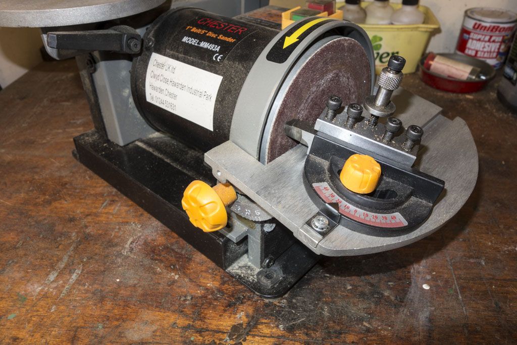

                #249697
                NJH
                  @njh
                  I find this little sander useful to just touch up a tool from time to time. With the QCTP it takes only a few seconds to do.sharpening.jpg
                  Norman

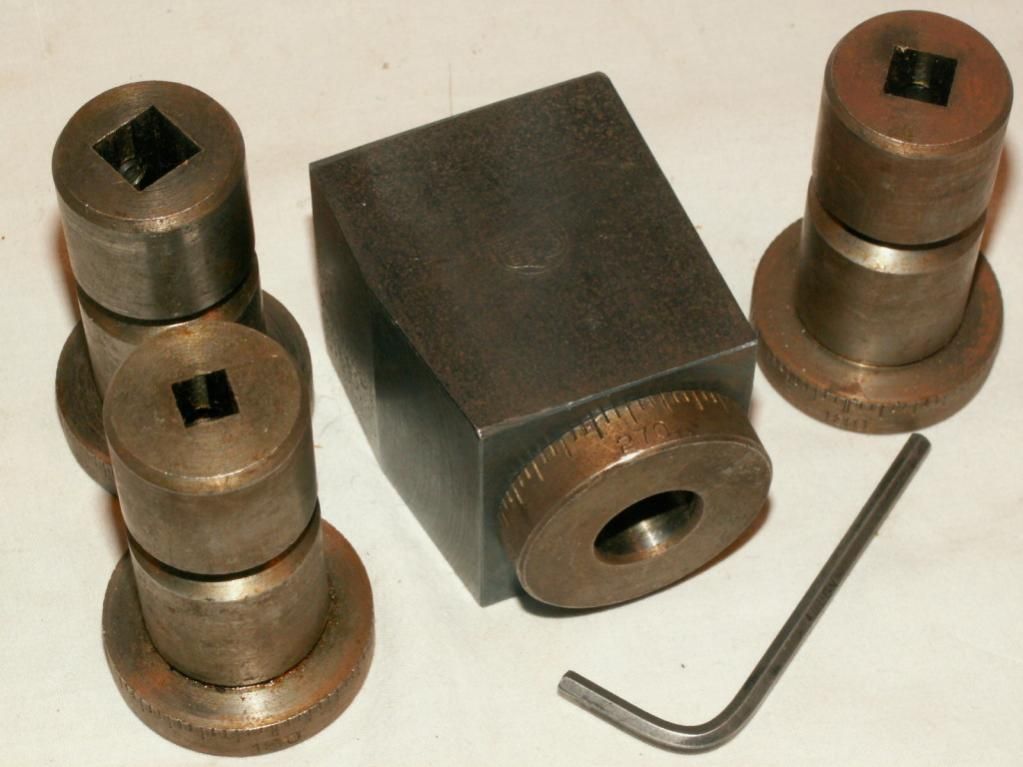

                            #279851
                            mark smith 20
                              @marksmith20
                              Posted by Speedy Builder5 on 24/01/2017 09:20:58:
                              I came across this Southbend link which may be of interest to some of you. Just bear in mind that some of the HSS tool holders present the tool at a fixed rake angle.
                              **LINK**
                              BobH
                              Southbend bend made a useful tool bit grinding jig block ,which could probably be easily made, square broached holes in the collets would be the most difficult part.But it can be used with a normal swivelling grinder rest.

                                not done it yet
                                  @notdoneityet
                                  Check out u-toob by clickspring, where he demonstrates making square broaches look so easy.

                                        Now that is very neat and very simple. I like it. A bonus is you're not getting hot fingers…

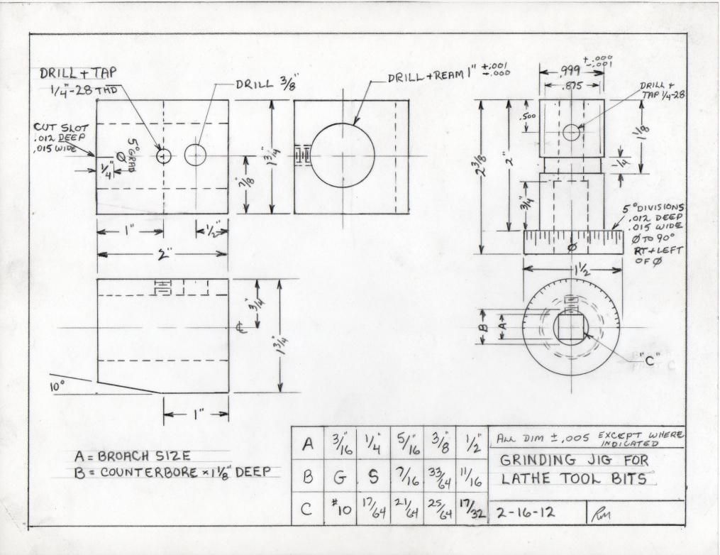

                                          #280755
                                          mark smith 20
                                            @marksmith20
                                            Posted by thaiguzzi on 28/01/2017 06:33:16:
                                            Posted by mark smith 20 on 24/01/2017 10:48:32:
                                            **LINK**
                                            BobH
                                            Heres someones drawing for it.
