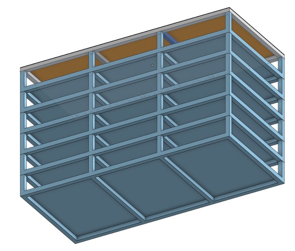

      Good afternoon all,
      Now Everything is all tidy in the workshop and I have composed the start of the Workshop Wishlist, I have been looking at how to prioritise that list.
      Naturally, I would love to go out and get a beg lathe and just bang it in to place. The sad reality is I don't have the luxury of space to do that. So how do I solve that problem, A-frame and a chain winch, perfect. I'm height limited though, nothing available to suit the purpose.
      That's okay, I want to call myself an engineer I can make one, So I continue to put together a pencil drawing together on how I could make a strong looking A-frame for lifting and moving heavy stuff. One issue, I can't weld and I don't own a welder…..
      So how do I fix that problem? Buying a welder and learning how to weld? how to learn how to weld? practice with a lot of welding. Got it.
      Did a bit of research online and quickly settled on Flux core welding as my best and cheapest option for my dalliance into welding. I could buy a MIG welder and just run it gasless (and polarity switched).
      So here is the MIG Welder I am looking at. What are peoples thoughts on that? could I do better or worse? what are my options, I figure in terms of welding mask, I need an auto darkening one so haven't really delved in to that market yet.
      Next I need to practice welding, so how am I going to do that? I could just get two bits of steel and have at it. OR I could buy a shed load more steel and make a thing with it too. Great idea!!
      The what to make was an easy decision, it is something I need doing and can easily be done with plenty and plenty of welds. The Over-Engineered Workshop Drawer System!.
      Its basically 20mm steel tube welded together with a thin aluminium sheet rivetted across each layer, between the sheet and the tube will be rubberized tape to take up vibrations and rattling. Sprayed blue and filled with three columns of six rows of Gratnell Shallow Trays
      Over-Engineered. Could easily be done with wood or with Ali, Plastic etc. But I would learn any new important life skills with those!

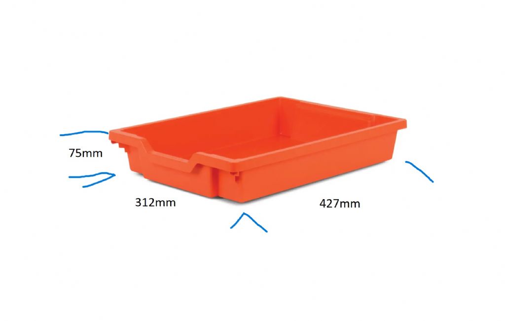

      So I started with the Trays themselves…

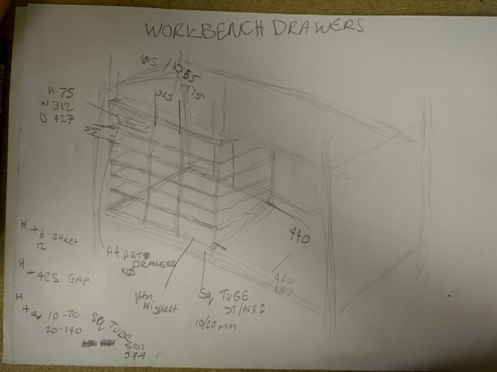

      Easy enough. Lets get doodling based on that….
      Okay, If my math is correct, I should have something that works. I'm going to learn another skill tonight! I'm going to try and learn how to use CAD…..

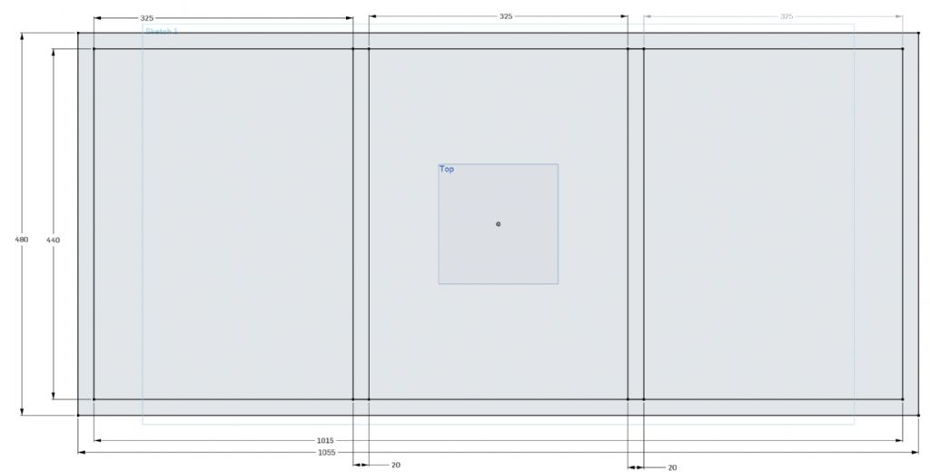

      Now. I had a google for free CAD software and after a little while I settled with onshape. I haven't used it or any other CAD software before but I did watch a ton of hours watching solidworks videos with the intention of using solid works. luckily that was kind of enough to be dangerous here. AS you can see the top view of the shelf dimensions, that will also form the base and the top.

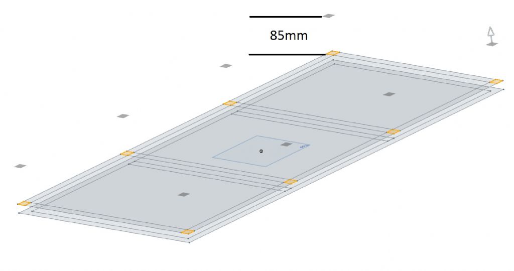

      Next I figured how to extrude some struts 85mm high….
      This formed the basis of my repeatable shelf pattern What I haven't shown is that I made another extrusion after this one for the ali sheet and didn't extrude where these struts are, so the ali shelf can just slot in from top down, for each level.

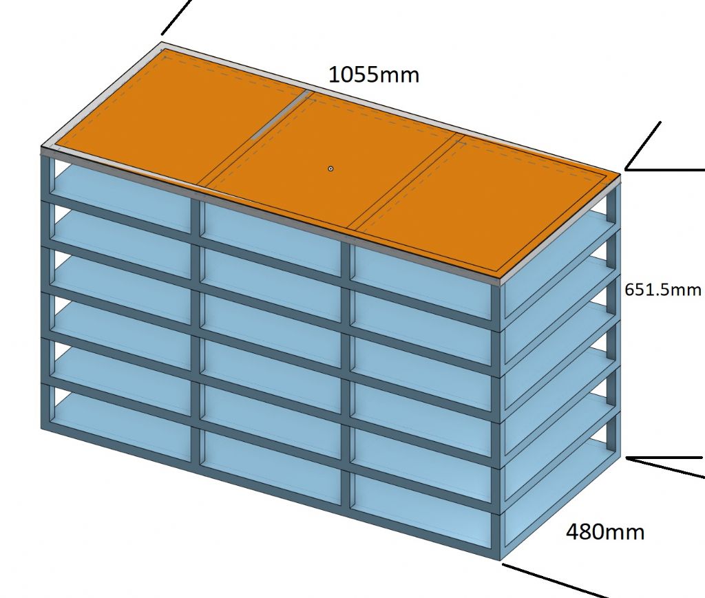

      Wit these extrusions I duplicated the part a bunch and transformed their positions atop each other and remade an extrusion for the top panel as it was easier than figuring out how to do it any other way. Not bad for my first couple of hours in free CAD software…. I quite enjoyed it…

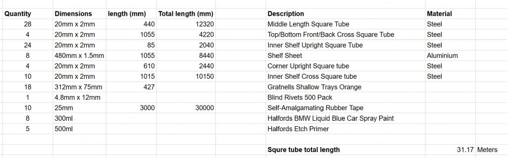

      I was also able to create a materials list for the job (I don't know if you can do this in CAD)
      Remember. This is totally over-engineered by design. The core goal here is an opportunity to get comfortable with welding and fabrication in general.

          That said, I am open to using different types of steel etc. The ali is there to stop the trays from falling through levels and i ordered an extra ali shelf so I can rivet 25mm strips down each side of each shelf to keep the trays running in their lane.
          If this project can keep drawers up with weight in, then i should be okay to do the A frame….

            I would not bother with all that sheet and rubber. Fit some bar or tube front to back that the side lips of the trays can run on. You also gain extra storage capacity for each tray as there are no tubes across the tops which also stops stuff getting stuck against the tubes.
            Or just get three second hand Bisley draw units and build a frame to take those. If you go for one each of 1", 2" and 3" draw heights the smallest will do for cutters, taps & dies etc. Meduim for collets and small tooling, largest for what's left. You also get a closed front so your draws don't fill with swarf and cast iron dust like open trays will.

                belgium 11 2022 336.jpgI would not try to learn to weld using a cheap gas less unit. MIG if you wish, use CO2 from the local pub and .6 wire. As for 200/250A why stop there go for a 375A unit. You will NOT get 200A from a 13A plug, it will need about 21A. With small stick inverters quite cheap,120/160A, that and 2mm rods will teach you what to look for and if poor it will look it. Read up and pay special attention to the weld pool, this will show how your doing. Look at the weld as it cools, if there are bright spots you have inclusions of slag. If you blow holes turn the power UP, the metal will flow and you move on, if the power is not high enough you will dwell on the spot, there will be to much heat and – a hole ! An auto darkening helmet is good as your learning and will save you from the VERY PAINFUL condition as arc eye. If your an inteligent man you will only ever suffer from this once !
                MIG welding in untrailed hands is VERY dangerous if a load bearing member. The picture shows a  trailer susspension mounting plate ! Only 6 hours after it was fitted it failed, causing a road accident, as the suspention,hub, wheel and tyre came off ! As can be seen there is almost NO penetration, the weld bead just sitting on top of the mill scale, though LOOKING OK. This was a commercially made unit,  though some  staff plainly couldn't weld. Now you see the reason for my first sentence !

                    That's a lot of expensive material and time just to build some basic, open shelves. Save yourself the hassle and enrol on a short welding course. If you must build something, make a bench: four legs and two rectangles with ply coverings will give enough practice of welding stuff together that stays straight/square(not as easy as it sounds, and your shelf design will be tricky to manage that) and be properly useful. An important engineering skill is to not make things more complicated than is absolutely necessary. Important, and hard to learn!
                    I wouldn't consider a gasless MIG either; use a proper one, or a cheap inverter stick machine. That one you've shown looks a bit underpowered/expensive too LINK

                        IF you wish to learn to weld then 20mm tube is not the place to start ! Buy a GOOD secondhand MIG machine and use CO2 – many will say it will not be good but for 25 years it was all I used and got good results on thin material as a job of work ! 0.6mm wire for thin material, not 0.8mm. Cheap migs have very poor wire feed units, bad if your skilled and almost impossible to use if learning. How do I know ? I was lucky, I started with a BOC Autolynx, one of the best smallish migs ever made (£750, in 1975) and have 2 cheap migs in the shed, both given to me by people who could not use them, I can't say I had much success either. I still have the Autolynx !
                        IF you really want to learn to weld then visit a local fabricator and get an assortment of off cuts in varring thicknesses and buy the best machine you can afford. It will take quite a while to learn !

                          Yeah I also think thats a bit of a crazy design and having done a fair bit of mig welding I think after an hour you'll be wondering why on earth did you start that. Also if you don't as you say have the luxury of space I certainly wouldn't be filling it with shallow drawers. Things like angle plates vices rotary table won't be able to go in those drawers. I would have a third of that as shelves behind a door. But it's your workshop and your time. Also I was wondering why you need a hoist to move a lathe. If you get a myford two of you can lift it. If you get so.ething like a harrison colchester they come on a base and ca be moved by one person with a couple of broom handles and a crow bar.

                              That is basically the definition of over-engineered isn't it Nick? Also likely the a close definition of madness too.
                              I wont lie, I am pretty dam settled on the idea of the drawers (they are a lot more useful to me than a bench and are designed for specific location in my workshop .
                              With that said, I was already intending to do a bunch of practice welding before I started on the drawers. What i never considered was the different thicknesses and angles etc. this is food for thought.
                              I have been struggling to track down any engineering tuition let alone tuition for welding.
                              I will have to get a 16A or higher, loop put into my workshop. I may as well couple this up with getting the 3 phase put in at the same time. But if I am getting 3 phase why don't i skip the 16A loop and just get a 3 phase welder in the future?!
                              As for needing a hoist, I have been put off from getting a Myford (wasn't hard to be put off my mind wasn't really in to them in the first place). Instead I am leaning back towards my original choice….

                                There's no way I'd have a rack of open trays in a workshop where material is being cut, ground, machined, welded painted or even assembled. Why not make the slides for your trays out of angle instead of tube? You'll get the same amount of welding practice, but the finished item will work better.

                                                  Rooossone, accepting your comment about over-engineering, you may be aware that gratnell trays are generally supported on thin steel runners (about 1.1mm including paint), bent to an L shape, with tabs that locate in slots in the square steel tube. I can vouch that these thin supports can carry a significant load. If you could cope with bending thin gauge steel, you would still get plenty of welding practice.
                                                  Unfortunately, these only provide a side view, so the detaiils are not available.The 'joggled' tabs project sideways from the image:
                                                  Gratnell tray steel runners
                                                  This video shows the square U-shaped section that the tray slide in, the metal ones operate in the same way.
                                                  Plastic runners
                                                  Bill
                                                  #646938
                                                    Interesting Bill, I'd not actually seen the trays before but that is how I suggested they be supported in the first reply. Even if the OP's frame were not slotted the runner material could be screwed on which would allow for some easy adjustment of spacing if a row of holes were drilled in the uprights.
                                                    Even if all welding the "open" front that the side runners give means that each end and divider could be welded up on a flat surface making it a lot easier to keep things true and then you only need to weld on the two top and bottom rains that run full width. Bit of bracing at the back and the job is done.
                                                    #646947
