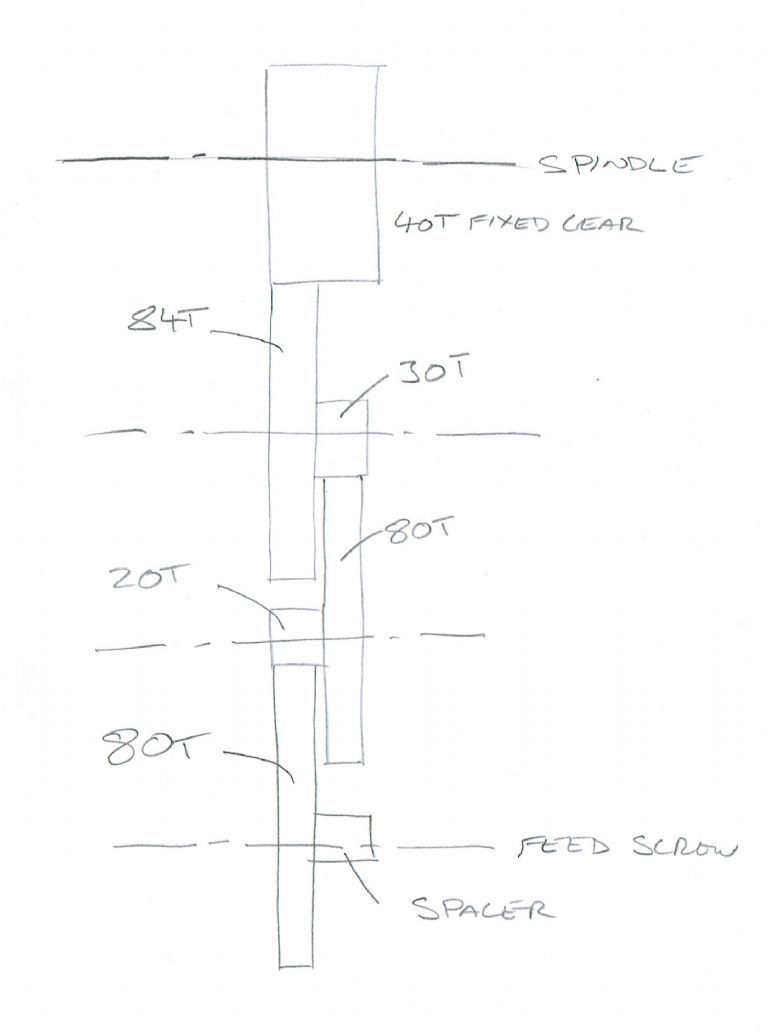

                  #144914
                    Dave if you take the end cover off the lathe and then look at the gears from the front you will need to swap some about so that they look like this.
                    The fixed 40T on the spindle drives an 84T which has a 30T on the same stub. That 30T drives an 80T which has a 20T on thesame stub and finally that 20T drives another 80T on the feed screw, you will also need to add a spacer to keep the 80T gear to the left, spacers are shown as "H" on the charts
                    Its quite likely that the lathe came to you with the mid range 0.138mm feed set up so you will only need to change the 33T for a 20T
                    J
                    Edited By JasonB on 24/02/2014 10:19:26
