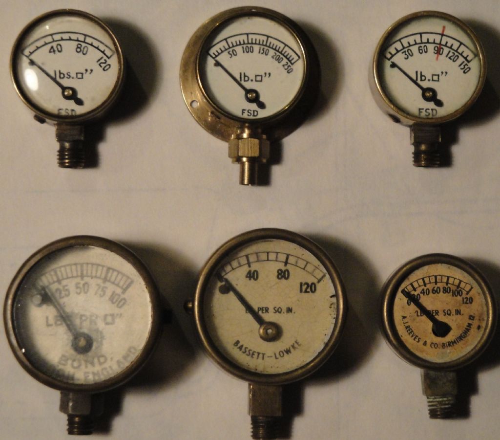

                                            julian atkins
                                              @julianatkins58923
                                              Here are top row 3 FSD (Freddie Dinnis) miniature gauges of 3/4" dia. The first is an early example with curved glass and dates from circa 1970.
                                              Below 3 knackered old gauges with corroded brass bourdon tubes.
                                              Cheers,
                                              Julian
                                              #268711
                                                Posted by julian atkins on 27/11/2016 22:38:34:
                                                Known to his friends as Full Scale Deflection ?
                                                [sorry, couldn't resist that one]
                                                #268716
                                                julian atkins
                                                  @julianatkins58923
                                                  Hi Michael,
                                                  FSD = Frederick Samuel Dinnis, born 1st October 1903, died 18th July 1989.
                                                  The address in Ward Avenue Cowes was a very nice detached house though bombed out in WW2. That address will be be very well known to older model engineers of the loco fraternity.
                                                  Cheers,
                                                  Julian
