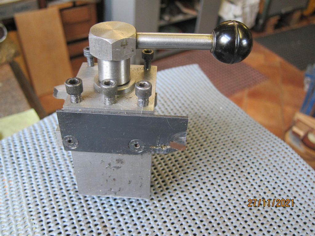

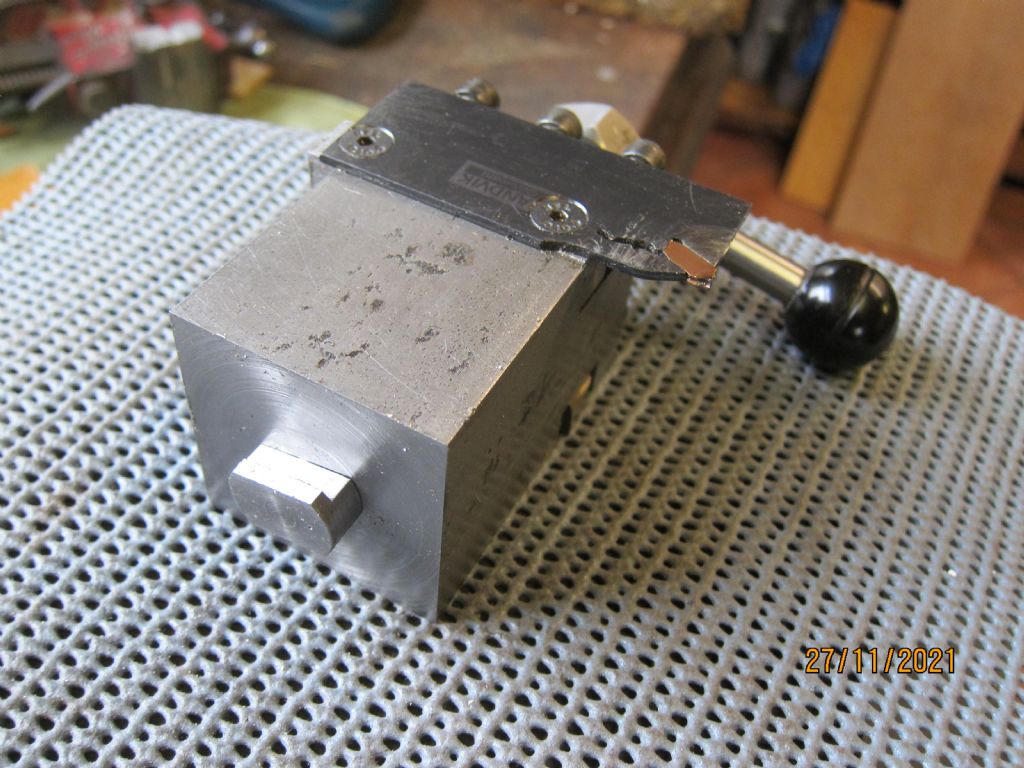

                        A couple of pics showing the rear toolpost holder

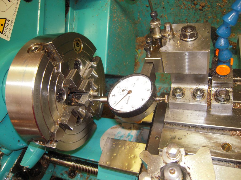

                                I don't like the idea of a single bolt fixing. I think it would be done up quite tight to prevent the post turning during use. I am very aware of this on my set-up.
                                Is the base of your tool post and surface of the cross slide truely flat? If not the slide would distort when the tool post bolt is tightened. The fact that the problem occurs when mounted in the end slot, where the slide is less rigid, would suggest this is happening.
                                My set-up, shown, is left on the lathe unless I have to take it off.Rear tool post.jpg
                                JA
