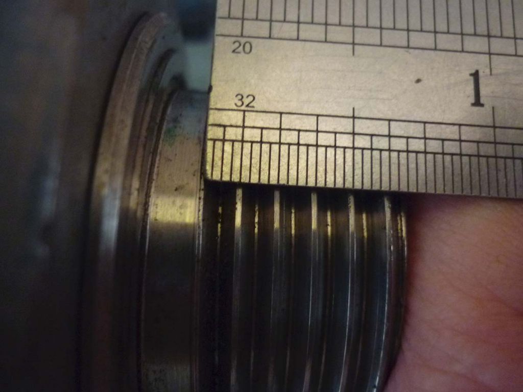

              sean logie
                @seanlogie69385
                Mark,I’ve added a photo of the gauge on the thread . Not sure how I tell what angle the thread pitch is .
                Sean

                    Mark I’ve just checked and it is a BSW gauge. Would the flatness not be ware and tear . The gauge seems a tight fit . And the backplate won’t fit in the chuck with the boss facing out ,so I’m not sure how I’m going to make the register .

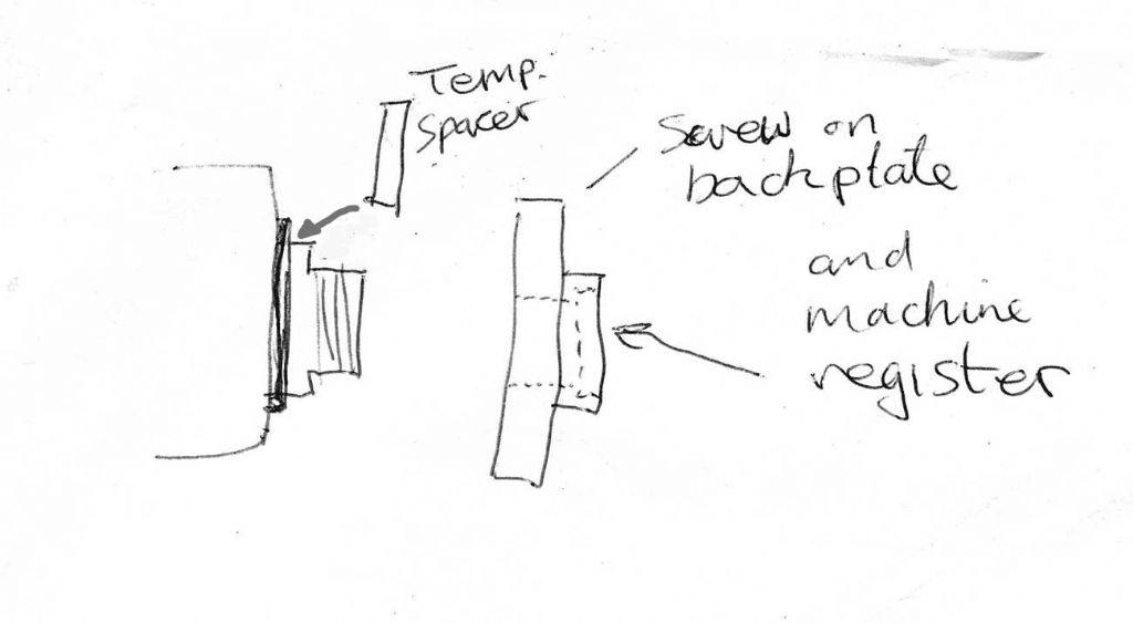

                    mark smith 20
                      @marksmith20
                      If you plan on threading the back plate you can hold the back plate by the boss and bore out to the correct diameter ie. 39mm or 1 17/32".
                      Then you thread the hole for 1 3/4" x 8 whitworth right through the back plate.(making sure the thread tool can do this without hitting the chuck.
                      Once youve done this you mount the back plate directly on the spindle with the boss facing you. But using a temporary spacer (a piece of pipe or something just slightly bigger than register diameter and of the right depth minimum 0.17"  according to your measurements ) between the register and the back plate ,so that the boss side is clearing the spindle nose end..
                      This will allow you to machine /bore out the short area for the register, which you can keep taking off turnng around and checking until you get it right and its seating properly on the spindle register.
                      Once you have the back plate on the spindle you can then go about truing up the surfaces ,turning the chuck register and doing the mounting holes etc..

                        Thanks guys ,I’ll pluck up the courage and do it in the 2 wks I’m off at Xmas . Been testing the run out at max distance betwwen tailstock and chuck . My gauge is telling me .05 mm over 45mm .

                        #272626
                          Sean,
                          I don't think I would be happy with this as an example of thread-pitch gauging … there is a lot of daylight showing.
                          … Have you checked the gauges ?
                          P.S. … That first character looks remarkably like a 7 to me.

                            Sean & Mark, I hope I'm not muddying the waters here, but I've just checked both my sets of BSW thread gauges; first set only has the TPI marked on the blades and is stamped "7G", the other, like Sean's is stamped 7G 11/8" 11/4" but these diameters only refer to BSW threads, so don't be misled
                            N.B. The thread gauges are marked up as BSW, though they can be used for BSF, as they are the same thread form i.e.55 degree, rounded crests etc. just different TPI
                            This tallies with my thread tables as 7TPI for both these two BSW threads (11/8" & 1/14" ), on a normal standard nut and bolt, so I'd suggest that the lathe nose is actually 7 TPI not 8 TPI
                            In your case you seen to have a 13/4" lathe nose with 7TPI. This would equate to 13/4" BSF
                            The actual thread measurement for BSW/BSF will always be smaller than the actual thread nominal OD size as the thread form has rounded peaks.
                            Ergo, you seem to need a backing plate with a 13/4" 7TPI BSF thread form, with an appropriate register diameter to suit your lathe.
                            It does strike me a little odd that you've measured/shown 1.8" register and 1.7" thread diameter on your sketch. I'd have expected the thread to be slightly smaller to allow for the rounded crests (@ 1.6585" )and the register to be almost bang on 1.75" Are you sure your measuring equipment isn't about 50 thou over reading?
                            I think Michael & I  were typing posts at the same time, but I got delayed part way through.
                            I wonder if the daylight is just due to half a century of wear on the thrust side of the thread on the nose? It won't make any difference to the accuracy of the chuck Sean, as it's the register which positions it; the thread is just to keep it there, but it might explain why you could partially engage what is effectively a 8TPI nut on an 7 TPI bolt.
                            Could it be the thread binding up, and not the register being the wrong diameter?
                            P.S. I'm not trying to teach anyone to suck eggs here.

                                What you are looking at is a set of Unified Thread Gauges and not whit.
                                7 TPI covers 1 1/8 and 1 1/4" and thread angle as you know is different to Whit at 60 vs 55 deg
                                You need to re-gauge with Whit gauges

                                  Maybe, but my own thread gauges are certainly stamped up as BSW and have a blade engraved as 7G 11/8" 11/4"
                                  Regardless, I'm still not convinced of the need to re-gauge anything as 7TPI is still 7TPI whether it be Unified or British Imperial.
                                  I guess the lathe nose could be UNC thread form, but I'll still have a punt at 13/4" BSF, even though it did originate from Clausing in America.
                                  Maybe look for a 1/2" thread somewhere else on the lathe and see if it's 12/16 TPI (BSW/BSF) or 13/20 TPI(UNC/UNF) , though of course it wouldn't definitively point to a 60 degree thread on a different bit of the machine.

                                    Well I tried cutting a 8tpi and it doesn't marry in with the gauge . I bought the gauges off eBay , I check my purchase history and the description says BSW & metric . . I'll try a 7tpi tomorrow and see . I only have a cheap calliper set but they seem to be ok ,I've check them against a Brown & Sharp micrometer .

                                        Sean, Apolgies as I think i have them reversed. My M & W gauges show same as yours so when i put them together i get similar gapping error to your photo which looks as though you may have a unified thread at 7 tpi. Will try another post with pic of both if i can get it to download OK

                                                It's hard to tell from the photo of your gauge on the nose thread; you would be able to see better in the flest, so to speak. It looks to me a bit like the thread fits the gauge better on the tailstock side of each thread buttress than on the headstock side. I wonder if that's due to wear on the side which carries the force when the chuck is tightened against the spindle. If it fits one side better than the other, and is a good fit on that side with a BSW gauge, I'd suggest that the included angle of the thread, when it was originally cut, was 55 degrees. It's now worn, mainly on one side, so it appears to be even steeper on one side, hence the air gap.
                                                To be honest, since the thread is worn anyway, I can't see it making that much difference if the internal thread on your backplate is 55 or 60 degrees, it's only there to hold the chuck in place. The important thing is the correct TPI and register diameter.

                                                  Im glad some others have piped up, i admit i was totally confused by Seans threadgauge which is why i asked if he was sure it was 8 tpi, and requested a photo with a ruler over the crests (i thought it looked like a BSW pipe thread gauge, especially with the G)
                                                  So Sean you need to make sure you have the TPI correct before you proceed, then try and figure the thread angle ,if it is BSW.smiley
