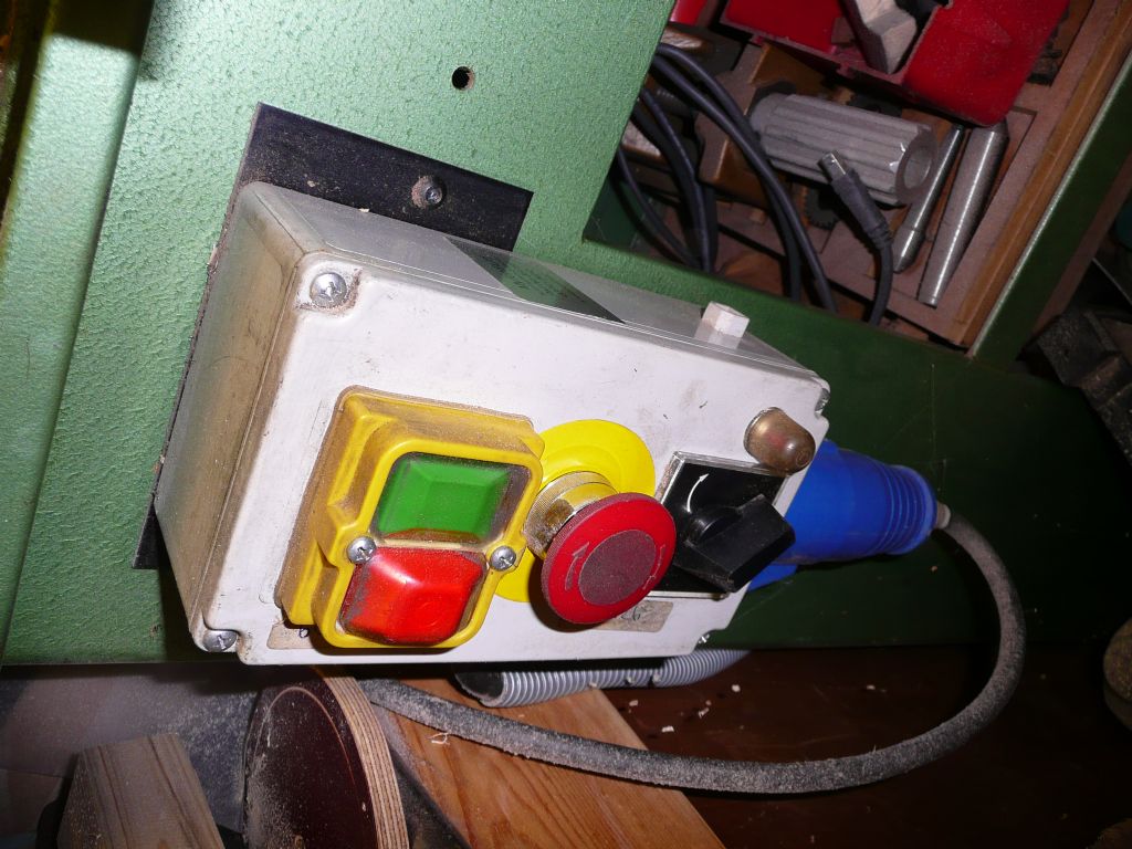

                    Clive Hartland
                      @clivehartland94829
                      Here is a pic. of my ML10’s power switching. The Myford part number is:- 85766
                      Edited By Clive Hartland on 19/11/2011 15:45:18
