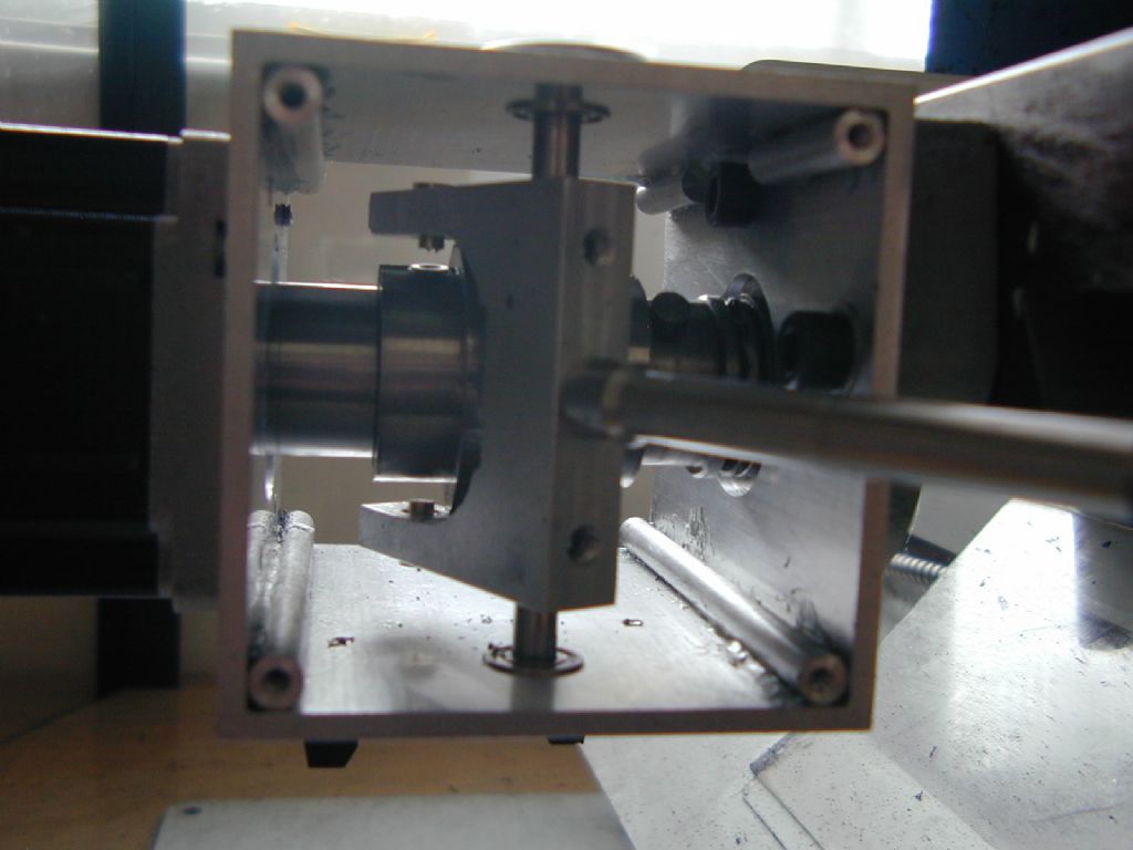

                      I used a 24V window winder from a surplus shop and a variable 0-30V PSU similar to this. Together with a simple changeover switch (DPDT) this allows variable speed in both directions.
                      3A at 24V is about 75W ie plenty of power for a mill/drill. Not sure what you'd do with 20A (almost 2/3 HP!!).
                      I couldn't be bothered to come up with anything fancy like a clutch, so instead I used a wingnut to enable me to fit or remove the thing quickly – takes seconds. As it already has a sort of dog clutch connection between the handwheel and the leadscrew, this is a simple and effective solution.
                      Funny this should come up. Although I no longer have the machine, I came across it yesterday when moving stuff about.
                      Photos in my album here.
