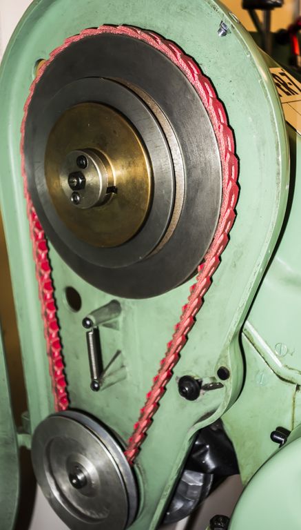

            I 'm just wondering why you are seeking to change to poly V ?
            If it is to obtain smoother running then have you investigated link belts? My S7 was rough and noisy in the high speed range so I replaced the primary belt with a link type. Super smooth and quiet at all speeds now. The secondary drive belt is still a traditional 'V' type at present but that too will be changed for the link type when the time comes.
            The belt is shown here
            Cheers
            Norman

              Hi Steve I have not done the myford conversion but have done the poly belt conversion on the Warco VMC milling machine using aluminium for the pullies and have had no problems at all . MIKE SANSOM

                                                      You can get greater speed ratio's with Poly vee belts in places where space is limited because the smaller pulley can be a lot smaller than the one needed for a v belt or even a link belt.
                                                      On small pulleys with a vee belt you get a lot of non contact. Link belts don't suffer as much but are placed in a situation where wear on the pins takes place leading to premature failure.
