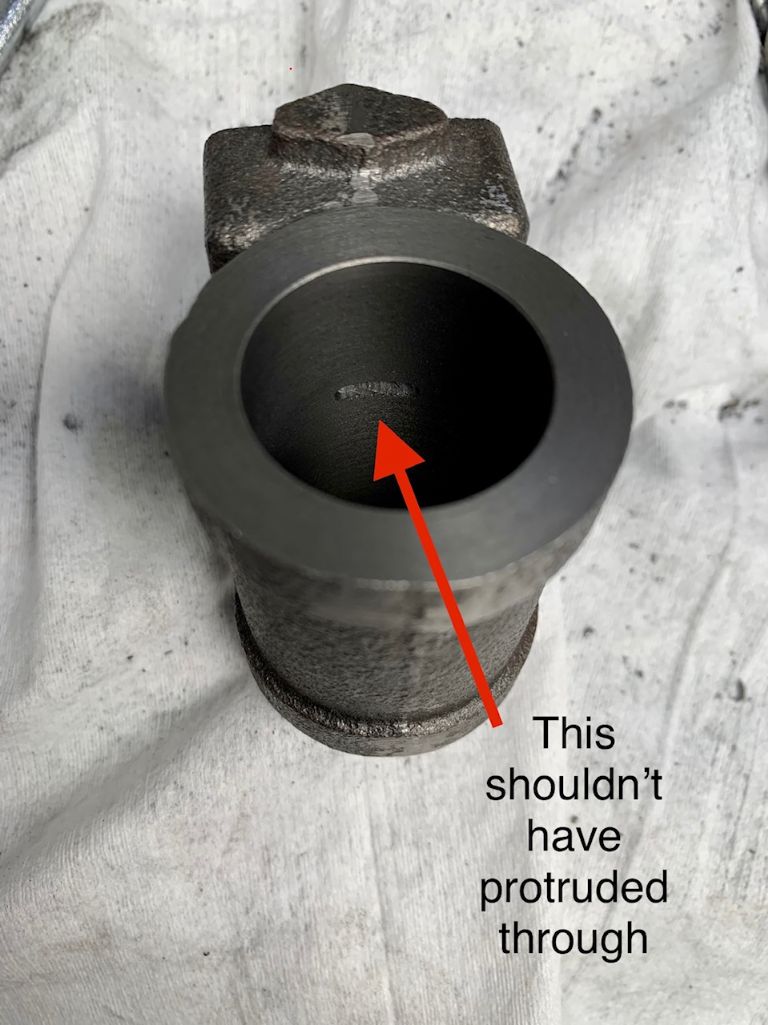

I think I might have "bricked" my little cylinder for my model PM Research #1

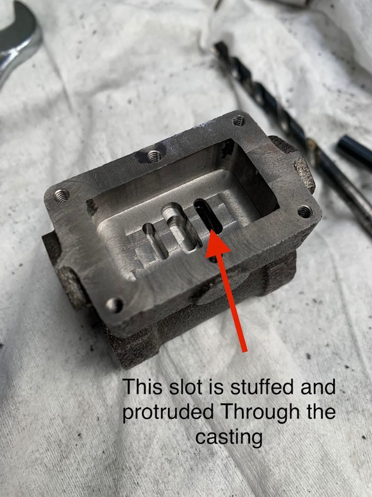

I was milling the small steam valve slots in the cylinder chest, basically blind milling due to the tight conditions, I was using my DRO as my reference, old rookie mistake, the cutter was not tight enough in the collet and it walked its way out making the slot to wide and protruded through into the cylinder bore,
My Question can it be saved?
I was thinking
JB weld?
Silver Solder?
Scrap bin?
any suggestions would be greatly appreciated
