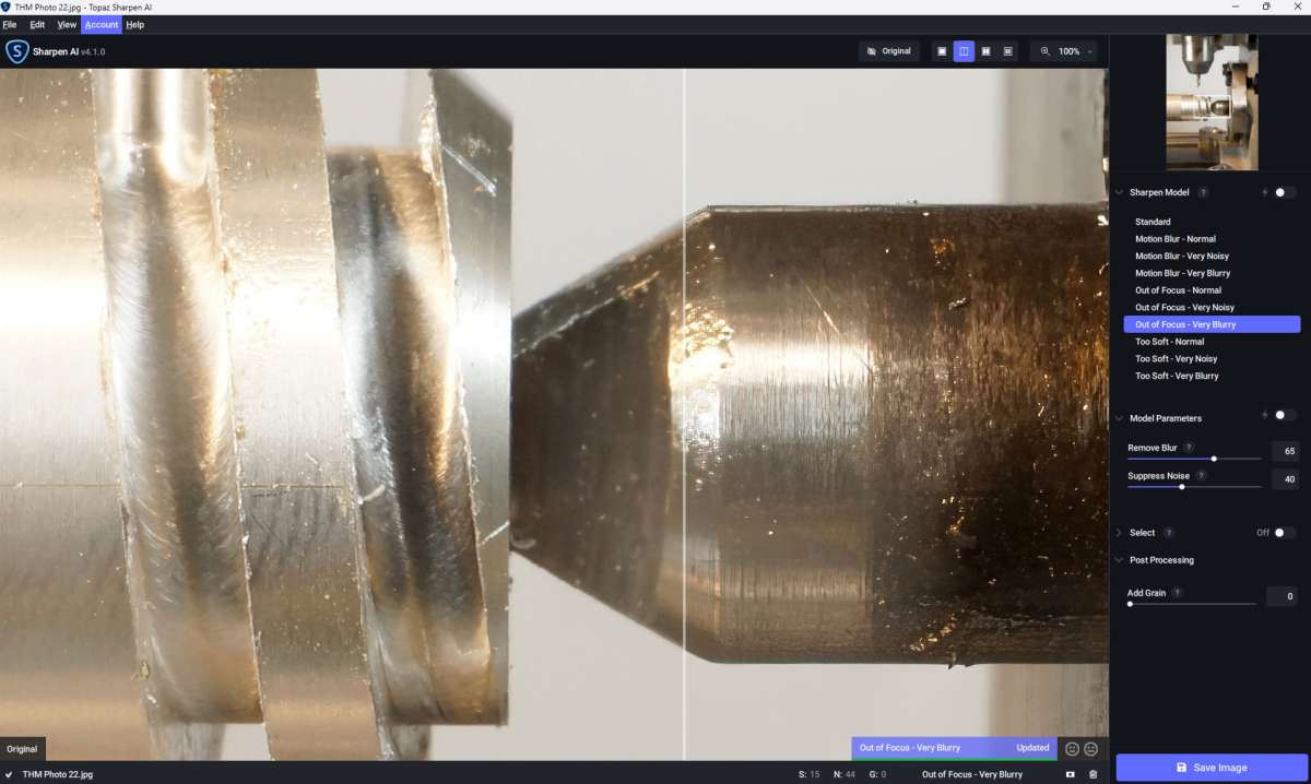

                                        Hope Bob Reeve won’t mind me saying, but depth of field issues meant that a photo for his ‘Thread Milling’ article was OK for a small image in the article, but not sharp enough to be a cover, although it was a good illustration of an interesting machining operation.
                                        This is what Topaz Sharpen AI achieved; not that the ‘AI’ component automatically adjusts the degree of sharpening across the image, identifying the subject and not over-sharpening parts already in focus. I’ve moved the comparison slider so you get a better comparison:
