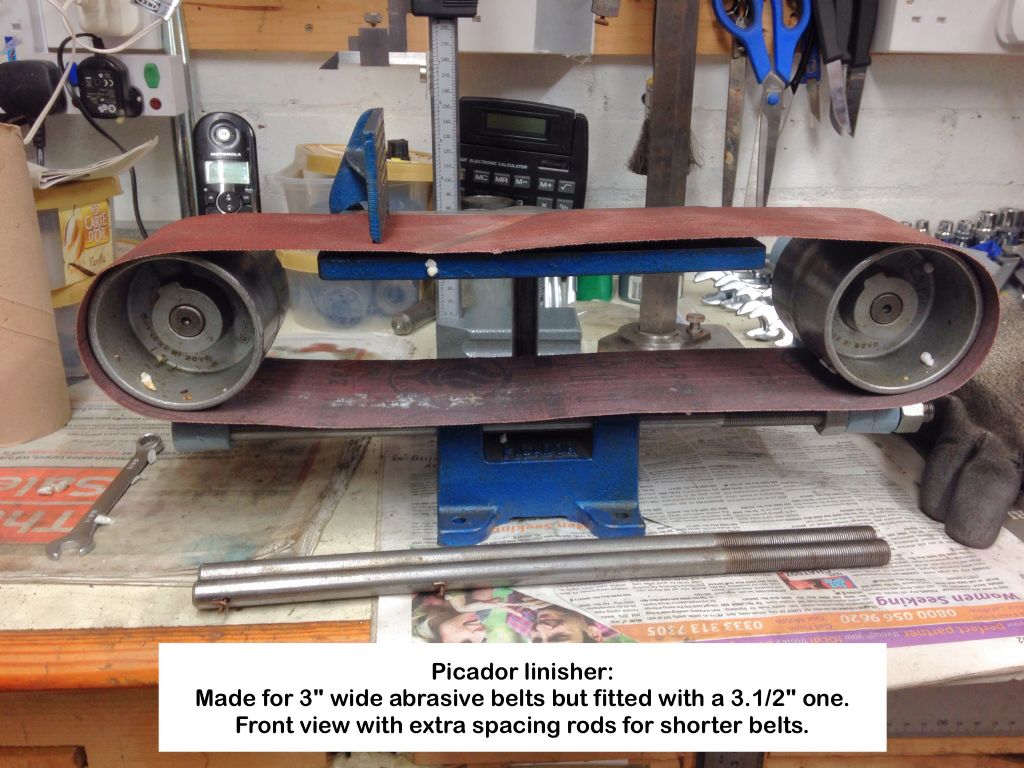

        This is one of the items I had completely forgotten about, and found whilst searching the shed this week.
        To say I was pleasantly surprised is an understatement.
        I bought it in 2004/5, then boxed it up pending a move that fate decreed would not take place.
        Then all the episodes I've already posted about.
        Now I need to make a stand for it, no problem, and provide a motor.
        What size motor would I need please?
        I read somewhere that one of the best ways to use such a machine is with it mounted horizontally, belt vertical with a guide table along its length thus making it easy to keep the item being ground at 90° to the belt.
        Nice idea, but what do you all think?

          Geoff, I think about a I/2hp 1450 rpm motor would do fine, if it were bigger it would not matter, smaller it would work but take time so as not to over load it.

            I would be inclined to leave with the belt horizontal and at the end of a bench so you can use the curved end for concave parts, you still have a fence you can set at 90 degrees.
            As for motor 1/2 hp may be a tad small as my belt sander (wood) is 950w variable speed and runs at a higher speed, may be larger motor with speed control, slow speed for finishing and higher for material removal.

              I bought a fairly nasty Chinese-made 4" belt sander last year for peanuts and it is fitted with an alleged 1/2 hp motor. I wouldn't go much lower in power regardless of the belt width, as you can take a fair cut with a new belt and this can be helpful if you are rounding parts off. The main problem is the heat build-up in the part. You need gloves and a water container to keep dunking it in, rather like when you are grinding tool bits.
              Mine has one of those belts that can be tipped vertically. I find both positions useful. Dead handy tool!

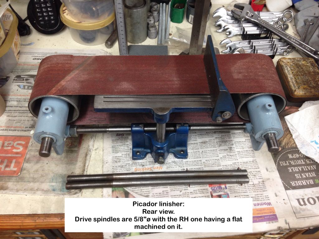

                    Any suggestions on pulley size/s?
                    Forfar to mention the shafts are 5/8"ø
                    Whilst reading Vol.XLV of 'Ours' I came up with a 'Cunning plan' for mounting it that will need serious investigation, as it will be perfect, IF it works.

                      Don't know about pulley size, but a mate who I do work for has one mounted on a 8"/200 mm bench grinder, it's directly driven at 2800 rpm, it removes metal at a great rate, and seems fairly economical on belts. The driven roller must be about 100 mm dia.

                          Much depends on what you plan to use it for Geoff. I have a record power belt and disc sander that I use for tool sharpening. I split 6" wide belts into three for the auxiliary platten I made for mine. I also made an adjustable table as well. It's normally locked in the vertical position for use. Photos if you need them to get an idea. A 3/4 to 1hp should do it.

                                        Mine seemed quite happy running off a 1/3 rd HP, 1440 rpm "square" Hoover motor. M section pulleys were in the 2 1/2 to 3 1/2 size range and gearing either 1:1 or up a little bit with the whole number pulley on the machine and the + 1/2" on the motor. Used what I had and, after 40 ish, years no chance of exact recall. Was advised to put the drive pulley at the opposite end to the motor so a relatively long belt was needed. Having over the years since seen considerable grief caused by eyeball engineered very short pulley centres and correspondingly titchy drive belts I figure the advice was good.
                                        Cast in plain bearings and running spindles were well worn and very oval when I got it. Four top hat oilite bushes out of a bag of 50 from one of Friend Whistons Cat-a-Log mystery box specials plus a couple of nice ground round stock short ends from the main workshop scrap bin soon sorted that. Whist I was at it I fitted proper capped oilers (spares for top of chaincase on Suffolk Colt / Punch mowers) and made some longer bars to take a standard length abrasive belt. The centre boss and fixing screw on my belt drums was offset to one side. As obtained one side of the abrasive belt overhung the side of the table which looked far too much offset from the bearings which can't have helped wear rate. Flipping the belt drums on re-assembly bought them much further in partially overlapping the oil cups. Yup I know oilite isn't supposed to need lubrication but occasional anointment didn't seem to hurt.
                                        Pretty sure that it was run too fast by previous users which coupled with the excess offset made for rapid wear. I now have a Draper belt and disk sander, got when a need for a disk sander arose contemporaneously with an offer I couldn't refuse from a workmate, which runs at 2,800 rpm and you could easily persuade me that is too fast. Belt life seens shorter with no corresponding uplift in in material removal rate.
