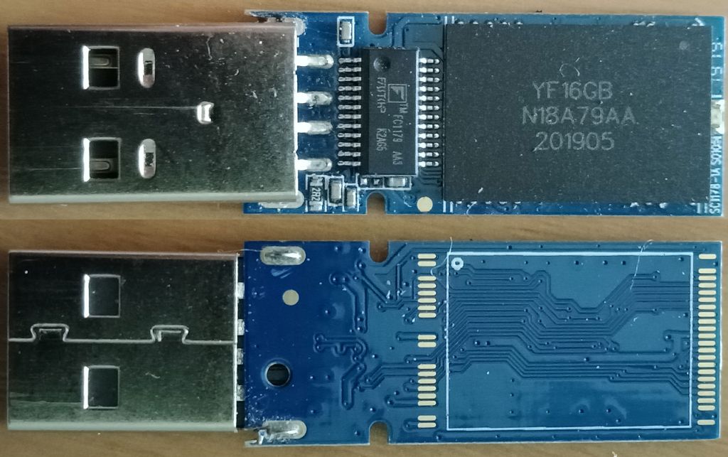

      A very helpful friend in the UK sent me a bundle of his workshop photographs on a PNY 16GB flash card.
      Although my PC says the card is OK; beeps when I insert the card into the USB socket; and the card’s LED flashes, nothing shows up in my MS Outlook 2010 file manager.
      I then checked with one of my own cards and that was fine.
      When I plugged the PNY card into my old (IBM ThinkPad) laptop the LED flashed as before but then reported …
      ‘A problem occurred during new hardware installation. Your new hardware might not work properly.’
      Returning the card to my PC produced the same results as above, i.e. it beeps and the LED flashes.
      Is there a simple solution?

                                  For clarification, here are a few more notes regarding the USB card and (I presume) its contents …
                                  • The images were taken in the UK and posted to me in Australia,
                                  • I have no idea what camera, computer, or software he used*,
                                  • My desktop PC runs Windows 7 Home Premium,
                                  • My old IBM ThinkPad laptop runs Windows XP Pro V 2002,
                                  It looks like incompatibility is high on the list Dave (SOD)!?
                                  I had noticed that the USB plug wobbled relative to the black injection moulded body of the device. It had spent 26 days in the postal system, which raised a couple of questions …
                                  • Was the device damaged physically?
                                  • Was there a broken connection?
                                  I decided to pull it apart, only to find it was intact. See this ‘top and bottom’ image.
                                  Holding the ‘skeleton’ by its PCB edges, I again plugged it into the PC (and the laptop). That was when the LED revealed itself, flashing in a typical pattern and then remaining lit.
                                  Plugging the device into both PC and laptop this morning showed the same symptoms, i.e. the rapid flashing lasts about five seconds when plugged into the PC, but only about one second when plugged into the laptop. The same (error) message appears briefly on the laptop.
                                  The LED, visible on the RH edge of the PCB (top image), didn’t show through the black moulded case. Now it does, through a 2mm hole I drilled in the case.
                                  *With such bad news about the CV19 spread, I’m worried that I still have had no response from my UK friend.
                                  Many thanks for your help so far.
                                  Sam
                                  PS Dropbox it'll be next timedevil

                                    #505580
                                      If the computer recognises it and lights flash the USB interface is OK.
                                      If you don't even get a 'repair disk' dialogue then it is either badly corrupted or maybe the ball grid array of connections under the memory chip has broken.
                                      It's very hard to lose data from USB devices by 'hot swapping' these days as Windows uses a process something like:
                                      Write new catalogue data but not marked as valid.
                                      Write data
                                      Make new catalogue data valid.
                                      If this process is interrupted it can stop the write from taking place successfully but it won't corrupt the storage, although the catalogue may need to be rebuilt.
