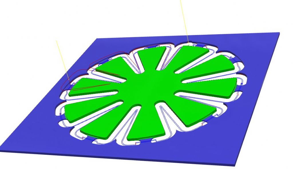

      Now my CNC has potential to work nicely I'm thinking about making things
      I will be making some small watch parts, mostly 2d in general shape. I think I can effectively cut these out of sheet stock, but what's the best way to fixture it?
      Additionally what do you do to prevent the part breaking out and jamming/snapping the end mill.
      For general size the would be parts that require 1mm or smaller endmilll to get into internal radiuses, and typically 1mm or so thick.
      I occurs to me that I could use (say) 1.5 mm gage plate,surface the top by 0.25, cut around the part leaving 0.25mm bottom stock. Then fill the "gutter" with shellac and flip over, probably on my surface grinder to remove the 0.25 left.
      Any better techniques?
      #15285
      Dave S
        @daves59043
        #483785
        Brian Oldford
          @brianoldford70365
          Use the third axis to leave a few small tabs to hold the piece in place.
          #483787
          blowlamp
            @blowlamp
            You could cut right through, but leave a few small & thin holding tabs to keep the part in place.
            The next stage would be to generate a toolpath that cuts away those tabs, but before running the code, apply some hot-melt glue in the already cut areas to provide support whilst the tabs are cut.
            So similar to you own idea except no need to grind the the other side to release the part.
            Martin.

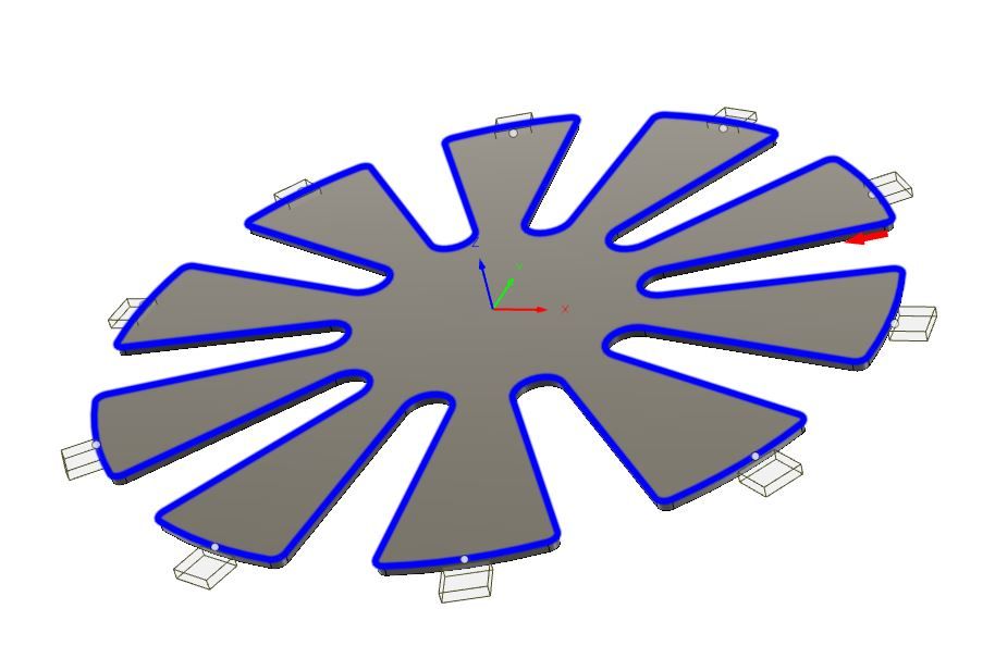

                As you are using Fusion that has the facility to add "tabs" to the contour cut, when setting up the contour geometry there is a box to click if you want tabs and that then allows you to enter length, thickness and positions.
                Tool will lift and drop as it goes around the work. Simply file off the thin tab when cleaning up the edges.
