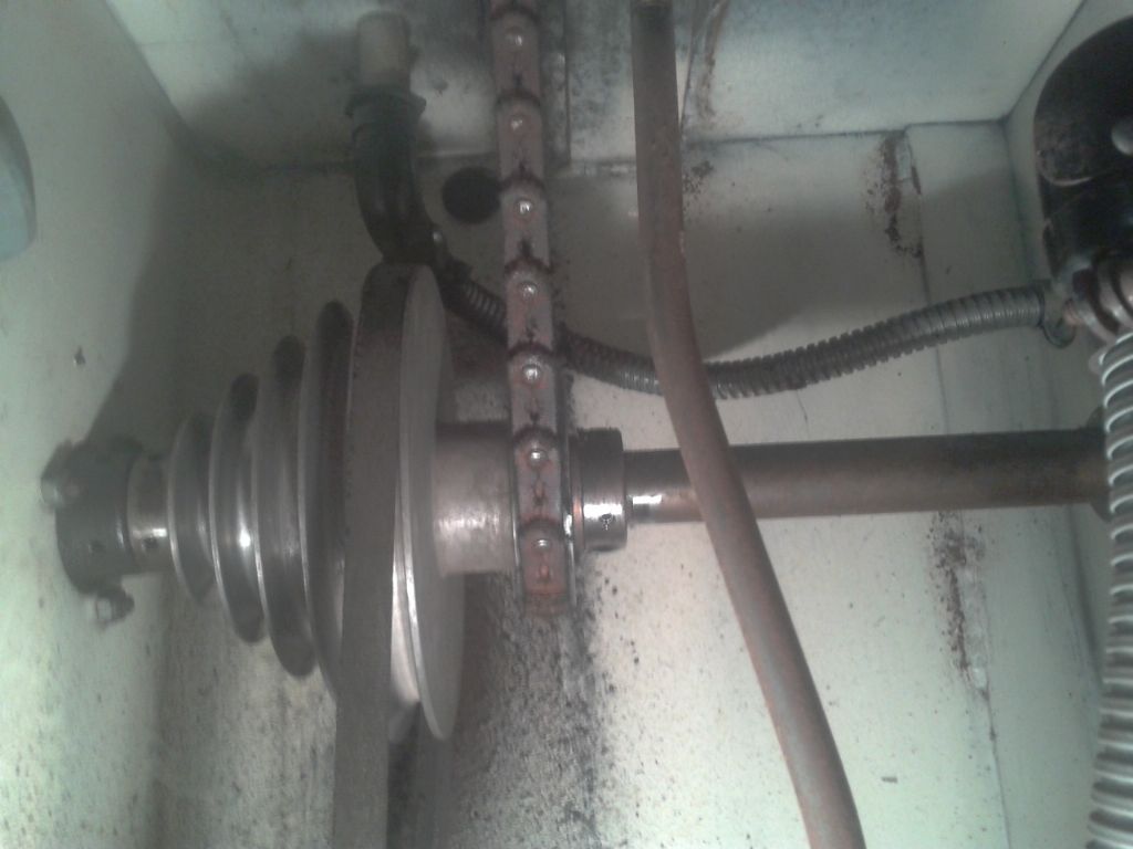

                  Can the original counter shaft arrangement be mounted underneath?
                  #607382
                  Nicholas Farr
                    @nicholasfarr14254
                    Hi Rich2502, you can have the countershaft wherever you like as long as the belt will allow. My Boxford underdrive has the countershaft in the cabinet directly below the lathe, but of course the lathe and cabinet was designed that way.
                    Regards Nick.
