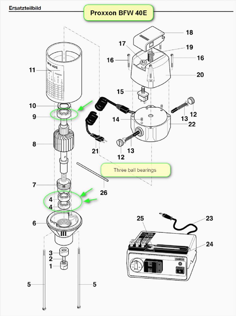

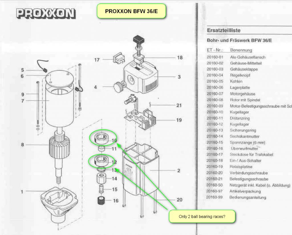

      Also from what I can see on these diagrams, the older BFW 36/E only seems to have two ball bearings units, whereas the newer BFW 40/E seems to have three – which would presumably make the latter much more durable when it comes to milling.
      Evidently one major difference between the Proxxon BFW36/E  and BFW40/E is that in the letter the control electronics are now built into the transformer box rather than being build into the unit itself, but I don't think I care about that…
