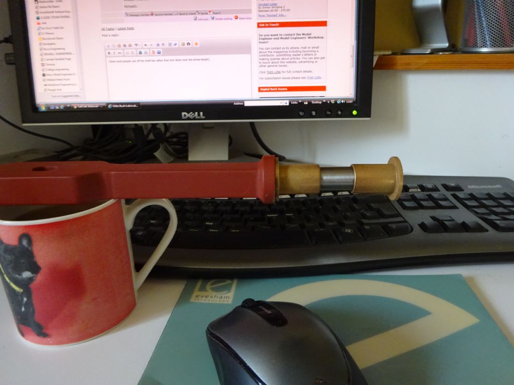

                                I think most people use off the shelf bar rather than turn down over the whole length at least on Locos
                                Different if machining the axle as youi would on a traction engine from a casting or fabrication much like this one I prepared earlier, will also have the double bearings the same as Hopper suggested.
