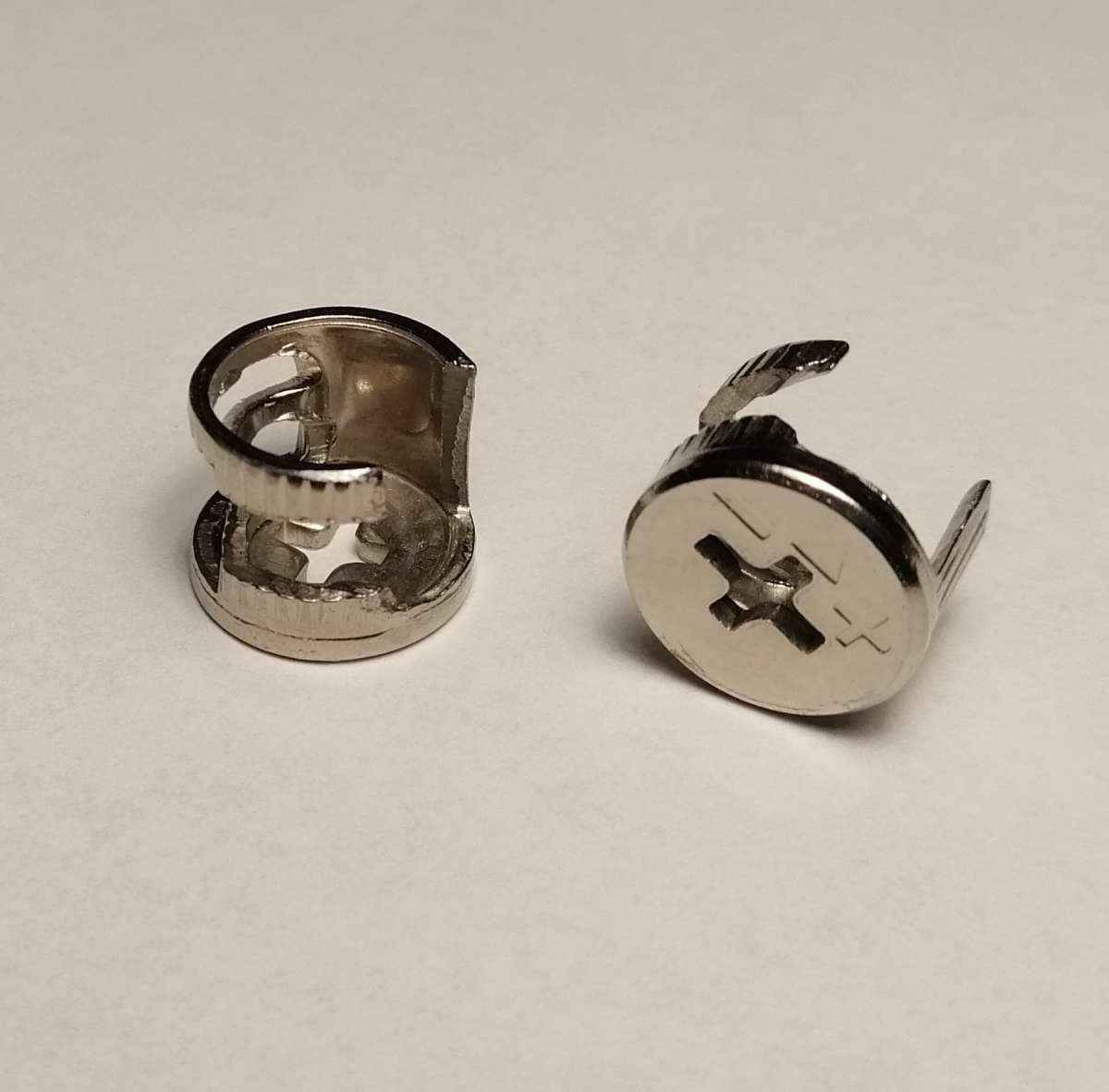

      Anybody who has assembled furniture will have come across these devices. One of today’s tasks was putting together a very low cost (and low quality) bedside cupboard thing. In my experience these cam-locking things are diecast from a zinc based alloy.IMG_20240114_165213_edit_73290495990379These are magnetic!
      Very little material in them but I’m not sure how they are formed but they are plated steel.

            Presumably machined from bar stock on an NC lathe, which will turn the basic cup then cut the side slots with a milling-spindle, then the screwdriver slots punched and the markings stamped?

              I would be much more likely to believe that they had found a way to make either the plating or the casting magnetic, Nigel

                They look like stamped and pressed to me.
                Outline stamped from strip and then pressed through a circular die to make it into a cup. Possibly multiple stages. It’s surprising how fast complex shapes can be made like this.

                  If it is nickel  plate or nickel under chrome it will be weakly magnetic.

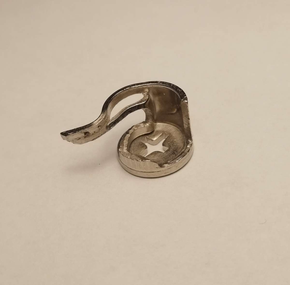

                    At first I thought it was possibly the plating that might be magnetic but decided from the amount of grip a Neodymium magnet had that the object itself was ferrous.
                    It is plated steel and was probably hot stamped/pressed into a cup shape and then has the apertures punched and the remaining parts of the tubular wall bent into shape.
                    What surprises me is that this method of manufacture could be cheaper than diecasting.
                    I re-formed ‘tang’ with pliers, it’s about 3mm a 1.4mm thick and unsurprisingly, bends just like steel

                      I would suggest die forged steel followed by shearing and then plating.

                        Looks like sheet to me, in 2 parts
                        Part 1 stamped and made circular, you can see the die marks
                        Part 2 stamped like a 5p coin
                        2 parts induction welded or whatever, together
                        Then dipped
                        you can see the grip marks on the outside of part 1
                        Being made of cheesium makes them easy to manipulate

                          My guess would be that having them magnetic enables advantages in automatic handling that justify a more expensive material than standard diecasting alloy.
