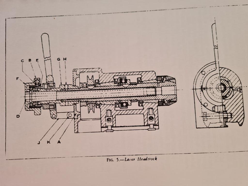

                    colin as you have a few Pultra lathes have you one with a quick close if so how the hell does it work ?

                      That's a good question, I'll have to go and have a look in the morning. I've only got one with the quick close lever on the headstock. Just to muddy the water, that one is a 1770, but with the large bore headstock, it is listed in the catalogues of the time, it takes the 20mm collets, same as the 1590 models. Think they are 19.7 mm by 1.666mm pitch. Much like Schaublin W20 collets.

                          #573999
                          Anonymous
                            Had a quick play this morning. As expected there's an over-centre lock. Here's the headstock and collet closer in the open position:
                            As the vertical bronze lever, on the left, is moved to the left it comes up against resistance. With further movement it 'clicks' over and locks. The locked position is shown here:
                            I suspect that the over-centre lock is provided by the linkage under the lever and yoke. I don't know if my example is worn but everything is very loose in the open position. But it still seems to close and lock properly. Under the brass cap over the spindle nose there is a finely knurled bronze ring. I expect this is used to set the position of the collet so that it closes properly within the small amount of lever movement. The closer will definitely operate with the spindle running.
                            Andrew

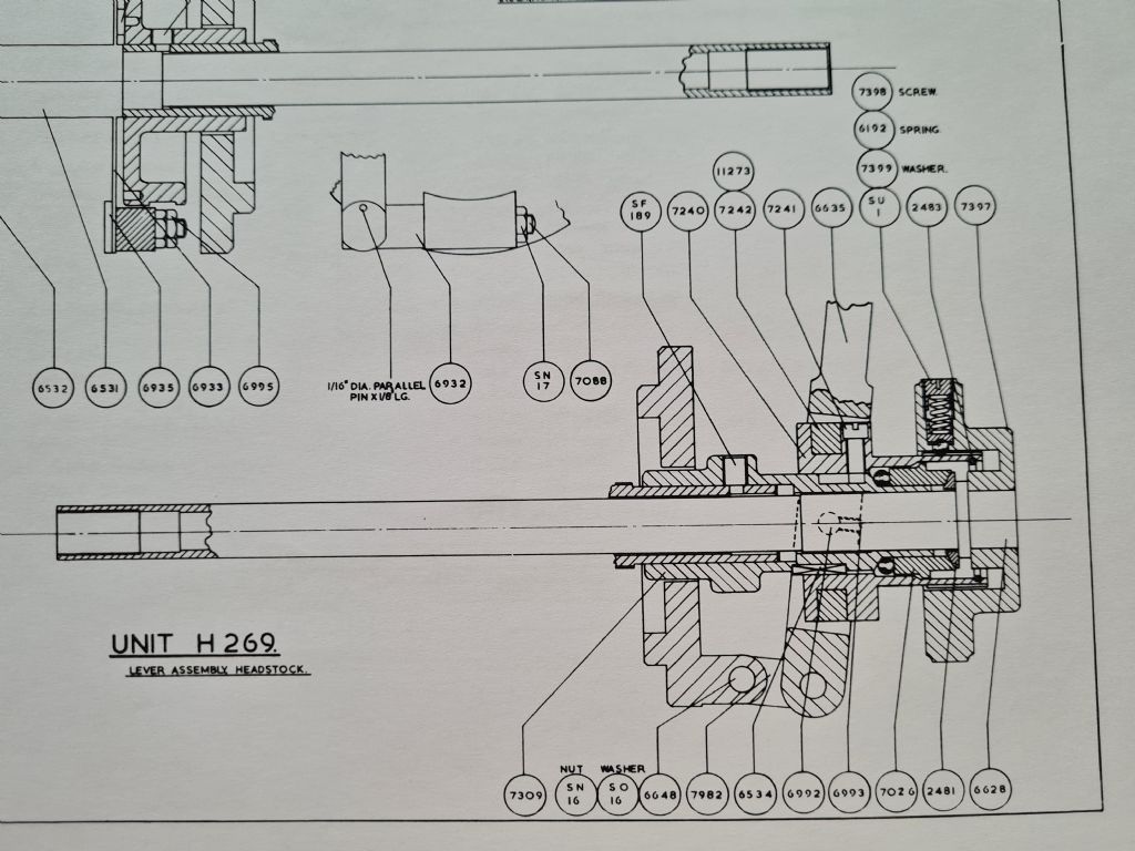

                                20211202_100154.jpgHopefully these drawings etc will help, but your manual from Smart & Brown should be much clearer.
                                My first attempt at uploading pics, so this may go horribly wrong.

                                  Having read the manual after posting I realised that I was wrong about setting the collet position. Should have read the manual before posting. embarrassed
                                  Colin has saved me from needing to scan and post the relevant pages. thumbs up
