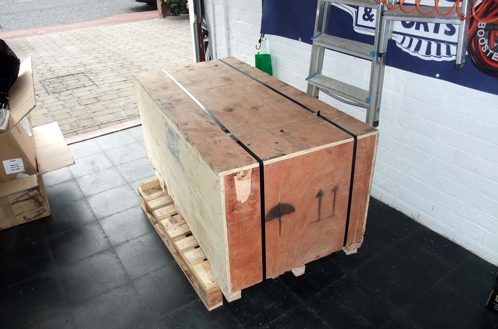

      Following on from my "Time for a new lathe" thread **LINK**
      My lathe arived today

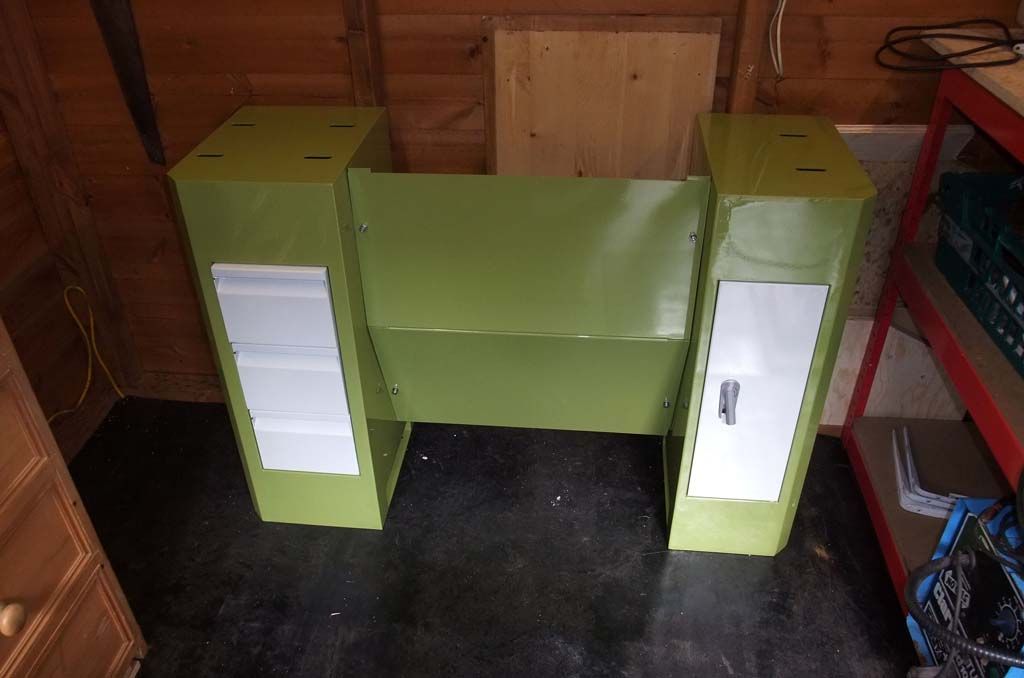

      There were a futher two boxes on top of this, they were the stand. Nice supprise as I got the delux stand with draws
      The stand alone probably weighs 50KG

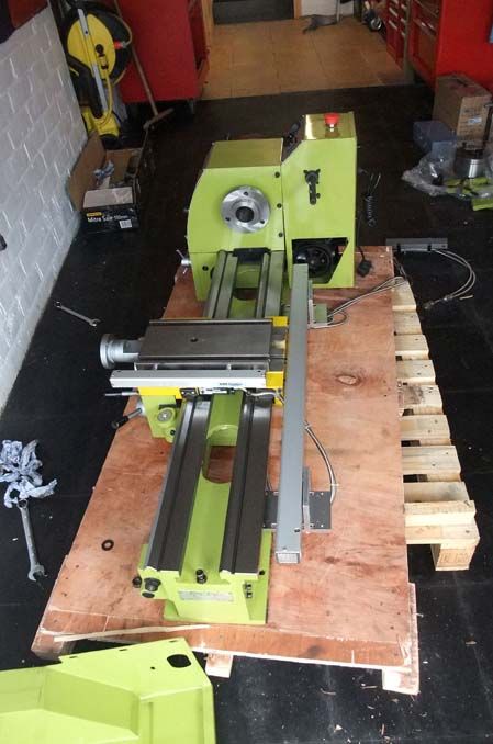

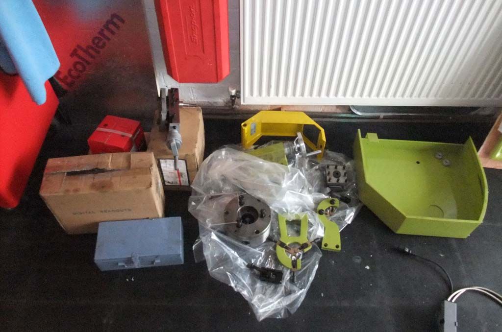

      Next task was to remove the packaging around the lathe, plenty firewood for a bonfire.
      Once removed I knew that lathe would be heavy so decided to remove as much as possible from it.
      The lathe stripped ready for some strong friend to come round and help move into the workshop which is in the back garden.
      I will take some photos when I get it installed

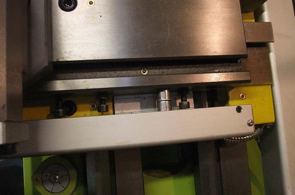

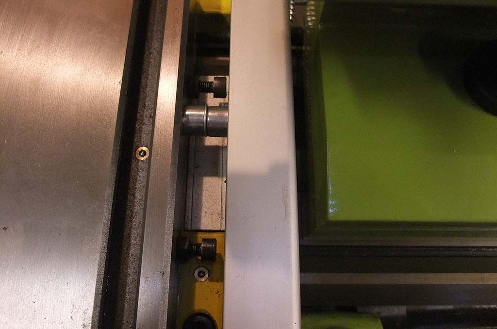

          Put a bit of silicon sealer under the feet so any oil or coolant won't leak down through the bolt holes in the tray and cover the draw contents in oil.
          Would like to see a couple of close-ups of teh cross slide scale as it looks like it will be hard to get to the lock and gib adjusters not to mention having to extend the tailstock a lot moreface 8

                Well it was a heavy bugger, especially the motor end!
                Anyway finally got it into the workshop and used an engine hoise to lift it on the stand
                Threaded straps behind the lead screw etc

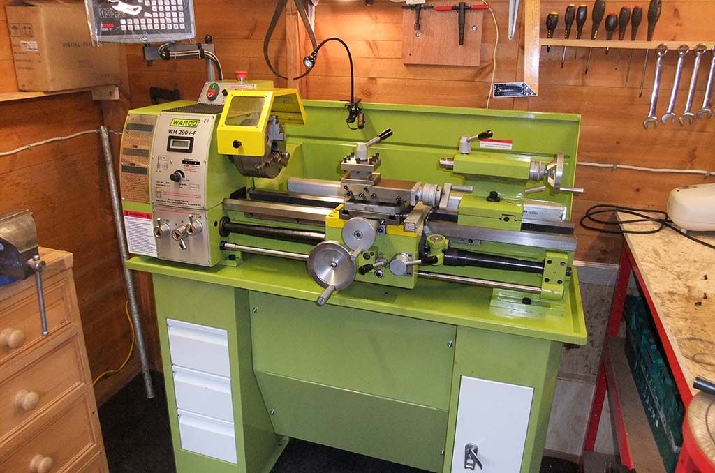

                      Got lathe into its new home
                      Got a big throat
                      Here we go Jason
                      Indeed, its going to be a pitta to adjust but not the end of the word, not sure how else they could have done it

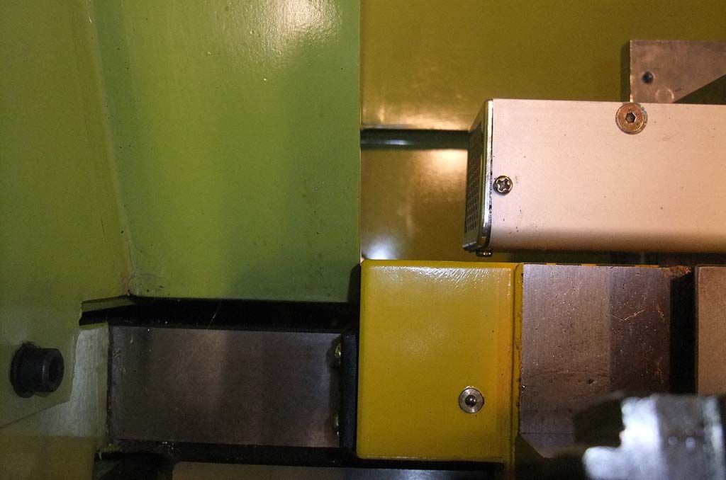

                      I have probably lost about 3" of movement of the tailstock but again workable. What is a pittly is the saddle buts up against the splashguard before hitting the headstock end
                      #129168
                        The biggest problem with that loss of travel will be when working on small slender parts that need tailstock support. Its limited me several times and thats without a DRO scale in the way. The usual method is to mound the scale off the back of the cross slide so it does not foul the gibs & tailstock..
                        Have you got a pic of the saddle hitting the splashguard, I can't see why its does it on yours as my 280 will touch the headstock. The chuck guard and lead screw cover are what usually get in the way.

                          Photo of the saddle hitting the splash guard
                          Just a thought, if I do need to get the tailsock close to the work I could always mount it in front of the saddle if I did not need to use the saddle tooling

                            Hi, your lathe looks nice in its new home. I have a similar lathe (HBM 290F), and as on yours the saddle hits the splash guard. With the splash guard removed I can move the saddle slighly closer to the headstock, but not much. The leadscrew cover is almost fully compressed when the saddle on my lathe hits the splash guard.

                              Since you have found out how the interlocks work to stop the motor you could fit a microswitch to the cover for the saddle to contact just before the power feed crunch. If you look closely at the wiring diagram you might even find a pair of terminals in series with the interlocks that are just bridged with a wire – obviously provided for yet another safety gizmo that they decided to leave off.
                              #129205

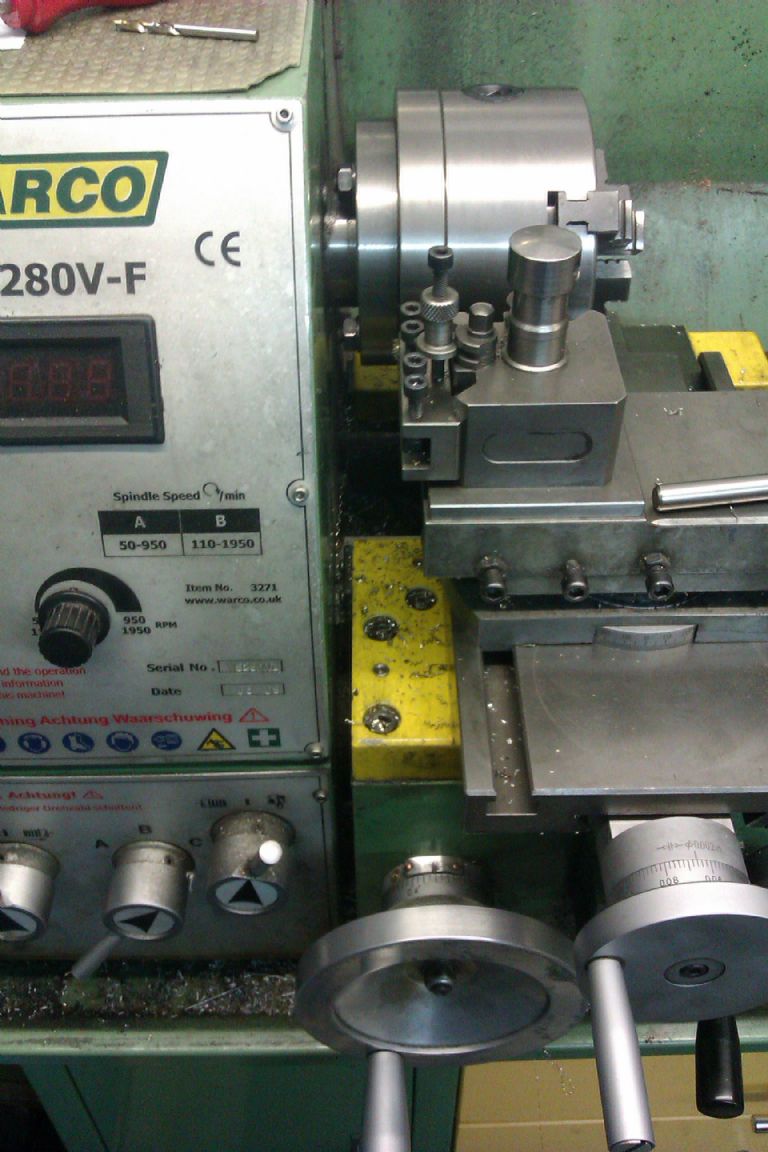

                                Just had a look at mine and the reason I can get upto the head is that I don't have the diagonal bump to the splash guard behind the motor. Also mine did not come with a leadscrew cover
