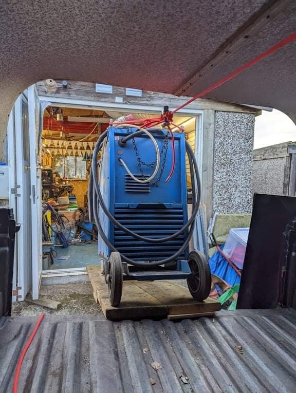

      Collected a new welder this weekend, an auction find coming from a shipyard with no warranty and assumed to need some repair work, but still an absolute steal for the price.
      Whilst I won't be able to run it at the full 550A off my RPC, there's quite a few nice features which make it a major upgrade over my current machine:
      • Latching trigger for reduced fatigue during long runs.
      • Fully programmable pulse welding for sheet metal and aluminium.
      • Pre-set "synergistic" modes for most gas mixes and filler wires.
      • Compatibility with push-pull guns for aluminium, stainless and other awkward wire types.
      • 4-roll feeder suitable for running flux/metal-core and dual shield.
      • Water cooled gun (not strictly necessary for most of what I do, but is a nice to have even at lower power settings).

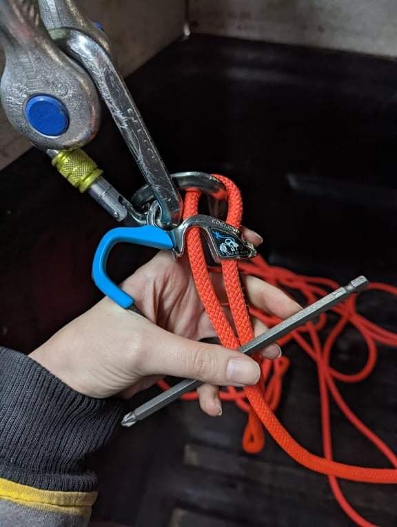

      The first challenge was how to safely lower a 340kg item from the back ofy pickup, I briefly considered taking the top off and using my neighbor's gantry, but settled on using a ramp and a climbing belay plate in "guide mode".
      Guide Plate
      All in all, it went pretty smoothly, although partway through it locked up sufficiently tightly that my erstwhile long suffering partner wasn't quite strong enough to release the auto-block and we had to trade places with her guiding it down the ramp and me operating the belay plate.

      My ramp cobbled together from two layers of 2½" by 11" timbers salvaged from a neighbour's roof renovation performed like a champ, at one point holding 340kg of MIG welder and 120kg of foolhardy human with minimal bending.

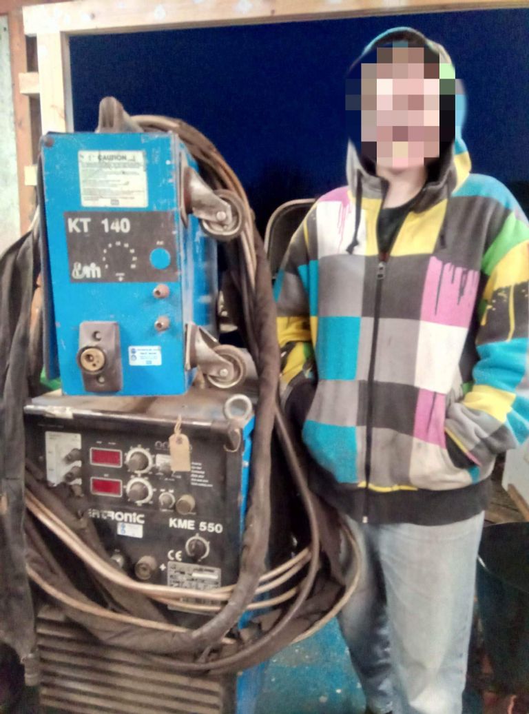

      Once in the workshop I assembled the feed unit on top using a length of broomstick as I had no steel bars the right diameter and the original spigot being long gone (the shipyard having put it on wheels and long leads to extend the range from power unit to weld), and snapped a pic with the missus for a sense of scale (She's 5'4”, the welder is 5" tall).
      54 Human for Scale
      I'm planning to document the process of cajoling it back to life, fault finding, and fettling it up here, for general interest and as encouragment to others who might be tempted to buy welding equipment to match the other "big old iron" many (but not all) forumites are fond of.
