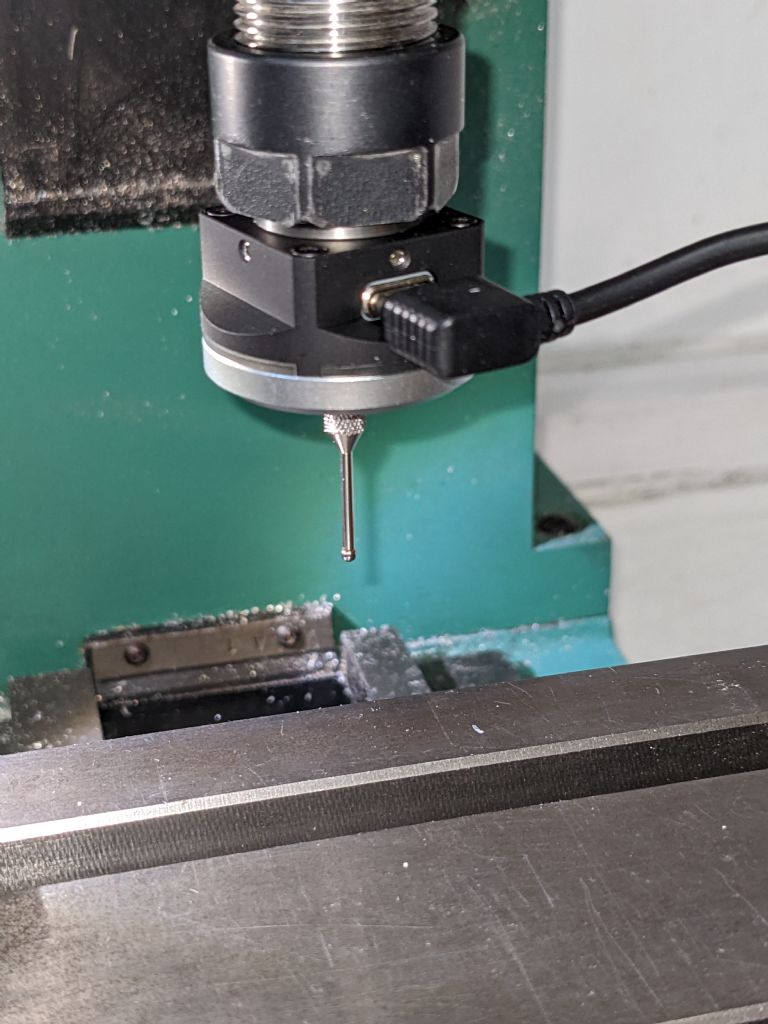

      This little gadget arrived in he post this morning – a 3D probe from China. Neat little design that takes up minimal daylight, has 6mm shank. Works on the original Renishaw principle, available from several sellers on eBay and AliBaba. Prices range from ~£50 upwards, this one cost me ~£59. A few people have used them over on the mycncuk forum and found them very good.
      Though I have home-made conductive edge and height finders which I use with probing routines of course they don't work on non conductive materials and the height one is really limited to tool setting.
      I'll report back!

                          Ok, just lashed up for a quick trial, and it works beautifully with Mach3. Mine was set up for NO npn, i.e. expects the probe to assert a low level as if the probe was grounded. Exactly what the new probe does, so no change required. I just needed to provide a 5v supply for which I use an old phone charger.

                              Just needs a 5v supply. It has some cool built in green LEDs that light when powered and turn red when triggered.

                                  I was replying to Pete. There is a signal wire too for the probe input to Mach.

                                    I have one. Seems to work great on LinuxCNC using the Probe Basic Subroutines. I have added a resistor to the supply wiring so I can use another input to indicate that the probe is plugged in. I need to modify the routines to check that input before running the rest of the g-code.

                                        I've looked at my Mach3 macros again and there was a lack of a G91 relative movement code at a couple of places. Now that I have put them in the macros seem to be working as expected. I think in some cases G91 was already set first by another macro running which did not set it back to G90 absolute motion and in other cases the direction of travel was the same for both G90 and G91.

                                          After being alerted by someone over on mycncuk I've downloaded a wizard called ProbeIt, the demo version, from Craftycnc. Looks like a good substitute for the macros, though not tried it yet.

                                              Tried ProbIt this afternoon and I have a warning for anyone with a rigid or near rigid probe, don't use it in its current release. I put a piece of aluminium tube in the vice only held loosely as I did not want to make it oval. I decided to try the internal hole probing routine. After the probe has made fast X axis contact with the right hand inner surface it backs off then makes a slow approach for a more accurate contact. Then it does what it should not, it moves towards the material before pulling back again. In the case of my lightly held tube it actually moved the tube in the vice. I also observed it doing the same thing when probing in the Y axis. This is not good and needs to be corrected. I stopped at that point because I didn't need to find it was doing similar things with other probing options and running the risk of damaging my probe.

                                                      I had another play with ProbeIt, this time before doing anything else such as probing with my usual macros or running any code. The issue seems to be that ProbeIt does not respond as quickly as my macros triggered by clicking a button. This may be due to the simplicity/complexity of the different probing options or macros. I put a spring over the tip of my rigid probe to try ProbeIt and it is clearly over-running after contact. With my macros I can do a fast approach at 330mm/min and get what looks like an instant stop on contact however ProbeIt bends the spring at both a 330mm/min and a 33mm/min approach. This will not be an issue with a probe such as the probe being discussed in this thread which has a 4mm leeway in the X and Y axes.
                                                      I could buy one of these probes but the simplicity and low cost of a home made rigid probe seems hard to beat as long as you have a system that responds rapidly on contact and you don't want to use it on non-conductive materials (I pull out the edge finder for such times).
