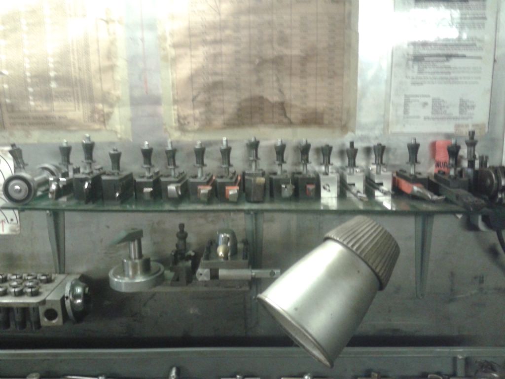

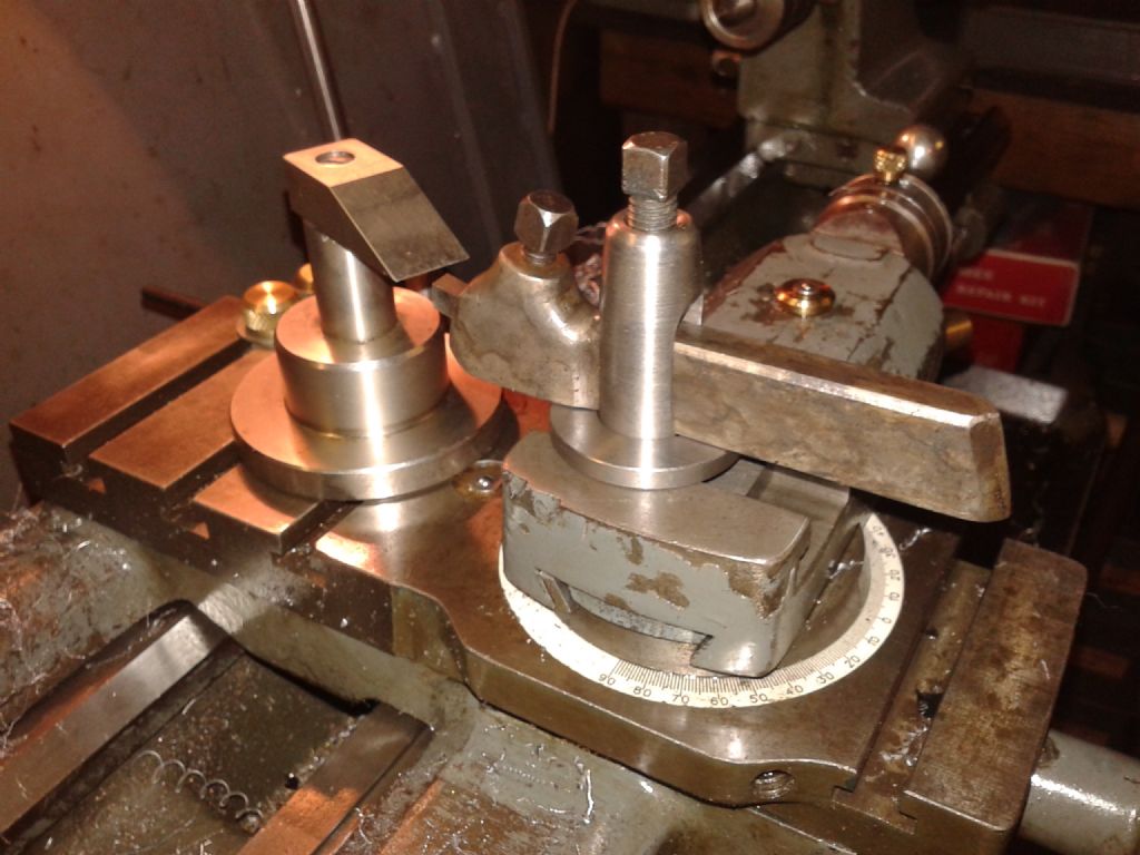

                                          Armstrong type tool holder in a lantern tool post…..
                                          And just for back up, 19 QCTP Dickson (note spelling) holders…
                                          And for extra extra back up, note the original indexing 4 way behind the light, although i despise using the thing and dislike it intensely.
                                          Edited By thaiguzzi on 04/10/2019 09:34:51

                                                  At least Thaiguzzi's Armstrong tool holder allows the top rake to remain constant, unlike those infernal American tool posts or boat type tool holders, when setting the tool to centre height.
                                                  Hope that all this heat, light, and smoke is of some help to the OP!
