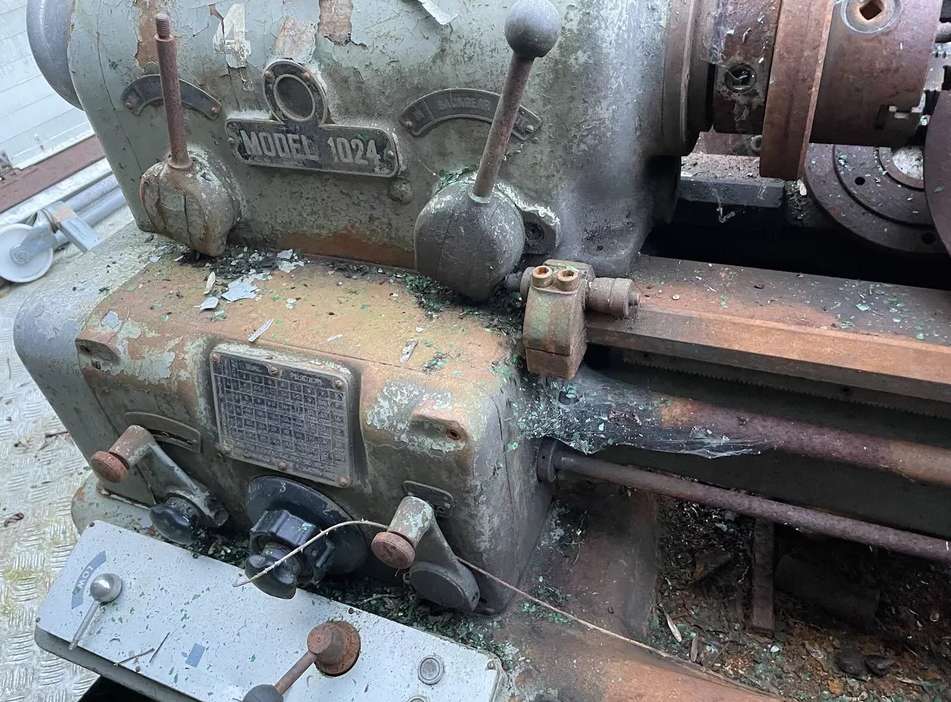

            Catching poor old Myford in a cost pincer between cheap new Far Eastern machines and super expensive industrial kit being sold well below purchase price due to the switch to CAD/CAM.
            Hard to believe, but many businesses after about 1985, needed the space taken up by top-end manual machines far more than the machine.   To the point that many were scrapped!   Dumped unceremoniously on Friday because CNC was being installed over the weekend.  Then schools and colleges sold their kit because industry no longer needed lots of manual machinists.  A long slow decline, but my feeling is the glory days of cheap ex-educational manuals is ending.   Forty years later, CAD/CAM is ubiquitous, plus lots of manufacturing has shifted to China.
            And 40 years later, the need to stay awake when buying second-hand is becoming more acute.   This example was on ebay recently, asking price £1000, no takers!
            sandb
            Beware assuming that because high-end lathes are cheap, so must be the spares.   Not so – expect to pay full price for posh bearings and other expensive components.   Lathes of this quality cost a kings fortune when new because nothing was stinted, making refurbishment expensive too.   Fortunately DIY saves lots of money.

              That’s not exactly a mint 10-24, more a kit of spare parts worth maybe £300.
                I reckon you are over valuing it by about £300:)

                      That carriage stop on the poor old 10-24 is sold for about  £125 on ebay by itself.
