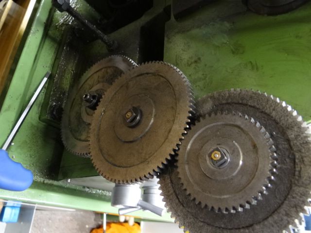

              C:UsersGraham BaronPicturesgear 1.JPG hi this is the gear should it have a washer behind it manual not very clear thanks
              #605222
              Graham Baron
                @grahambaron35953
                #605227
                Oldiron
                  @oldiron
                  Posted by Graham Baron on 10/07/2022 11:51:38:
                  We cannot see pictures on your computer. You need to place them in a forum album 1st.
                  regards
                  #605228
                  Graham Baron
                    @grahambaron35953
                    hi its the gear that comes off the screw feed behind the gear quadrant does not sit inline with the gears should there be a washer behind it tried posting pic but want have it

                        Graham Baron
                          @grahambaron35953
                          #605239
                          Graham Baron
                            @grahambaron35953
                            Hi wee got there this is the gear as you can see its not central do you have to put a washer behind it the manual is not very clear on set up thanks

                              To me, that looks like the gear on the Leadscrew.
                              That is driven by change wheels (Or change gears) Their function is provide the correct ratio between the Spindle and the Leadscrew, so that the Saddle moves the correct distance for every revolution of the chuck )
                              Buy the books so that you know the correct names for the parts of the lathe, and their function!
                              Then you can ask the right question and get the right answer.
                              Most often, the changewheel set up is is used for cutting screw threads. The ML7 has a Leadscrew with 8 t p i (Threads per inch)
                              Since the ML7 is an Imperial machine, I will deal in Imperial units.
                              Otherwise you will start asking about screws that are 6.354 mm in diameter, when the truth is that they are 1/4"
                              The threads on the lathe will be BSW and BSF with, probably gib strips BA. (This is where Tubal Cain's "Model Engineers Handbook" comes into its own to explain the mysteries!
                              So if you wanted to cut a thread with 8 tpi, the gears would be set give a ratio of 1:1. so the driving gear, beneath the tumbler reverse would be a 20T, driving an idler, to a 20T on the Leadscrew. The idler is merely there to transfer the drive from the Driving gear to the Driven, and does not affect the overall ratio.
                              If you wanted to cut a 16 tpi thread, the ratio would be 2:1, so that the Saddle moves a shorter distance for every revolution of the chuck.
                              If you wanted 12 tpi the ratio would need to 1.5:1 so the the 20T Driver would eventually transmit to a 30T Driven gear
                              For other ratios, you might need to use a Compound Idler, where two gears are combined.
                              Purely as an example, if you wanted to use the Leadscrew to provide a power feed for plain turning, you might set up a 20T driving a 60T on the Idler, which is coupled to another 20T which drives a 80T on the leadscrew.
                              This set up will provide an overall ratio of 12:1 which would mean that the Saddle would move the Saddle 0.0104" for every rotation of the chuck. This is fairly fine feed, but not the finest, which ideally would need to be of the order of 0.004" per rev, in my view..
                              Where are you located?
                              Try to find a local Model Engineering Society, so that you can find like minds, to whom, armed with the knowledge from the books, you can pose questions face to face and obtain more detailed explanations and answers.
                              Someone, hopefully. will tell / show you how to grind HSS tools for the lathe and to set them at centre height.
                              HTH

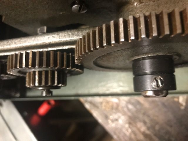

                                Welcome to the forum Graham.
                                I think the photo provided is of part of the banjo, but it's too much of a close-up to see what's going on.
                                Unless they have a full gearbox, lathes achieve the different ratios needed to cut screw-threads with a set of gearwheels that can be arranged on a 'banjo'.
                                My machine is Chinese, but the principle is the same. In the photo above a belt connects pulleys on the spindle and motor to turn the chuck, while gears compounded on the banjo on the right turn the lead-screw at a different speed to the chuck but synchronised with it.
                                Another view of the gears engaged from a the spindle to the lead-screw,
                                Details vary but the banjo can usually be swung away from the lathe to provide access, and a way provided to space and attach the gears as necessary to get the required ratio.
                                A table of combinations for different threads is often printed on the front of the lathe, and in the manual.  The lathe should have come with a selection of gears.
                                The gear combination pictured on my machine is set up for fine feed rather than screw-cutting. The saddle is moved by it slowly by the motor rather than manually, and the resulting cut is usually better/faster.
                                Glad you asked because taking the photos I notice a clip has come off the top gear. It needs to be found and replaced!

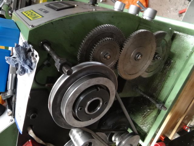

                                Can you do another photo, bit further back so we can see the whole headstock?
                                Edited By SillyOldDuffer on 10/07/2022 16:06:25

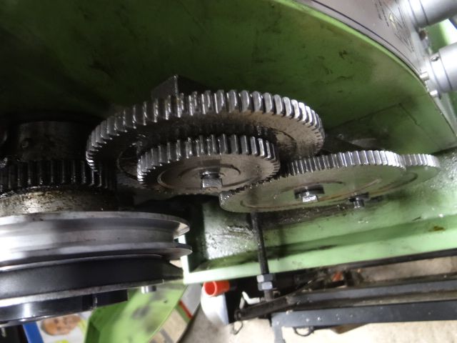

                                Graham Baron
                                  @grahambaron35953
                                  #605257
                                  Graham Baron
                                    @grahambaron35953
                                    looking at your picture the cog does not mesh all the way must lace in when running up to the thrust washer thanks for your pictures
                                    #605258
                                    Graham Baron
                                      @grahambaron35953
                                      Ye i have what they call installation manual and parts list i think they wrote it on back of a cig packet haha
                                      #605265
                                        I forgot to mention that the gear pairs are spaced away from the banjo with washers of different thicknesses arranged so the adjacent teeth don't clash.
                                        The gears in your photo aren't compounded, which means the ratio is high, possibly not a useful useful combination. The two small gears are being used as spacers, which is allowed, but their configuration doesn't alter the ratio: I'd expect at least one pair to be compounded. Perhaps an M10 owner could comment please?
                                        In comparison, my banjo picture shows a small tooth count on the spindle driving a big gear, which turns another low toothed gear (hidden behind) driving a big gear on the leadscrew. Most of the time, except when screw-cutting, it's usual to have gears mounted as in my example for fine feed, though moving the saddle by turning the wheel by hand is commonly done. (In which case the change gears don't matter.)
                                        Also allowed, when the lead-screw isn't needed, to shift the banjo so the gear teeth at one end aren't connected. The lathe runs quieter with perhaps 20% more power available for cutting.
                                        Just in case it's not obvious, keep fingers and sleeves well away from the teeth. Even turning the chuck slowly by hand can inflict a painful nip, and an electric motor can do serious damage to flesh and bone. Be very careful if the lathe is ever operated with the covers off.
                                        #605272
                                        Graham Baron
                                          @grahambaron35953
                                          Thanks Dave just getting to grips with it as said the manual is no very good apart from parts list
