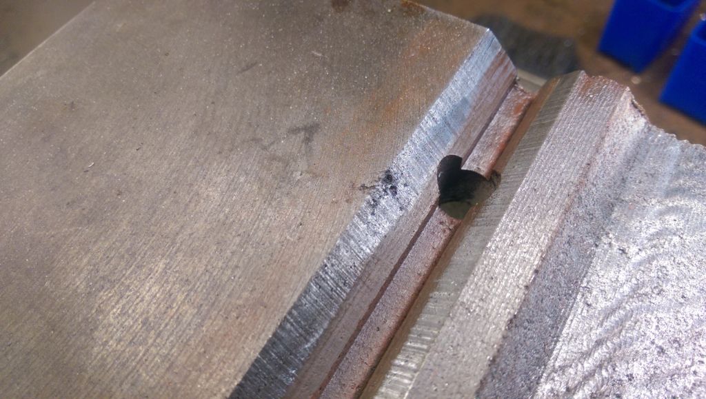

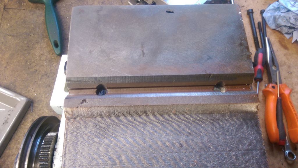

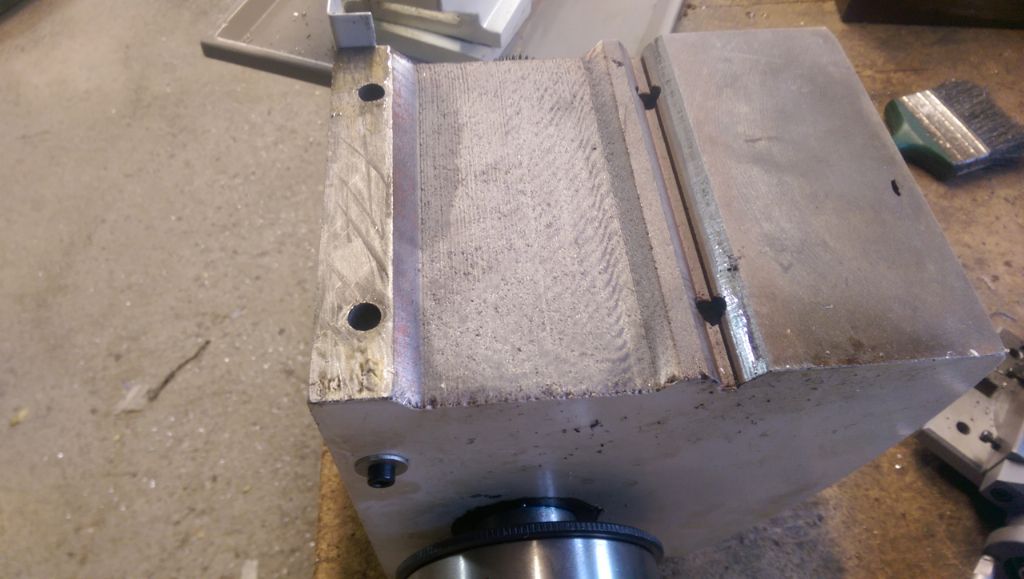

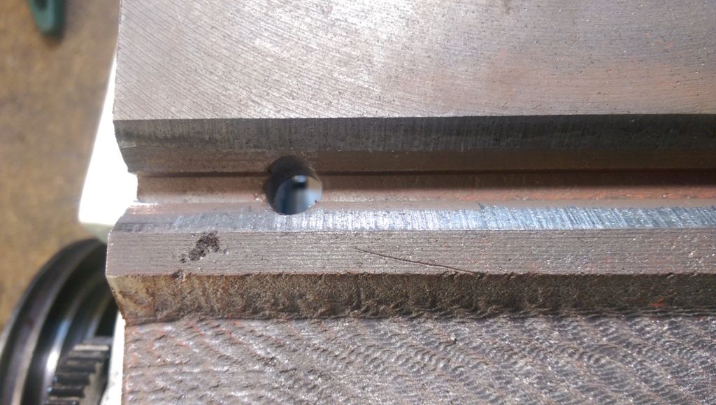

        Purchased a Chester DB10 10×22 lathe a few weeks ago and not had much time to play with it. What time I have spent on the machine has been problematic. There are a few problems the major one being bad chatter when facing and very bad when grooving/parting. After reading up on these type of Chinese machines I made a few mods to try to improve the situation,I made a solid 4 bolt compound clamp to strengthen the machine in that area and also a rear parting tool holder. These mods didnt help at all. The machine couldnt face more than about 0.25mm and parting was totally impossible. I ended up tightening the spindle bearings a little and it will face about 0.5mm now but parting still no hope.

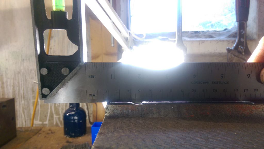

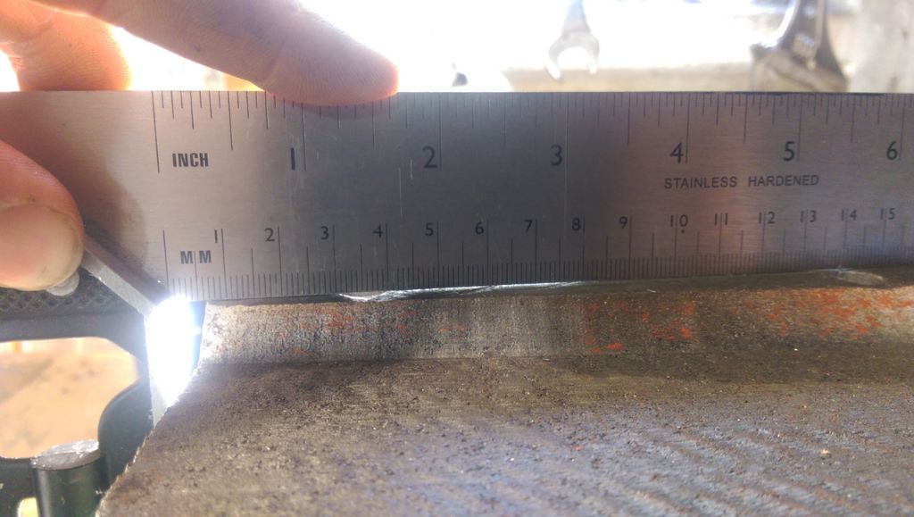

        I did some tests yesterday to look for spindle deflection and after much messing about I discovered the spindle was ok but the headstock is deflecting. If I put pressure on chuck or spindle I am getting about 0.04mm in both directions so adding that together its coming on for a tenth. I stripped it all down and took some pictures and am hoping someone can give me a some advice on how to proceed.
        So I dont think there is any chance of this head stock bolting down to the bed in a solid fashion. This must be where my chatter problem is coming from but how am I going to fix it?? I could really use some advice here. I was thinking perhaps I could fly cut and the then shim the larger surface to correct it (thats if I can get it to fit in my small mill) but I have not got a clue what to do with the V section. Should I just leave that? It is quite rough but probably has a better contact area the other worse side.

                      I would blue up the section of bed where the head sits ( make sure there are no burrs around the mounting bolt holes ) and then place the head up on the bed and give it a rub back and forth to see what contact points you have .
                      The v slot is ok and although the flat side is not the best provided you can get contact points in each corner it will be usable . I feel your issue is more about the head rocking around on high spots in the middle of the v and flat section .
                      Once you have it sitting there without any rocking you can use an epoxy filler to fill the voids ( take a look at stefan gotteswinter youtube channel as he uses this to fix a column alignment issue on his mill ) it can be re machined but you need to make up a jig that fits in the spindle bearing housing so you can set it up to machine everything parralell to the spindle bore .

                                        The problem with trying to scrape it and fit it is that although it might not wobble you don't know if the spindle is pointing straight down the bed or off by a few thou. This could make it difficult to decide if subsequent parallel turning setting up is due to the bed needing to be aligned or the spindle being out.
