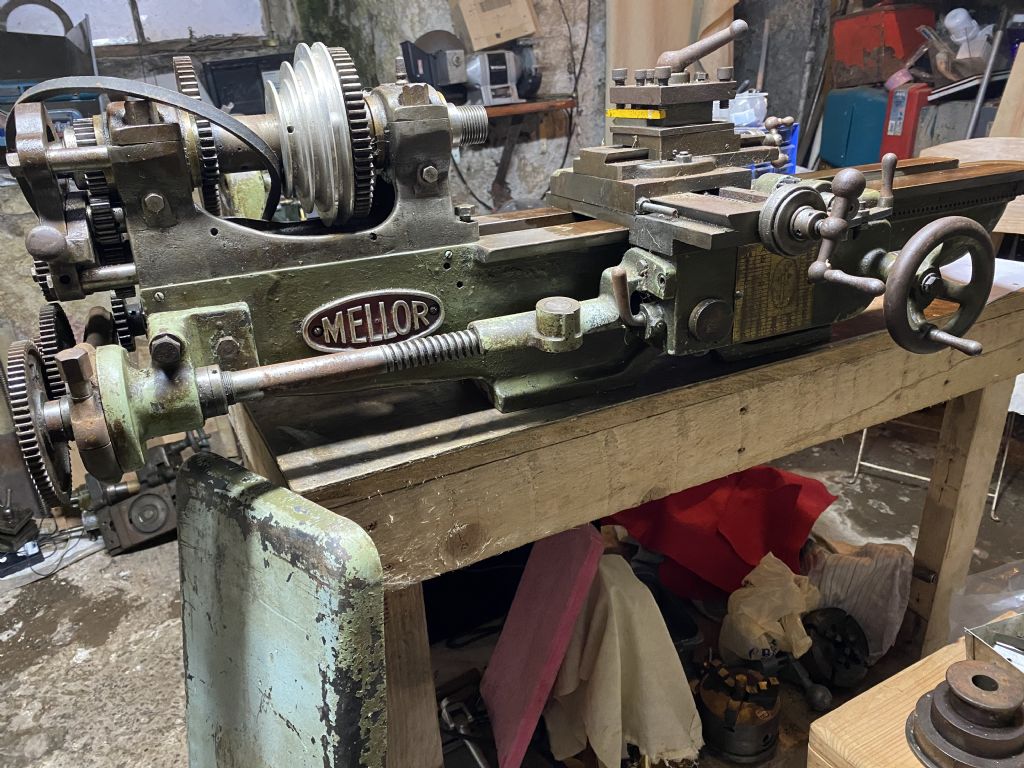

      Well, new to me. I was talking to a friend about lathes and engineering in general when he said “I’ve a lathe in lots of pieces and boxes, you can have it if you want to rebuild it”
      As you can see, I’m loosely assembling it to see what might be missing. Quite looking forward to doing this.

          Looks like theirs some good info and quite a few pictures from different angles on Lathes .co.uk site .Best of luck.

              Looks like a little beauty. The thread chaser dial mounted to the left of the carriage instead of the usual right is unique. Easier to watch while keeping an eye on the cutting tool I suppose.

                Thanks guys, it also has a feed shaft on the back driving saddle and cross slide.

                  c7e22834-354a-4794-b107-714daa3bc797.jpegJust a sanity check please! I need to fabricate the bracket for the motor mounting which is missing. I’ve been looking on-line to see if there are photos of what it should look like and found these. On both photos it looks like the lathe will be running backwards. ( I do realise this post could make me look silly) 😊

                    No, that should work the right way, Myfords, Boxfords and my Taig are all arranged that way round.
                    If it doesn't, just reverse the motor devil

                      First let me join the list of admirers, David … That machine has great potential yes
                      Now; may I suggest that whilst you are busy on the drive system you seriously consider converting it to Poly-Vee
                      … I think it would be transformational

                            You will not have known that the motor has a capacitor so not a brushed motor. I didn't think this could be reversed
                            but as always, I'm happy to be wrong.

                              I hadn't thought about Poly-Vee belts as I've no experience with them. Are they a lot better? I'm presuming that the
                              original flat belts would be the worst option.

                                Poly-Vee belts have the flexibility of a flat belt, and better drive performance than a single Vee belt
                                • Pulleys are readily available, and also easy to make
                                • Millions of cars and domestic appliances use them

                                  It has plain bearings – v-belts are already a step up from the original flat leather so why waste resources on new pulleys. If they slip a bit so what.

                                    For one thing … the drive can be much more compact, because Poly-Vee can safely wrap round small diameter pulleys.

                                      IF the motor runs in the wrong direction, reversing should be fairly easy.
                                      Those who know more than I, will give you the detail of how to reverse the connections to the start windings.
