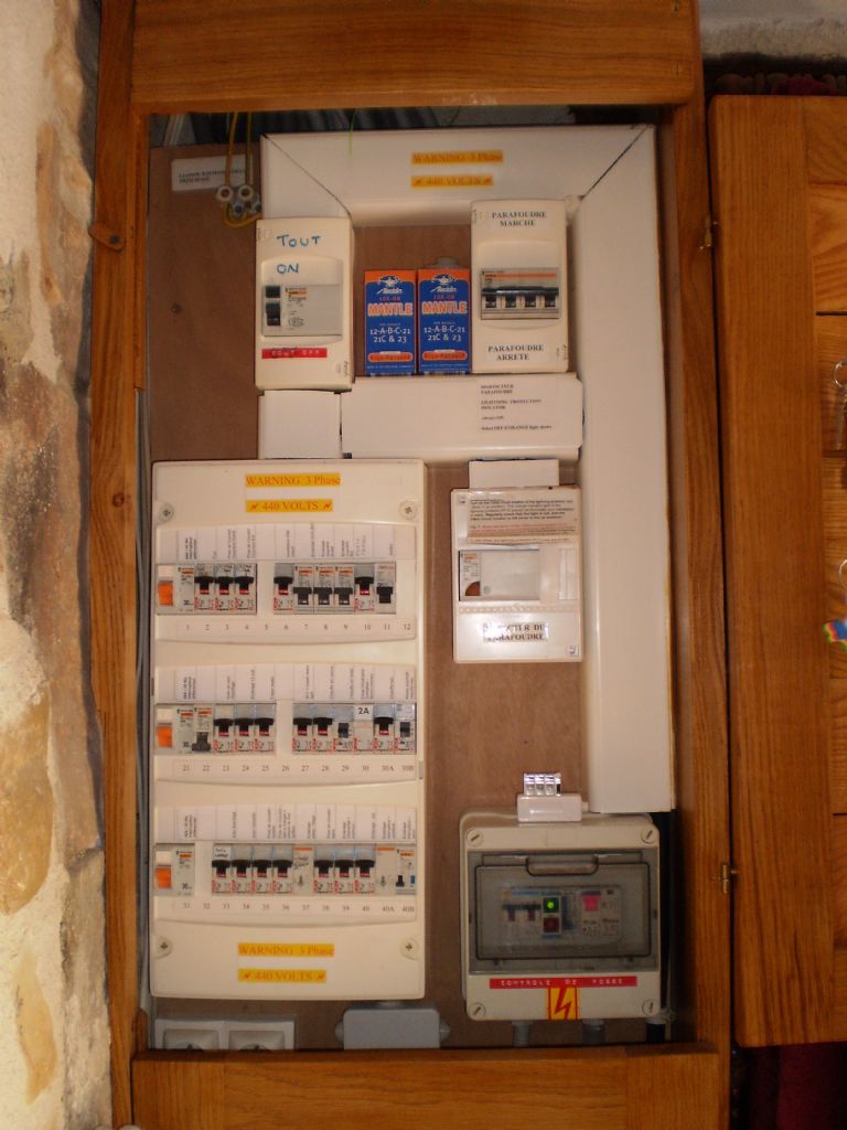

                        #461275
                        Speedy Builder5
                          @speedybuilder5
                          This is a photo of our fuse box for a French 2 bed house. I have to have 3 phase because I have a 950watt under floor heating in the kitchen – REGULATIONS !!!
                          Besides being 3 phase, there has to be a lightning protection device (which isn't fast enough to protect things like computers and an additional fuse box which services an external electric pump – REGULATIONS.
                          And not a single ring main or fused plug elsewhere. All circuits are radials with no spurs.
                          Ps. the mantles are for the oil lamps when we have power cuts.
