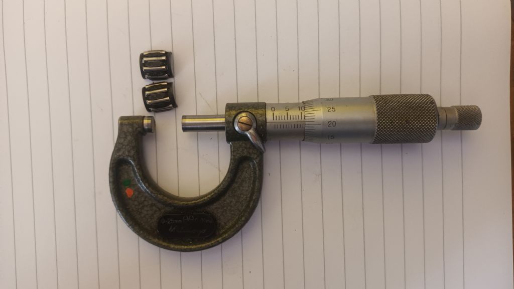

      I have a Chipmaster lathe running it's original variator. It is very noisy so I decided to see if a new set of bearings would help. Mostly this is going OK but I'm having trouble with identifying some needle roller bearings. I don't know how to properly measure them but they do not seem to be near anything that I can find listed. Any thoughts would be appreciated.

          The cages usually have the part number on them, try a magnifying glass. Otherwise measure the shaft, the bore and the overall length and get in touch with a firm like The Bearing Boys, they may be able to help.

            Often, needle roller bearings have an outer cage and run direct on the shaft itself.
            It looks a s if the original cage has broken up.
            If you measure the individual rollers, adimater and length, and count them, quoting the shaft diameter , a bearing supplier might be able to identify the bearing.
            Arc Euro have a limited range of Metric nedle rollers, but will, I am sure be helpful.
            Probably googling needle roller bearings will bring up a good range, but it looks as if you need to talk to a supplier.
                Thanks. I've had a very close look but there are no markings. Not sure what I didn't think of measuring the shaft and bore, seems obvious now you mention it!!

                    Thanks everyone, I have found a bearing supplier who can help
