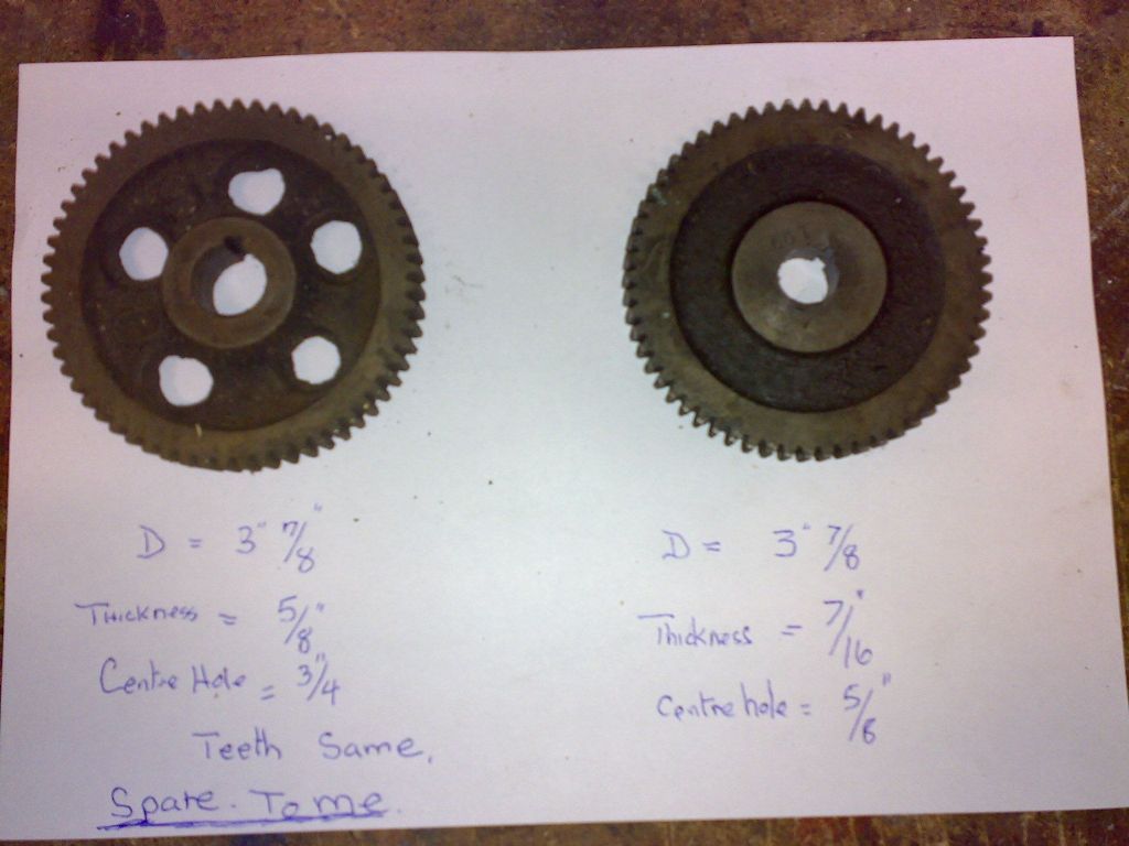

                  Here we go. I found the original photo my friend sent me about the adapted changewheel. The adapted one is on the left and an original is on the right
                  Anybody recognise it?

                    Probably the helical change wheels off a dividing head.
                    What sizes are you looking for ?

                      Posted by John Stevenson on 21/10/2011 13:02:03:
                      Don’t know John I’ll get in touch with him over the weekend. They are straight cut btw not helical (sorry if that sounds dumb but I am a newbie!)
                      If ones from another lathe cannot be found then cutting new ones is an option (but then we have to get a dividing head to use my wheels with )

                        When I said helical I meant the drive wheels that go between a dividing head and the leadscrew on a milling machine to allow the dividing head to rotate as it moves along the bed to cut helical gears.
                        Not that the gears were helical, sorry I was a bit too terse with my reply.
                        I may have some 16DP gears that came off a scrapped Colchester
