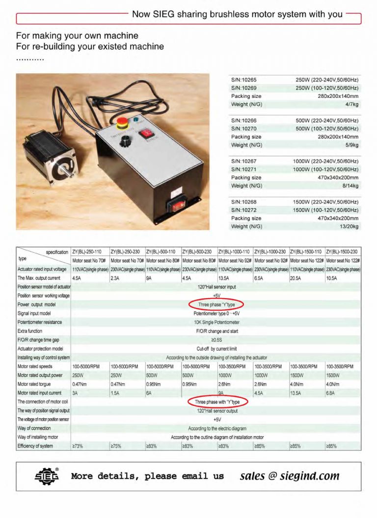

                              #158539
                              blowlamp
                                @blowlamp
                                The Sieg system is 3 phase.
                                #158544
                                  Posted by blowlamp on 23/07/2014 00:19:14:
                                  Martin.
                                  Martin,
                                  Technically correct … but I think you needed [for the sake of safety] to highlight a few more points
                                  • The system is 3 phase
                                  • The motor is Y connected [i.e. Star]
                                  • The motor has Hall effect sensor
                                  These features combine to suggest that the motor is actually "Brushless DC" and, if so, it would be totally unsuitable for connection to the "common or workshop" Inverter … The drive circuitry in Seig's system would be a dedicated unit, similar in concept to the ESC used for the R/C models.
                                  Edit: There is a useful introduction to BLDC in the first post on this page.
                                  Edited By Michael Gilligan on 23/07/2014 08:56:13
                                  #158548
                                  blowlamp
                                    @blowlamp
                                    Posted by Michael Gilligan on 23/07/2014 08:47:25:
                                    Martin.
                                    Martin,
                                    Hi Michael.
                                    Yup, it already says that in the information in the picture, and that's why I wrote "The Sieg system is 3 phase.", as that is what I wanted to highlight.
                                    Interested parties should indeed make further enquiries, before entering territories they are not familiar with.
                                    Martin.
                                    #158551
                                    John Stevenson 1
                                      @johnstevenson1
                                      They will NOT run on an invertor – Don't ask.
                                      #158555
                                        BLDC motors have magnets in their cores.
                                        AC motors use induction in a 'squirrel cage' armature.
                                        Clearly with fixed polarity magnets, the BLDC motor will only run on DC…
                                        #158558
                                        blowlamp
                                          @blowlamp
                                          One system uses a 3 phase A/C inverter and the other system uses a 3 phase D/C inverter.
                                          Martin.
