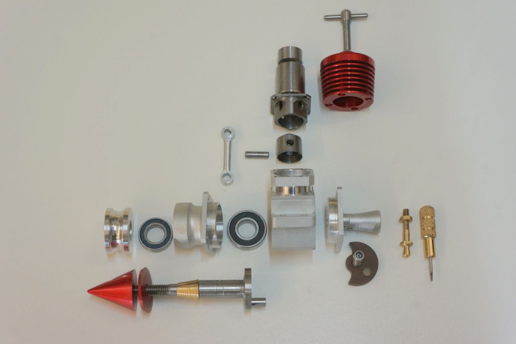

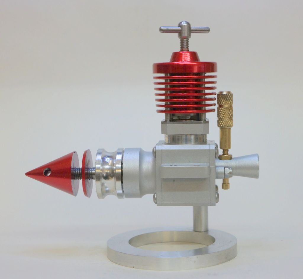

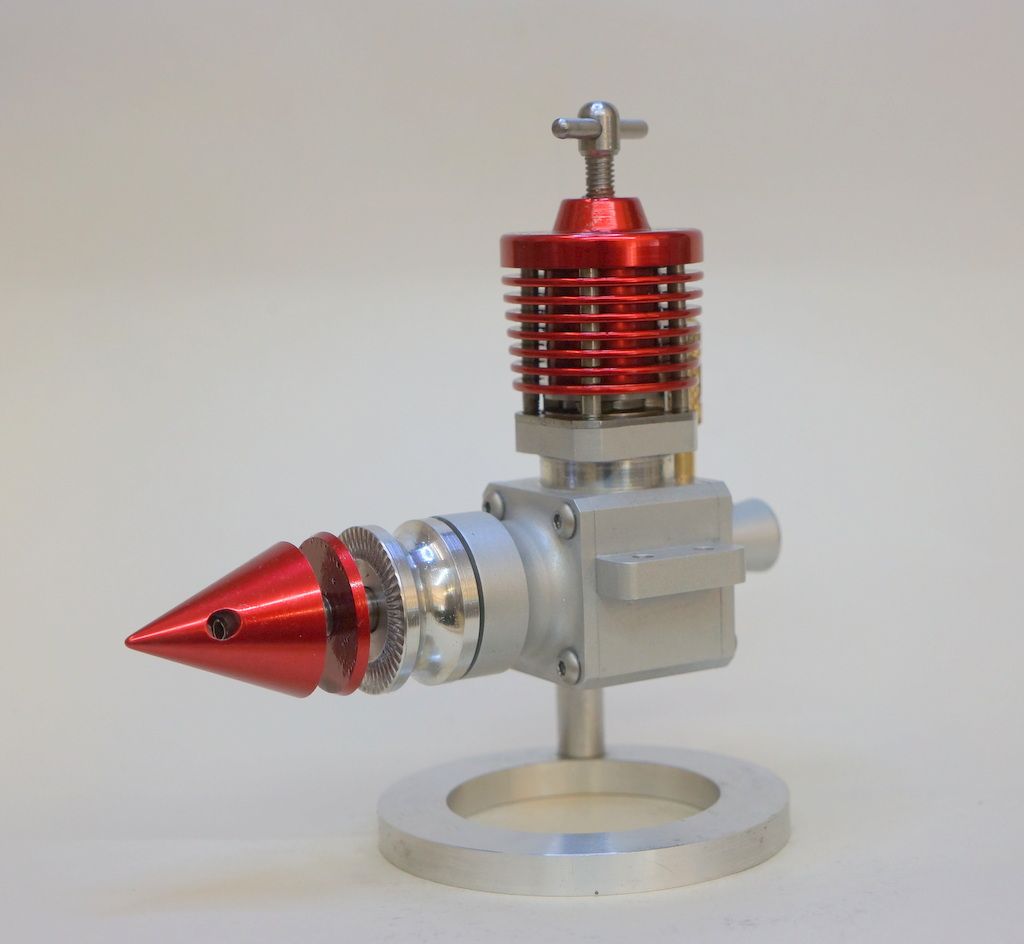

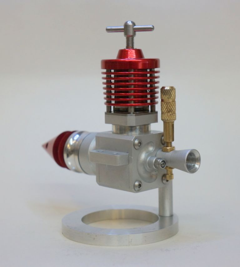

      1-dsc04467.jpg2-dsc04483.jpg4-dsc04484.jpg3-dsc04482.jpgThese are photos of mylatest I/C engine build, the 2.5cc, Rear Disc induction, NALON VIPER, diesel. I had notrealised until I had assembled the engine that it also has sub piston induction. It was an interesting project and mindful of the discussion on this forum a few years ago,about omissions on the drawings regarding lack of clearance for the ball races to work correctly, I re- drew the front bearing housing and the crankshaft to accomodate the necessary clearances, changed the crankshaft to have both ball race bearings with the same 3/8" diameter internal bore and moved the step down to 1/4" diameter to be 0.025" in front of the seated ball race,allowing the Prop Driver collet to fit against this and not the bearing. Also,changing to a conventional male thread for the Spinner. The Cylinder to Crankcase flange is circular as drawn and therefore minimal sealing area. This I changed to be the same shape and size as the crankcase. This not only increases the sealing area, but also gives accurate re-location of the cylinder/piston relationship for any strip down after the engine has been run in well.
      The 4 inlet ports in the cylinder are angled upwards at 25 degrees. No correct information is on the drawing to make sure the exit holes are in the right place and in relation to the 4 exhaust slits. This provided some brain searching regarding hoe to carry out this operation without making a mess of it. I finally decided to ghech 10 time and cut once, by making a dummy cylinder in Ali Slitting the exhausts in the mill and drilling using a solid carbide slot drill in my Dremel, mounted at 25 degrees on my lathe, with cylinder in the indexed chuck. I then cut this cylinder down through its vertical centre, to allow me to accurately measure the relative positions of the drillings inside the cylinder. Fortunately,they wer all spot on, so I repeated the drilling process with the steel cylinder. All parts went togethe without problems.

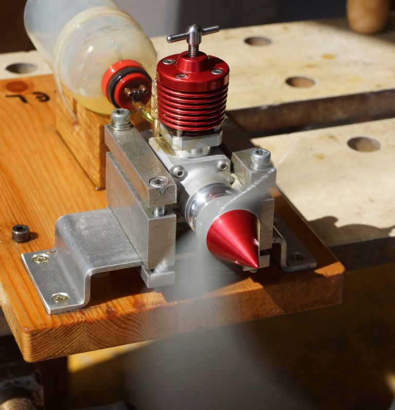

      Set up on the test stand with a wooden 9×6" propeller,it started faily easily and was given two x 4 minute rich runs ,with cool down between. No gaskets, no leaks. The third run I over primed and had a back fire or two. Once it had started it would not respond to any adjustments so I stopped it. Compression was not good, so took head and cylinder off to find that the compression screw had punched through the cast iron piston ! I assume that by backing off the compression screw a full turn the contra piston was then slammed onto the screw at the next backfire,causing the cast iron to fail. It is my practice to put a small 45 degree bevel on the end of the compression screw thread, as I have found that lft square the end thread can deform and prevent it being able to be removed from the head if needed.
      I decided to make the new one in EN1A. Thisis fitted and two more 4 minute runs have taken place since with no problems. I noticed the wood prop had a damaged edge where it had hit my starting stick when it backfired, so these later runsare with an APC nylon 10×4"prop. When I have allowed it to run slightly leaner for a minute it is hovering around 8000 RPM andthe photo of it running is at that speed. I am noticing that this engine is running hotter than other diesels Ihave made. The oil from the exhausts is brown and has that burnt Castor smell. This will possibly diminish as the engine frees up after further running. It will be interesting to see how far I can take this engine,remembering that it was designed as a high performance sport engine of its time.

          Could the drag of the bearing seals be causing extra work for the engine which is contributing to the temp rise indicated ? this may be heating the front housing so could be felt after running.

            I have removed all but the front seal and the front housing stays reasonable. The heat is in the head, but is improving.

                Have you hardened the liner or is it stock EN1a ? Reason for asking is that the new contra piston raises the possibility of galling and will be a beggar to remove if it does – just a thought to consider.
                The original was, I believe, designed to offer an alternative to the Oliver Tiger in T/R so much more than a sport engine I would say so it should have great potential for further running
                I like to keep the prop pitch down to 4" -5" at most for early runs, 6" provides too much load which can lead to quick heat build up as I'm sure your aware.
                I have a feeling that it is not a good idea to use identical bearings to support the crankshaft too though cannot think why. I do remember a discussion on this somewhere in the past explaining the reason but having looked cannot find any reference. This would be for an engine with an intended working life I'm sure, can't see that it would make much difference for an ME project.
                As said though, lovely result, you should be well proud smiley
