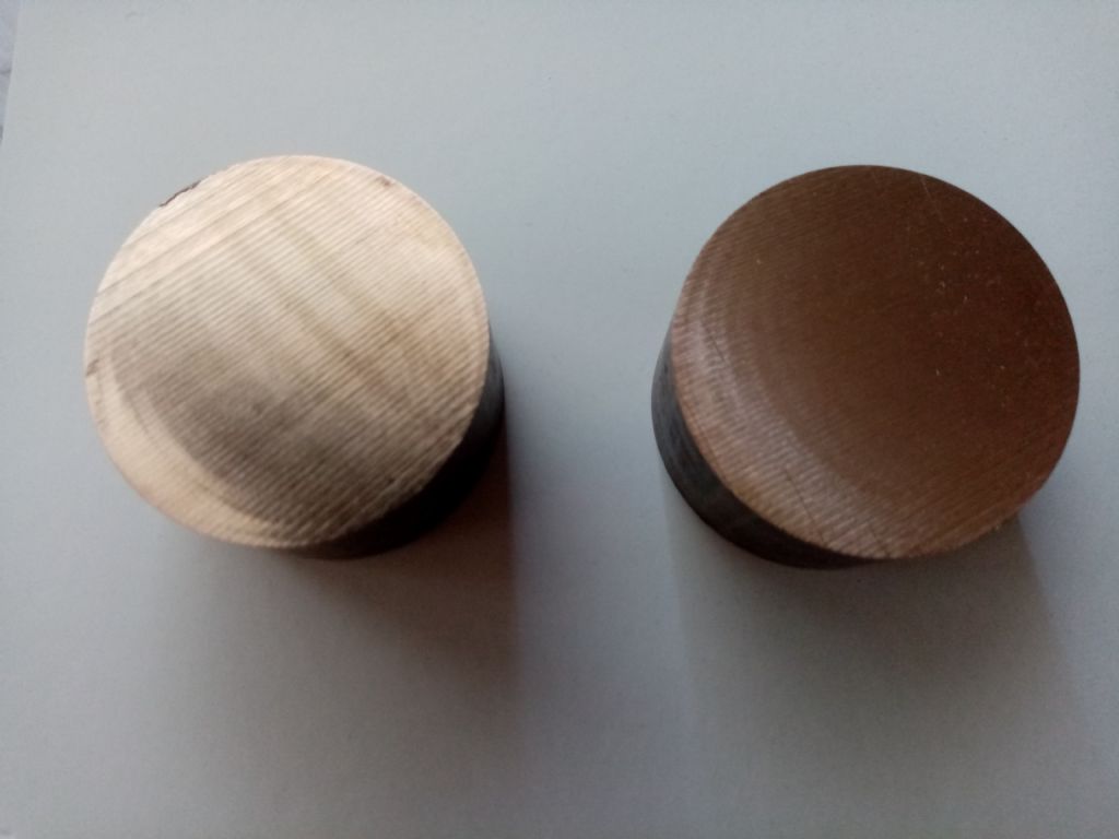

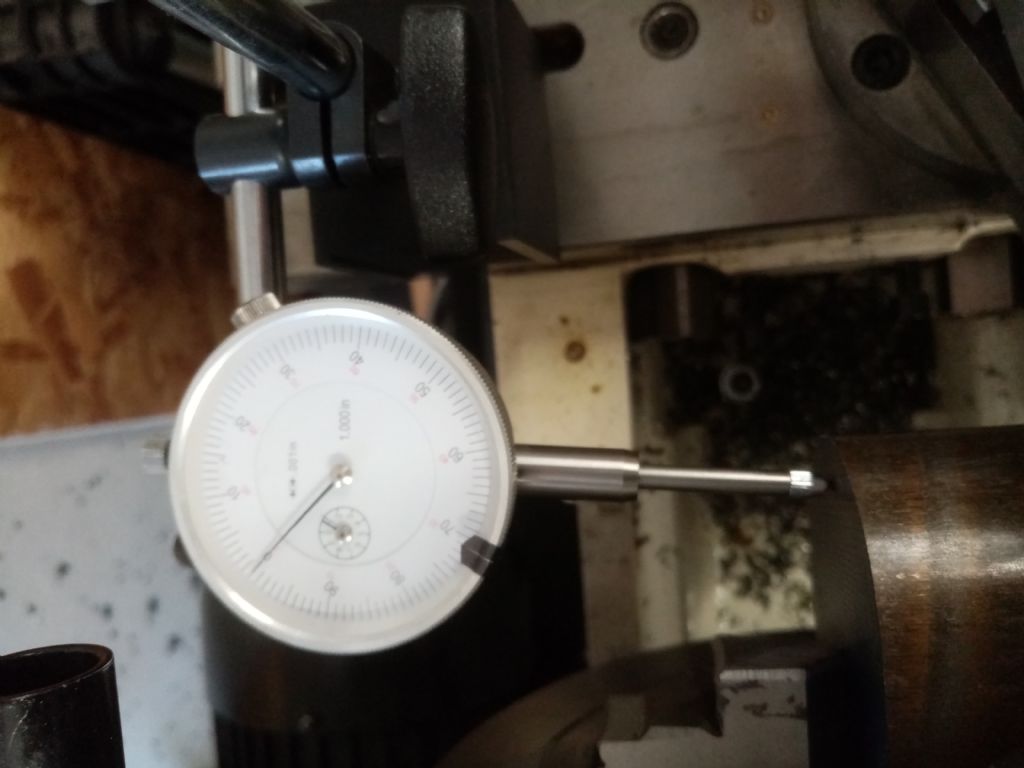

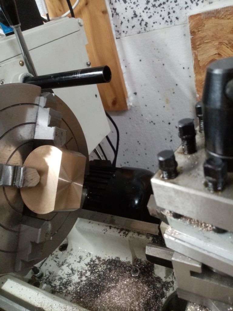

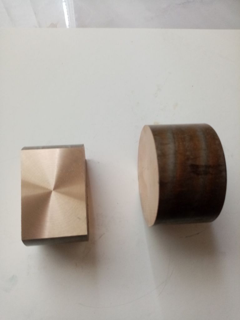

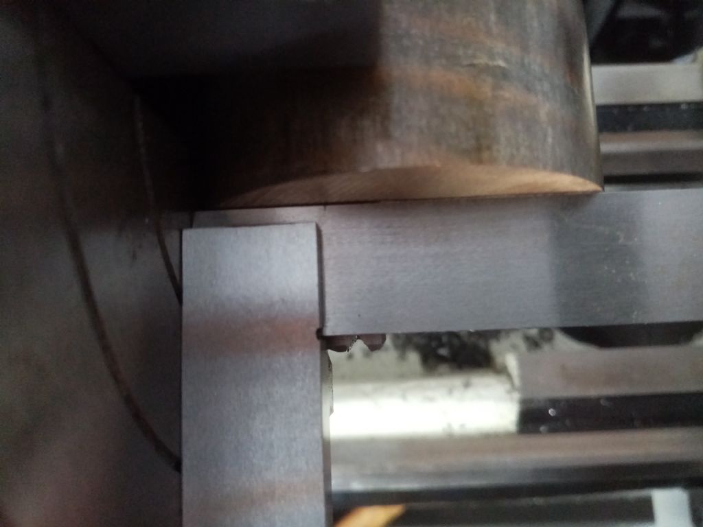

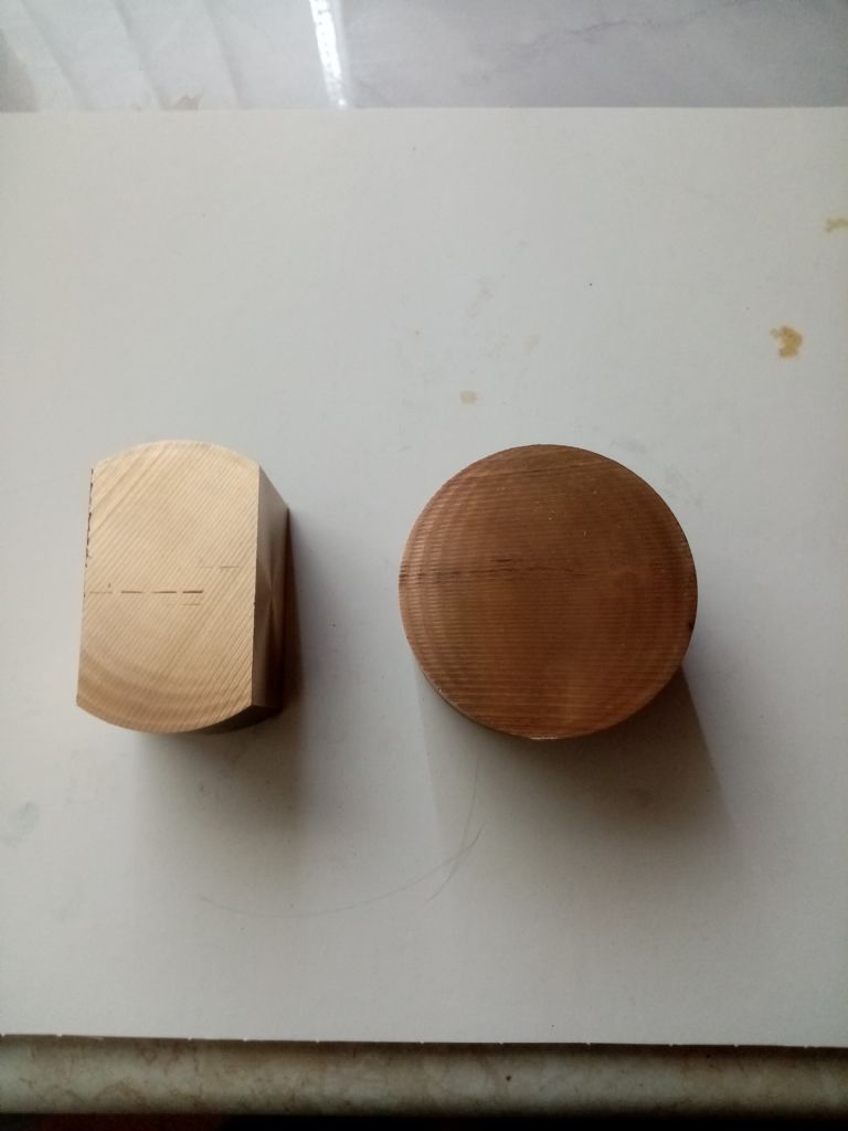

        I stripped the mill a while back and noted that although the lead screws were in great condition, the nuts had done a lot of work and had a fair bit of wear evident.
        So after reading about Kennions being excellent suppliers of stock I ordered 2 x 66mm dia bar to make my two new nuts. i ordered the bar on Tuesday and it arrived on Wednesday morning cut perfectly to size and extremely well packaged. I will certainly use this supplier again.
        Anyway I promised Nigel Graham I would update anything I did with my mill as he has the same mill and is interested to see what I do.
        So today I made a start, First piece into the lathe, trued up and then turned in the same way that you would make a cube. Photo's below.
        Edited By Ian Skeldon 2 on 09/06/2021 18:36:13

          old mart
            @oldmart
            What spec bronze are you using for the nuts? I have made them from leaded gunmetal SAE660.

              Hi OM,
              I am using the same spec as you used SAE 660.
              It cuts really well and should prove to serve the purpose for the rest of my life time. Only problem I can see at the moment is cutting the thread. I have searched the internet pretty hard and can't find 1" 5tpi ACME inserts for a tool that will fit into the bore. I only have a basic bench grinder so grinding something accurately is going to be challenging, mmm I might look for a tap although I guess they either don't exist in that spec or they cost as much as a mortgage!

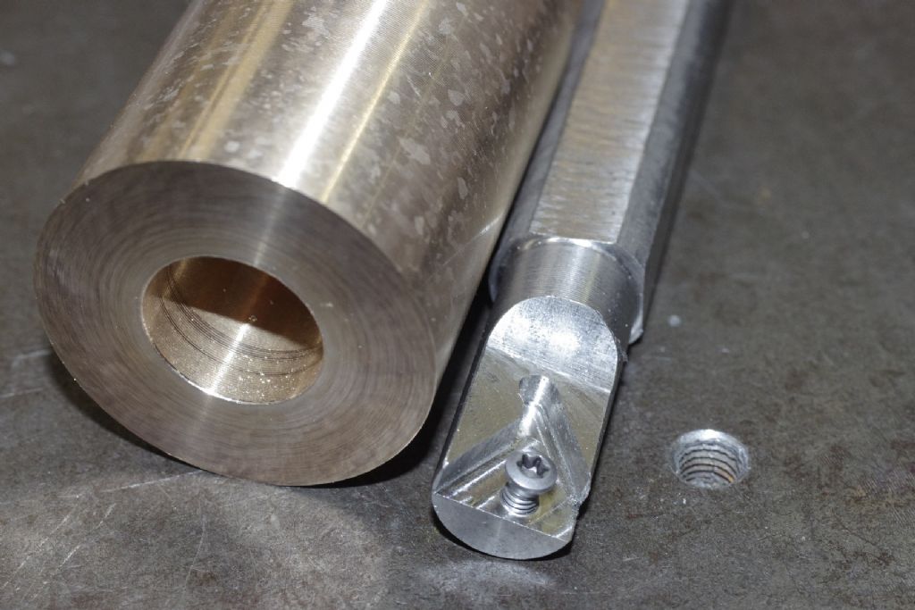

                      Funny you should mention 1" x 5 ACME, I have just made a tool to hold the er22 5tpi Acme lay down insert. The tool will pass into the 0.800" start bore for that size. You will never be able to buy one as tooling for that size would need a start hole more than 1 1/4 " diameter. The tool is right hand and will be used away from the chuck for a LH thread. I will have to measure the working length, maybe 2 1/2". The knee of the Tom Senior could do with a new nut.
                      I would be willing to lend you the tool, if your lathe can manage it.

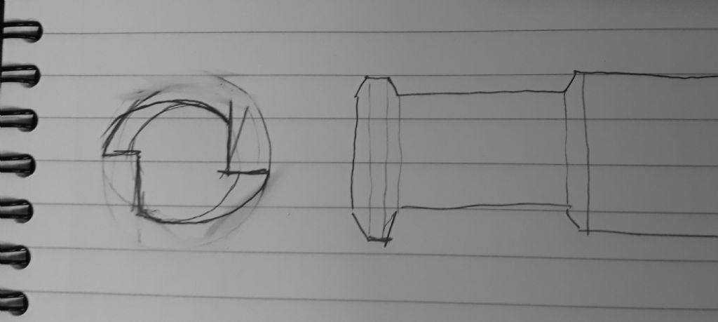

                                  I had a bit of a snigger when I read the comments about the tool I had made to hold the 22 size insert and still pass into a hole of 0.800". I have to confess two points regarding that tool. It is made of a bit of steel that was laying around, and I strongly suspect it is a bit of stainless steel. The photo is the only one taken of it and as soon as I fitted the insert, I realised my mistake. The insert housing is much too near the end of the tool and the insert overhangs the end dangerously. The entire end has now been remachined to give the best support that I could manage.
                                  Regarding lending the tool, The chance of damaging it is remote if careful attention to the actual thread cutting is adhered to. With a 5 ACME, the actual depth of thread is 0.1" deep from the start bore of 0.8", resulting in a finished diameter of 1". This might have to be increased very slightly if the leadscrew is used as the go gauge.
                                  To use the leadscrew as a gauge, you would have to remove the tailstock.
                                  If the thread is produced in multiple passes normally, from first touch in the bore, depths of +0.015",(twice) + 0.014", +0.012", +0.010", +0.008", +0.006", +0.005",(twice) +0.004, +0.003", +0.002", +0.001", which make the total 0.1" deep cut. Any further passes to get the leadscrew just fitting to be made at 0.001" or less. The reduction in depth of cut as the threading gets deeper is because the ammount cut is getting bigger each time.
                                  I can make another tool any time and your only requirement would be to buy me another insert if you broke it which is very unlikely, so the offer stands.

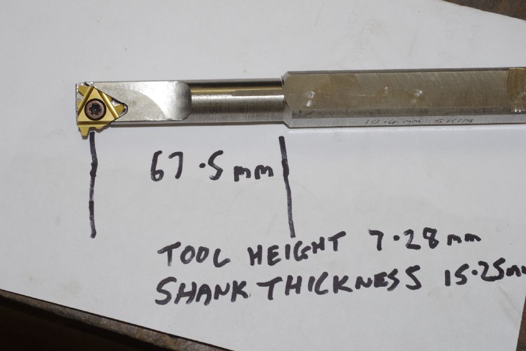

                                      I remembered to check out the ACME threading bar when I was at the museum today, and have brought it home with me.
                                      After a bit of a struggle, I managed to find your address and the tool will be in the post Monday.
                                      If you are careful and take the cuts that I recommended in my post of the 11th, there is no danger of a crash. The hard thing I find is remembering to go back to the zero on the cross slide every time before withdrawing the tool. It helps to have the settings on a piece of paper and tick them off as you go. I would try out the leadscrew for fit during the last few cuts.

                                          Those figures I put down would be easier to manage in a slightly different form. Starting by just touching in the 0.800" bore and setting 100 on the cross slide, using thousandths of an inch numbers and working back towards zero.
                                          100 – 85 – 70 – 57 – 47 – 39 – 32 – 26 – 21 – 16 – 12 – 9 – 6 – 4 – 3 – 2 – 1
                                          Start checking the fit at 3. There is a possibility that you might reach 1 and still not be able to get the leadscrew to go in. You would have to creep up slowly in that case. Also worth checking if things were tighter than expected, would be the core diameter of the male thread. I have machined this gunmetal dry, and if you have an airline, blow the swarf out every pass.

                                              Glad you have got it, now for some very careful setting up. I would shim the tip height about 0.005" above centre. I hope the tool is long enough for you to comfortably disengage the nuts, I made it just long enough for the nut length I wanted, but I have the easier left hand threading away from the chuck. I have relieved the lower part of the insert because the helix angle is greater with that small diameter to pitch ratio. If you need to turn the insert, you shouild also use a diamond file to relieve the lower edges of the next edge. There is very little chance of blunting the insert cutting bronze. Make as many nuts as you like. You could even produce a test nut made from a bit of aluminium, if you do, use WD40 or equivalent to lubricate things.

                                                Making the tool is quite easy, as the laydown inserts are an equilateral triangle. I got the tilt angle from measuring bought tools. Recently I bought this little 3" vise which has two axes of rotation with tilt in between them, just the job to make custom tools like that even easier. The scales are in 2 degree increments, and can be read easily to 1/2 degree.
