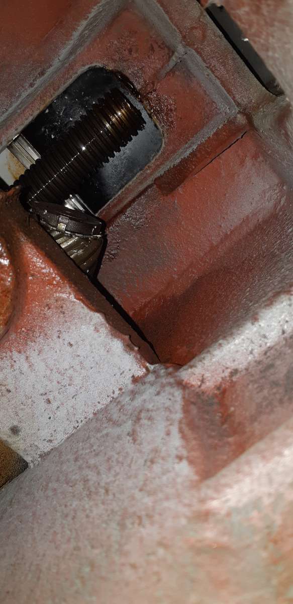

      Good afternoon. I have been redirected here  by Myford as they said they couldn’t help me. I have a Myford VM-E. the shaft for the Z axis has been pulled out about 10mm, I’m not sure how, and I’m not sure how to push it back in. The end inside the machine has a worm gear on it so I cannot hammer the shaft back in, the shaft does not go through the gear so I’m not sure how the 2 are held together unless the shaft is threaded?
      The machine is in our school workshop and if we can’t repair it we will not be able to afford a replacement.
      Anyone one with any experience that could offer some assistance would be greatly appreciated!

          Thanks Dave. it is the shaft for the raising handle I’m referring to. The back of the worm gear feels flush, does the shaft go right through the worm gear with the nut at the back or is the nut internal? I assume by saddle, you mean the casting on the outside of the machine that the shaft passes through? I cannot open the image you have attached for some reason but have attached a picture taken from below showing the worm gear.20240716_093558

            Hi The nut looks like it’s designed to be tightened with a C spanner and has a tab washer folded into one of the slots, so unlikely to be loose in this case. Is it simply a case of the dial assembly coming loose? I’m not near my machine at present so can’t have alook at mine. Might be worth removing the handle and dial assembly to investigate, sorry the picture didn’t open the only way to get a readable drawing was to photograph it, the manual really is tiny! Does the knee elevate and lower as it should?

              It’s all working perfectly well but I’m worried a student has managed to pull it out that far, I can’t risk leaving it as it is. The Worm gear looks like it is in the right position so it has to be the shaft which has moved. I’m now wondering if they have over wound it at its lowest point and unwound the thread from the nut?

                I have just remembered the whole assembly that carries the shaft is held on to the side of the knee by either 6 allen bolts or 4 bolts and 2 dowel pins. Undoing these will enable the whole casting to be easily removed so you can check it out on the bench. I worked for an importer of these machines for a short while, but this was around 1980 so all a bit hazy now!!! but they are good simple and robust machines. hope this is helpful. I’m out tonight but can have a look around my machine in the morning. From memory removing the shaft is only achievable by removing the nut, wormwheel and key  and taking the shaft out frontwards. I can’t remember how the drive dog that engages with the handle, and also forms the inner part of the dial is removed, i’m sure it has a key but other than that memory fails!

                    Had a look at my mill today and the casting that holds the shaft does indeed come off with 6 allen screws on mine, as Lathejack says they have been fillered over and painted but easy to see the dimples where the screws are, this should enable you to get to the nut and check the shaft without removing the table and saddle. As far as I can make out in the gloom under the knee that the nut on mine is flush with the end of the shaft pretty much like yours. I can’t see any evidence of a locking tab on mine, which looking at your picture yours seems to have. But as you say a determined student could probably wind the table right down and shear off the tab on any locking device, loosening the nut. good luck and please let us know how you get on.
