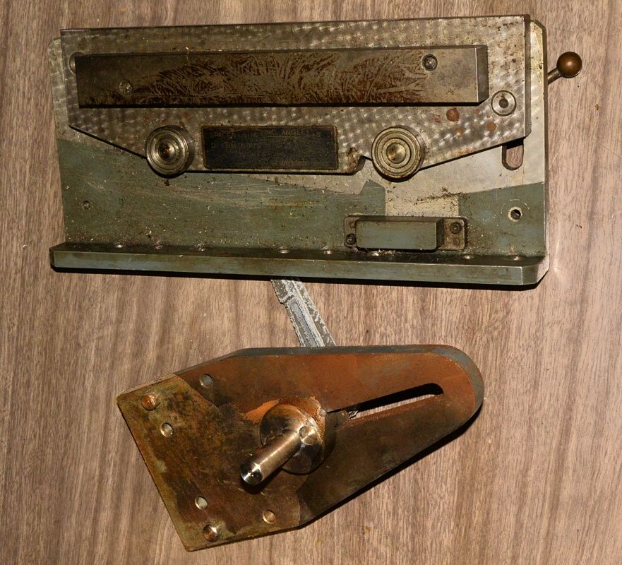

      Folks,
      I have recently acquired an incomplete Myford Taper Turning Attachment for my Super 7:
      A few bits are missing – the gib strip, the connecting arm and the socket. but these should be relatively straightforward to make. I've found plenty of pictures of the complete unit on the web and some text only instructions (sadly, the link to the "how to use" on the Myford site leads nowhere). However, I would be grateful for the following information: What is the thickness of the connecting arm? and I would like to see a picture or sketch of the socket. I'm sure I can work something out but it would be nice to see what the official items are like.

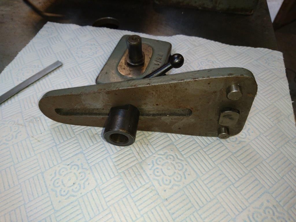

        Dave Daniels
          @davedaniels93256
          How interesting. I have a TTA with my S7 and for some perverse reason I have two of those 'Triangular Casting with a Slot, a Hole and two Locating Dowels' doins.
          It appears to have once been Myford green and is now sloshed over with grey paint.
          Just about visible is a # 73/1931
          I would insert pics. if I were on any other Forum but this one seems to have a crackpot arrangement which I don't intend to mess around with.  sad

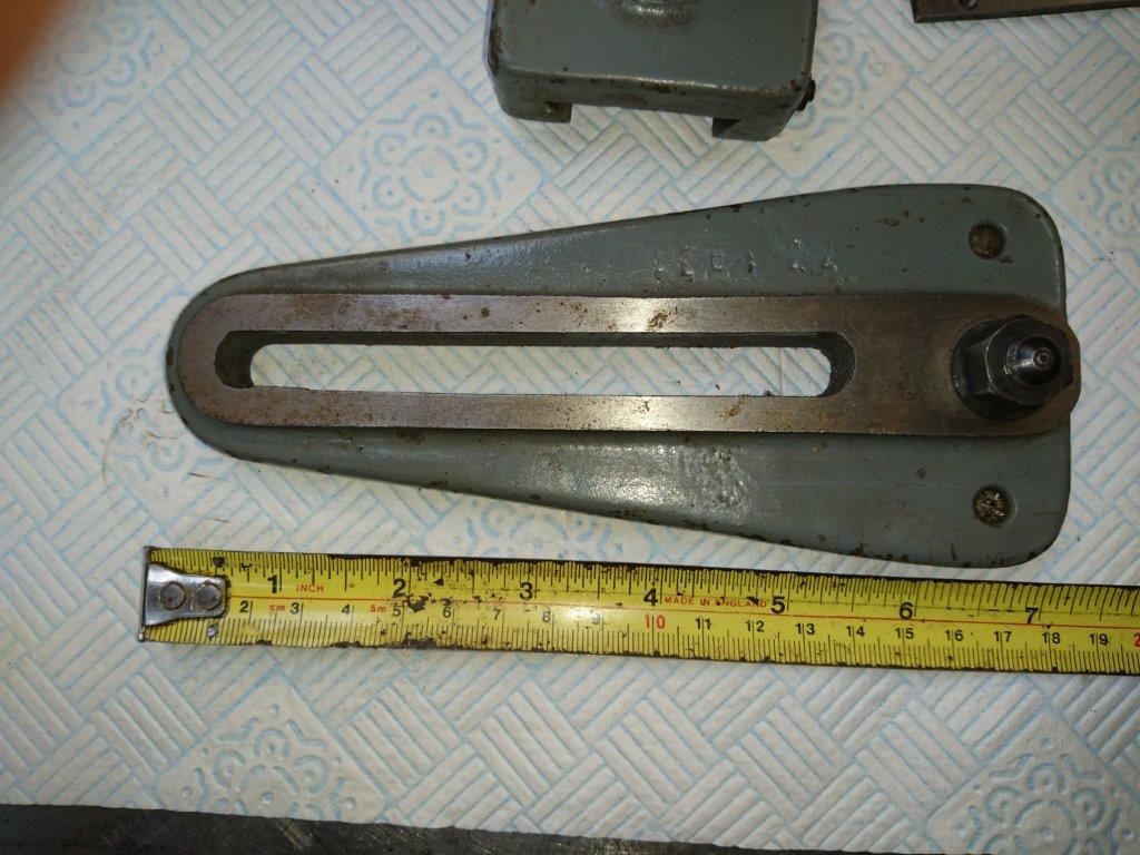

              Simon Williams 3
                @simonwilliams3
                BTW has anyone else noticed the date anomaly on the "Latest Forum Posts" Window?
                #222648
                Simon Williams 3
                  @simonwilliams3
                  dsc_0125-1.jpgdsc_0126-1.jpgHere are some pictures of what I think is the relevant part from my TTA. The casting is 7 ins long by a shade under 3 ins at its widest. The web is 14 mm 9/16 thick at the slot. If you need any further info pls ask.dsc_0127-1.jpg

                      #222700
                      Roderick Jenkins
                        @roderickjenkins93242
                        Simon,
                        Thank you very much. Just what I needed.
                        John, no need to risk the minotaur on my account, Dave D has kindly offered me his spare arm surprise
                        Thanks, all – it's good here isn't it smiley

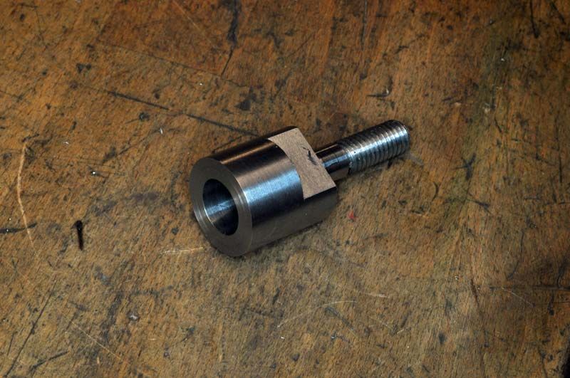

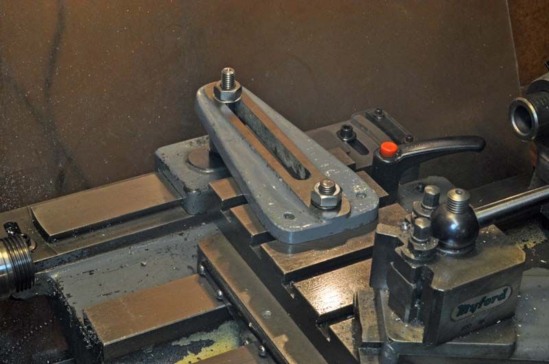

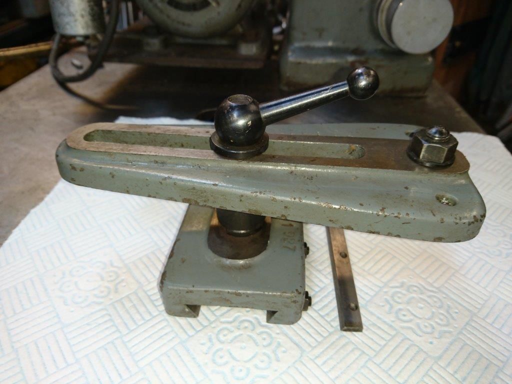

                        #222946
                        Roderick Jenkins
                          Thanks to the generosity of Dave Daniels with the gift of an arm and and Dave and Simon for the dimensioned drawing and pics, I now have a working Taper Turning Attachment:
                          I made the gib strip from a piece of 3/32" gauge plate and the socket from a length of 1" mild steel.
                          I'm not really sure why they use a ball handle rather than a plain nut for the arm lock but I think I ought to have a go at one – I made a Quorn once so I should be able to remember how to do it.
                          Cheers,
                          Rod
                          #222962
                          Dave Daniels
                            @davedaniels93256
                            Rod
                            Don't bother making one, I have one here …. dont know I'll send you one.
                            After all afternoon ferretting amongst all the Myford bits I still have a different sort of arrangement to connect from the guider wotsit to the cross-slide .. I'll e-mail you a pic. of the bits I have left over now I've got mine together like Simon's and yours ….

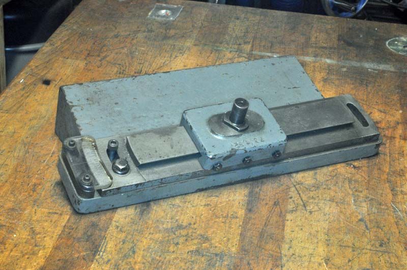

                            Ajohnw
                              @ajohnw51620
                              I have a similar unit left over from my Myford days. The main difference is that the taper adjustment is via a sine bar.
                              The sine bar aspect is 2 ball races. The adjustment end is set from a movable block so that it can initially be set to turn parallel.
                              #222970
                              Ajohnw
                                @ajohnw51620
                                This is it less the part that runs on the guide. The drive is via a pin into a hefty casting that isn't shown and runs on the guide.
                                Also a good illustration of why metal shouldn't be kept in the same cupboard as plastic bottles of hydrochloric and nitric acid. Maybe sulphuric too as that was removed and rebottled when I noticed that the bottles had gone rather rigid.
