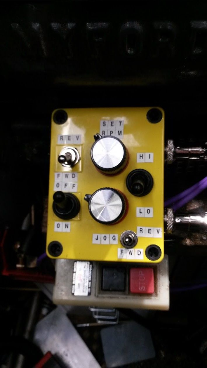

      This is the VFD control box, mounting position is undecided as yet, adding the clutch switch makes position less critical.
      This next bit is a temporary kludge with stuff that was lying around but after seeing my friend's M300 it's been niggling me that I have to use a switch to cut motor power.
      These show them working –

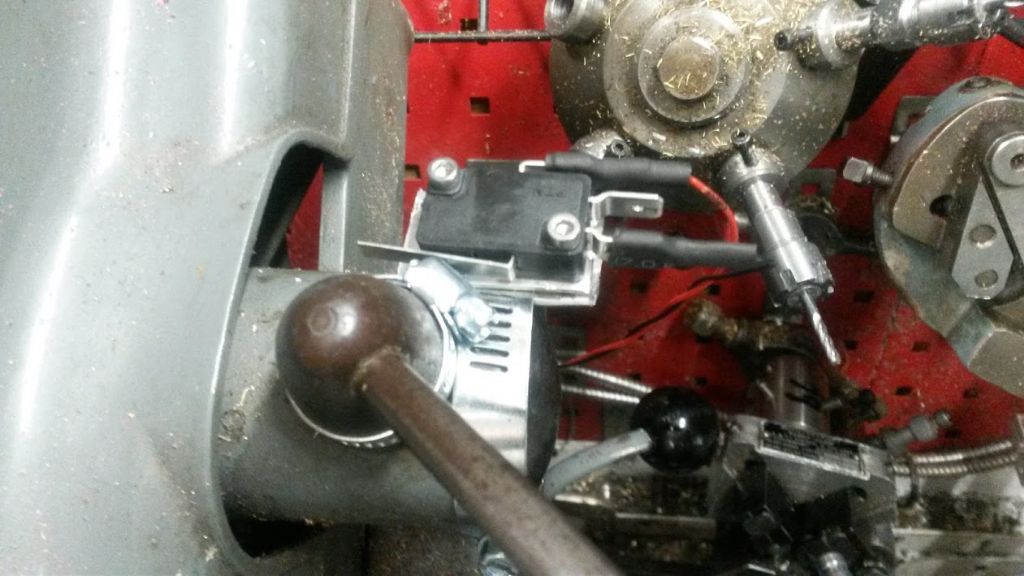

          What is the microswitch for Nick? An electrical interlock for the belt lever?

              #354535
              Nick Hulme
                @nickhulme30114
                Posted by Pete Rimmer on 12/05/2018 20:35:04:
                Sorry Pete, I missed that.
                No, it's on the clutch lever, it stops the motor at the end of travel just after the clutch is out and starts the motor again as you bring the lever away from it's end of travel just before the clutch is in, there is now an interlock switch on the spindle lock pin though.
                Since the video I've also changed the VFD modulation frequency to eliminate the audible ringing.
