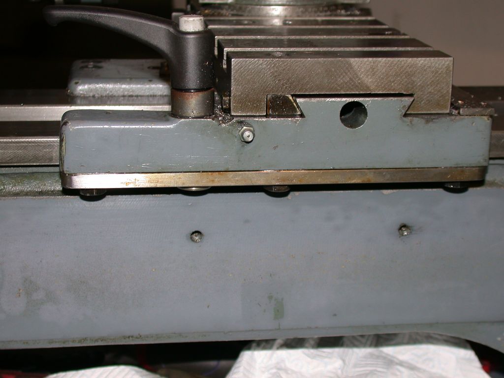

        S Deakin
          @sdeakin73134
          Look around the rear of the saddle, with the cross slide wound towards you (if you are standing at the front of the lathe) until it gives a clear view of the vertical face of the saddle. There should be a nipple about four inches to the left from the rear shear right hand edge. If thats where you have a threaded hole, it should be 2BA. Nipples are available from Myford.

          Robbo
            @robbo
            To back up previous post, here is a pic of the rear of the saddle showing the nipple.
            Happen to have a S7 in part dismantled state on movable cabinet, so easy to take pic.s7 rear saddle.jpg

                        #121879
                        Robbo
                          @robbo
                          Can only emphasise Roy's post, it's an oil nipple, don't put grease in it, it won't get where it's needed and will bung up the oilways, needing a dismantle to clean it out.
                          About 1" into the saddle is right for the oil hole, at it's end it meets up with another hole drilled from the underside of the saddle, at rt angles to the first one. This 2nd hole is in the middle of a channel milled into the underside of the saddle, diagonally across the width, so the oil is spread over the full surface between the saddle and the bed.

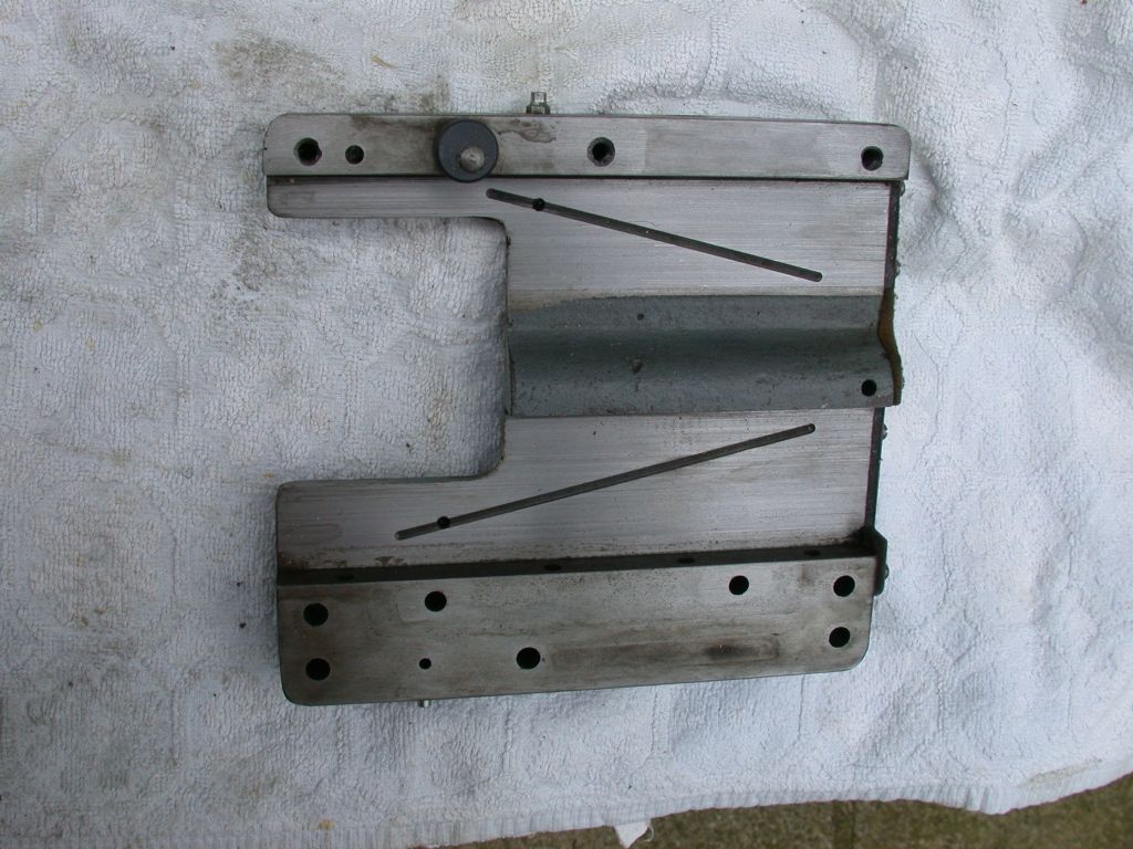

                            Robbo
                              @robbo
                              Hi Harry et al,
                              Think we've beaten this one to death, but as I had the saddle off the S7 today thought I may as well include a shot to show the oil distribution.
                              Memory a bit faulty as to the location of the hole into the oil channel, but 'nowt new there.
                              #121967
                              Harry Wilkes
                                @harrywilkes58467
                                Thanks for the pic shows the oild distribution well smiley
                                Cheers H

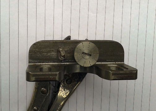

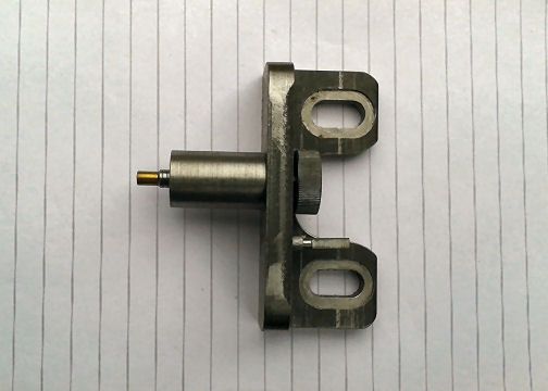

                                    found this part in box that came with lathe any idea what it is ?

                                      Sub Mandrel
                                        @submandrel
                                        Hi Harry,
                                        That looks like a mcrometer stop of some sort.

                                            Neil Greenaway
                                              @neilgreenaway71611
                                              Hi there
                                              That item in your photo wouldnt happen to be the makings of a filing rest. Two rollers could be mounted on pins through the slotted holes with the pillar being mounted off the cross slide?
                                              #122064
                                              Robbo
                                                @robbo
                                                I think Harry's teasing us by having two views of the same thing in one picture.
                                                If the holes in the bracket match up with the slots in the cross-slide then I would go for a micrometer stop, especially if turning the dial makes that "sticky-out bit" (excuse technical term) move in and out.
