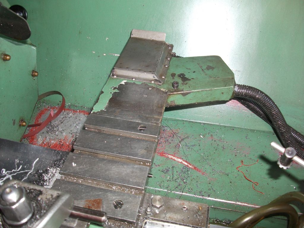

      Having delved into ELS and been happy with the functionality, I'm now left with wanting more!!
      Has anyone fitted a stepper to the rear of an S7 cross slide? I'm interested to see how neat I can make it. I would also like to add an engage/disengage mechanism for the stepper (although the new ELS system can be set to switch off the stepper motor)
      Any thoughts most welcome.
      Matt

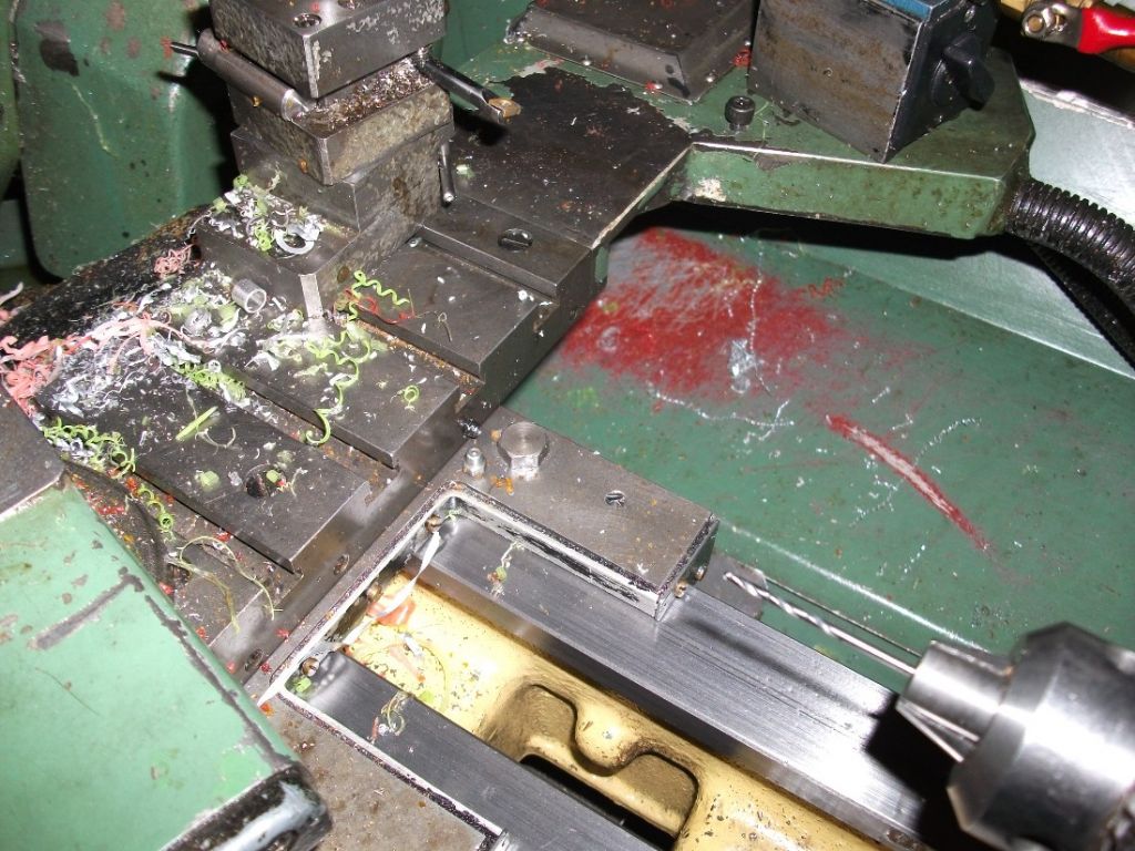

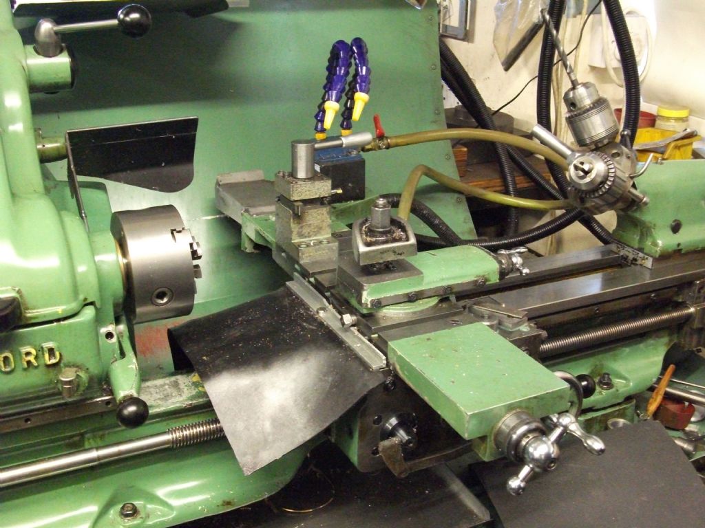

        John P
          @johnp77052
          I converted my Myford about 17 years ago the stepper motor is
          mounted on the rear bracket at the back of the crosslide.I made a complete
          new leadscrew and anti backlash nut and new front bracket to keep
          the slide clear of swarf, the motor is joined to the leadscrew with a solid coupling.

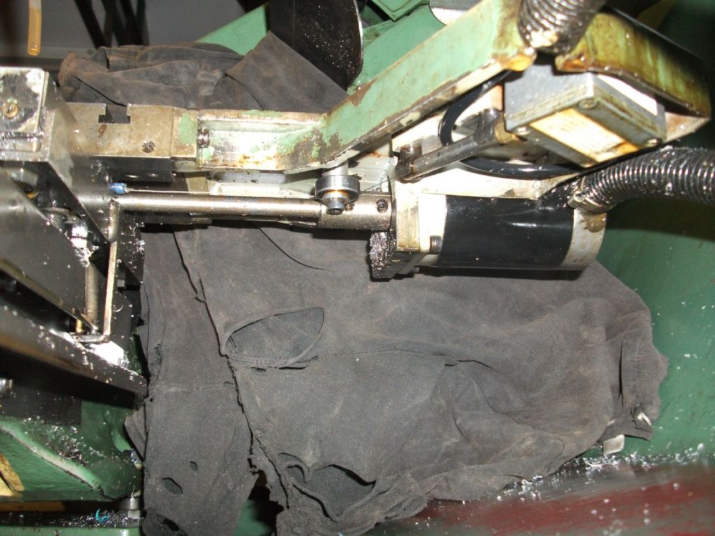

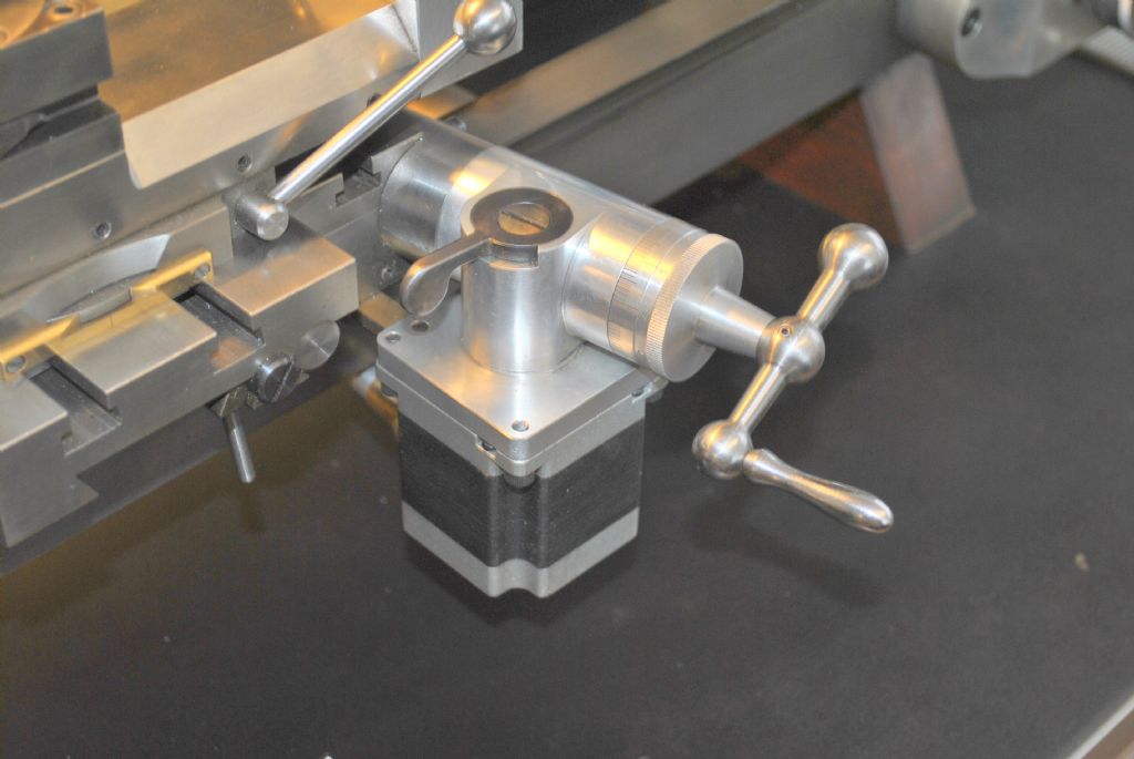

          John Haine
            @johnhaine32865
            Matt, you are teetering on the brink of a slippery slope!
            I think (can't quite recall as it's years since mine was removed) the problem is that the standard screw doesn't reach the back of the slide casting so would need an extension which is a bit fiddly. Easier to drive from the front end.
            If you were replacing the screw with something longer you might fit a ball screw to get rid of most of the backlash as well as being easier to drive. A non-PXF S7 can only accomodate (I think) an 8mm ballscrew, mainly because of the diameter of the nut which won't fit the "tunnel". Those are available but expensive compared to larger sizes like 12 or 16mm, and need a bearing at the back as well. This is the approach taken by cncyourmyford.
            I use a 12mm screw but in a PXF machine which has a much larger tunnel, and I have the nut "turned round" so the parallel section that normally locates in a bored hole projects out. I drive it direct from a NEMA stepper with an Oldham coupling.
            As you see I've fabricated a new bracket.
            Once you have a stepper on the cross slide you'll need to be careful not to slide down the full CNC rabbit hole, though I can tell you that it's very nice once you're in!

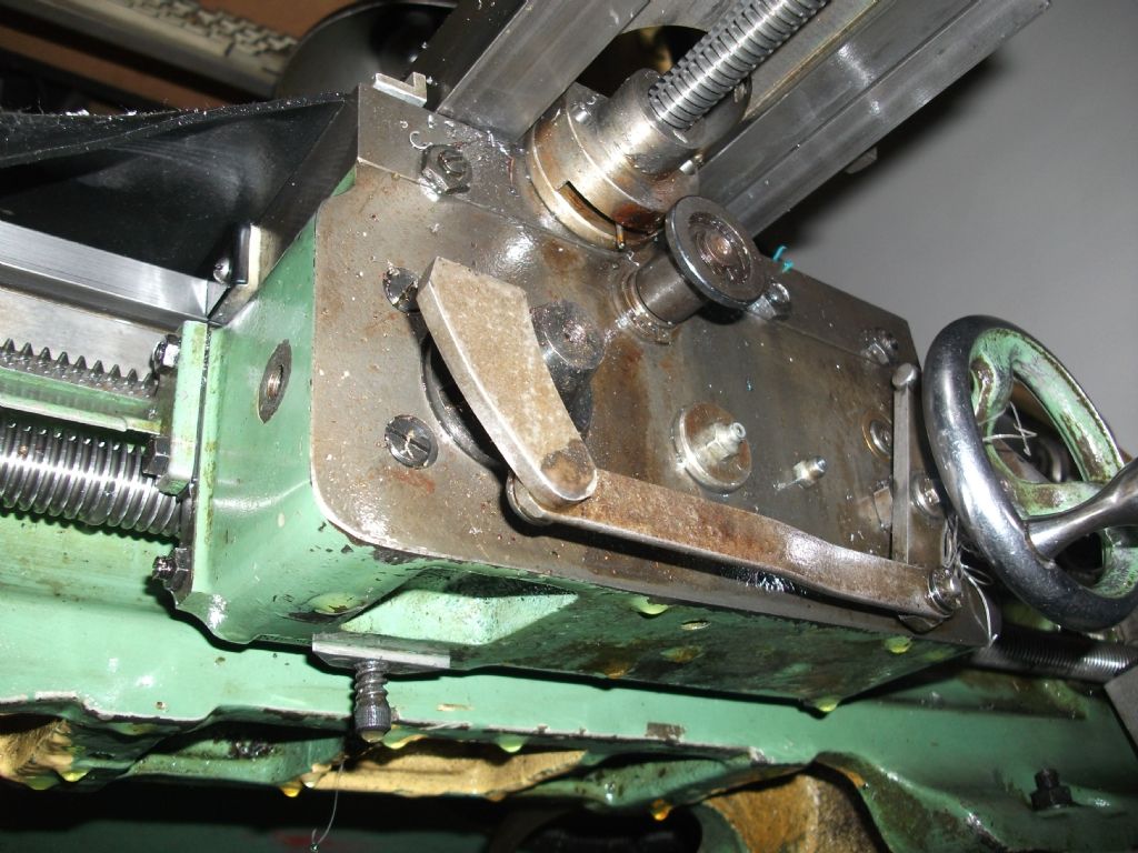

                    Here are some better photo's ,the rear bracket is just fixed with 2 screws ,originally
                    it was just the location for the BW electronics wire DRO ,when i converted to the
                    cnc setup i had to alter the bracket to this "Y" shape to be able to fit
                    the stepper motor and and also the encoder .Fitting at the back of the machine
                    allows the cabling to be out of the way and you don't have the motor hanging out
                    half way across the workshop.
                    I made a new leadscrew to fit the existing nut and it has a top hat oilfilled nylon
                    nut piggy backed on the original nut ,the small peg hanging down in the photo 3
                    allows the second nut to rotate to adjust the backlash ,the retaining housing uses the
                    existing screw fixings and clamps up the second nut to retain it .You can see
                    here in photo 4 the plain part of the new leadscrew and the solid coupling.
                    It is not really necessary to use a ball screw if you are intending to keep the machine
                    as part manual use it would be better off to retain the existing setup ,its 17 years
                    since i changed this screw there is very little wear present ,in any case it is only £7
                    of material and few hours work to make a new one .
                    I have 7 machines that have been made or converted to cnc none of them
                    have ballscrews all except 2 are part manual use ,they all use the same cnc
                    system "Compucut" an old system now but still very reliable, on the Myford
                    i unplug the crosslide axis when it is used manually and use the Compucut
                    system to drive the leadscrew for power feed.

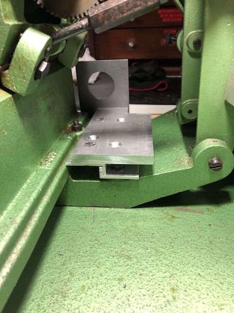

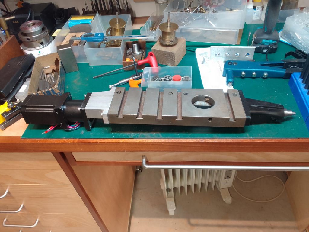

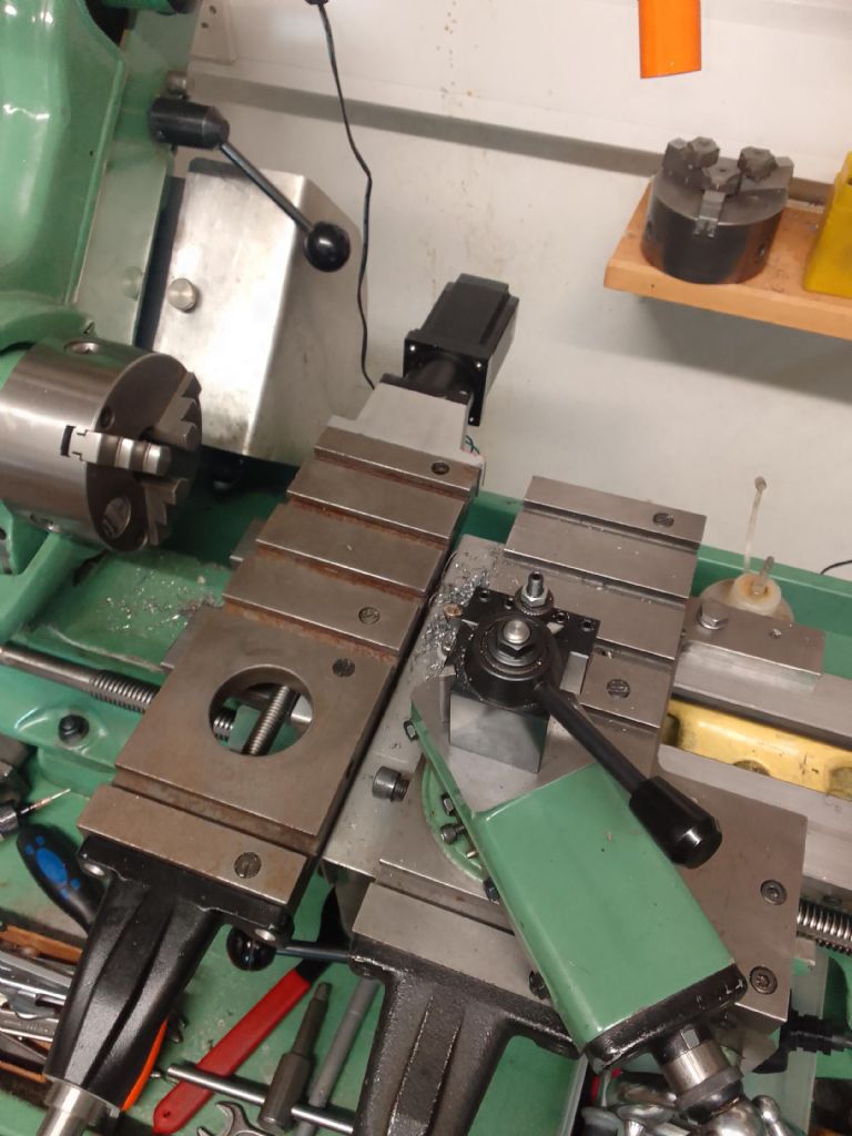

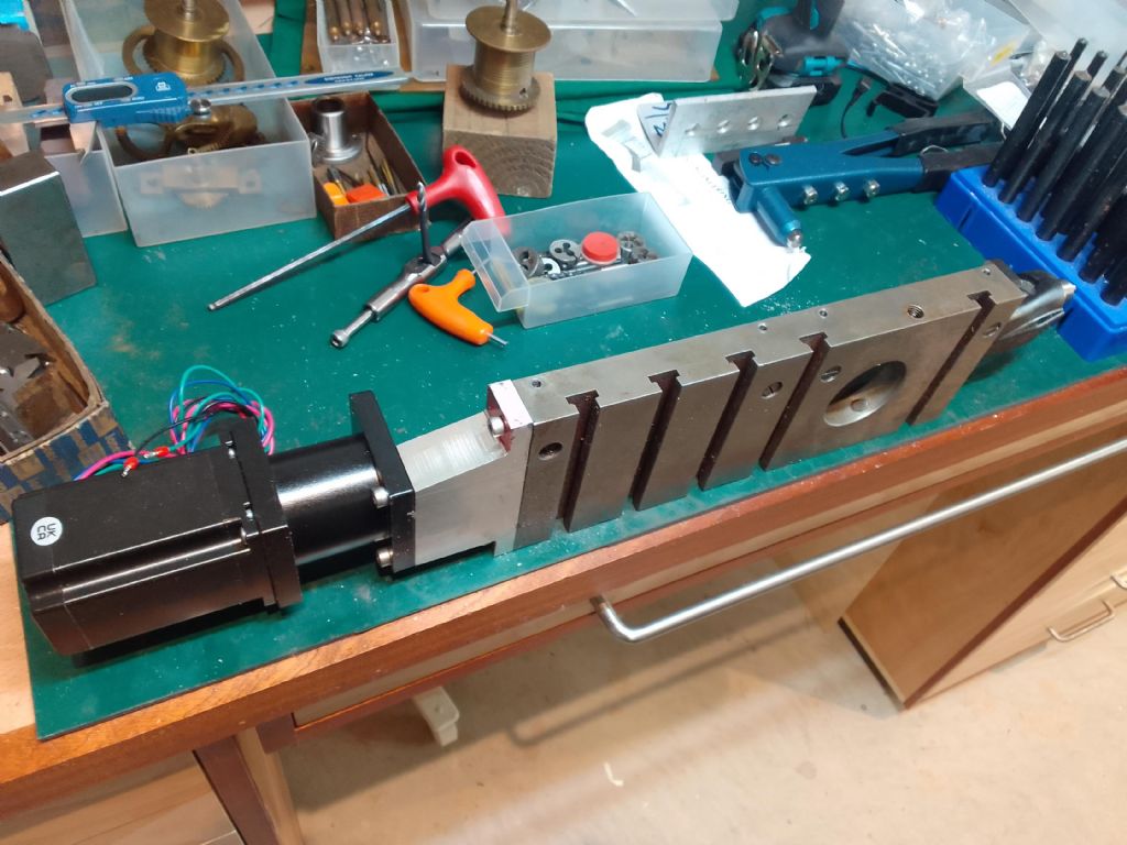

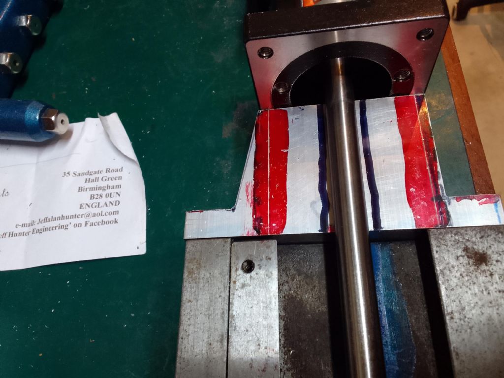

                                      Well, the warmer weather has allowed me to carry on with the ELS project. One point to note – if you choose the Rocketroincs system the software for the PRO4 version is not the same as the BASIC system. The basic has a facility for threading if you only have the Z axis motorised. (auto pauses for retracting and feed in) The PRO version does not. (although the website at the time claimed the software was identical)!!
                                      Anyway, on with the update. This photo shows the general layout. (I'm using the standard screw for the moment)
                                      This shot compares the standard cross slide 'v' the modified.
                                      The next shot is the underneath. The bracket needs a little work here. Initially to give a little space for the screw. I will 'hog' out the underneath as well should I need extra travel for the dovetail. (I can't remember ever having to use the cross slide so far forward.
                                      The screw was extended using 10mm rod – this cleared the leadscrew nut. It has been dowelled and will be loctited into place. Whether it needs pinning, we will see later.
                                      I will probably turn the stepper adapter around to reveal the oldham coupling and allow me to easily unclamp when assembling. Still a bit to go but it gives you an idea…..

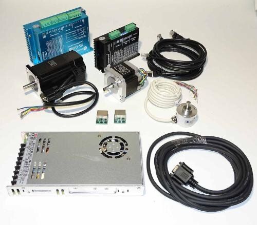

                                          Dell
                                            @dell
                                            I have been reading this post with interest, due to the problem I have with my hand and getting worse and eyes not as good as they used to be , I have bitten the bullet and ordered the full kit from Rocketronics, I ordered some pulley’s from makers hut and what a load of rubbish they are serves me right for cutting costs so they are going back, I have now ordered some from gear & sprockets, although the kit hasn’t arrived yet ( but cleared customs ) I can’t do to much but I have worked out where to fit the Z stepper and pre made the bracket and yes I did make a mistake and drilled the holes in wrong place but it’s only a mounting plate and the plate is fixed using the 2 bolts that bolt the motor mount so no hole drilling , I am also fairly sure I can mount the encoder where the change wheels were ( fingers crossed) I will start a new post when I get going properly.
                                            Dell

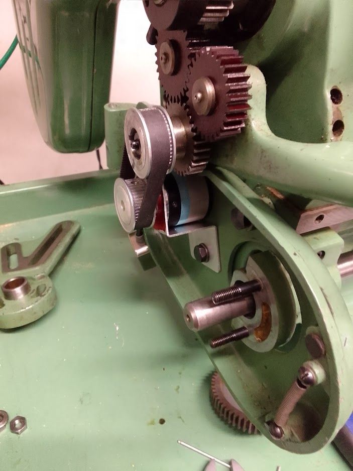

                                              Dell, I'm sure you can get the encoder to fit within the gear cover on an ML10. I will photo the arrangement for a non gearbox S7 machine and a gearbox one for reference. The encoders have such little resistance to turning that thin bracketry is only required. Matt
                                              #642581

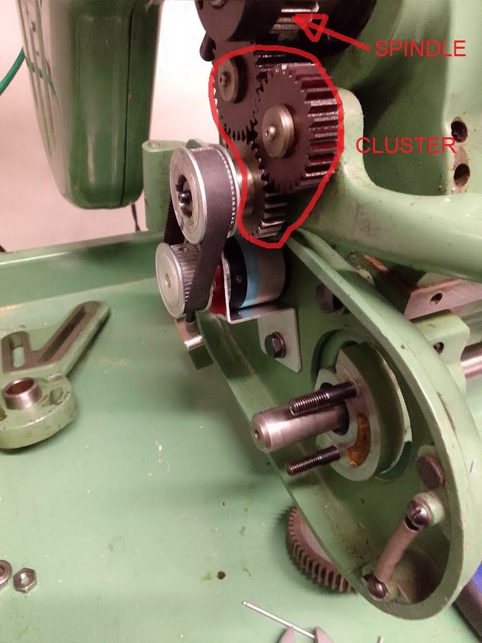

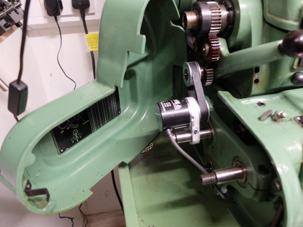

                                              Matt Harrington
                                                @mattharrington87221
                                                This is the S7 gearbox encoder mount:
                                                And this is the mount on a non-gearbox S7:
                                                I have thinner pulleys to use for the non-gearbox setup but will fit later. The bracket is such that the encoder is flush with the inside of the housing.
                                                Matt
                                                Edited By Matt Harrington on 25/04/2023 18:22:14
                                                #642608
                                                Joseph Noci 1
                                                  @josephnoci1
                                                  Matt,
                                                  What is the ratio between the encoder and lathe main spindle? Is it 1:1 ? difficult to see gear sizes, but the spindle gear to feed reversing cluster looks not to be 1:1 ?
                                                  #642613
                                                  Matt Harrington
                                                    Yes, the two pulleys are the same diameter – 1:1
                                                    Matt
                                                    #642620
                                                    Joseph Noci 1
                                                      @josephnoci1
                                                      Sorry, I was not clear enough – the GEAR ratios, not the pulleys – as in the edited photo below – what is the spindle to cluster gear ratio?
