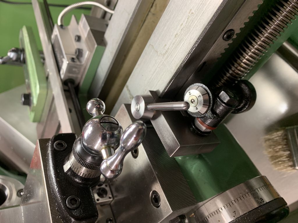

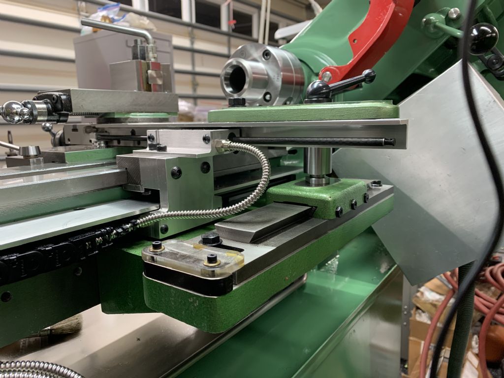

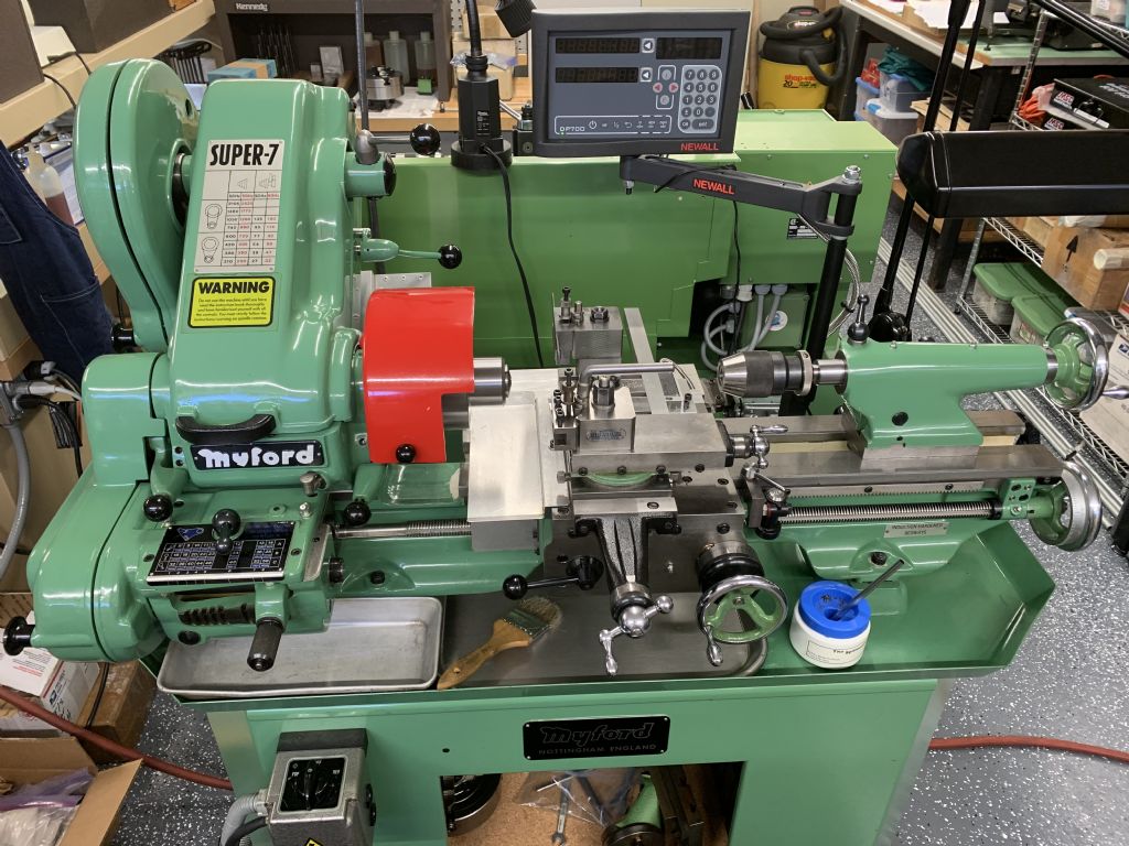

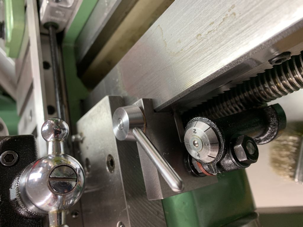

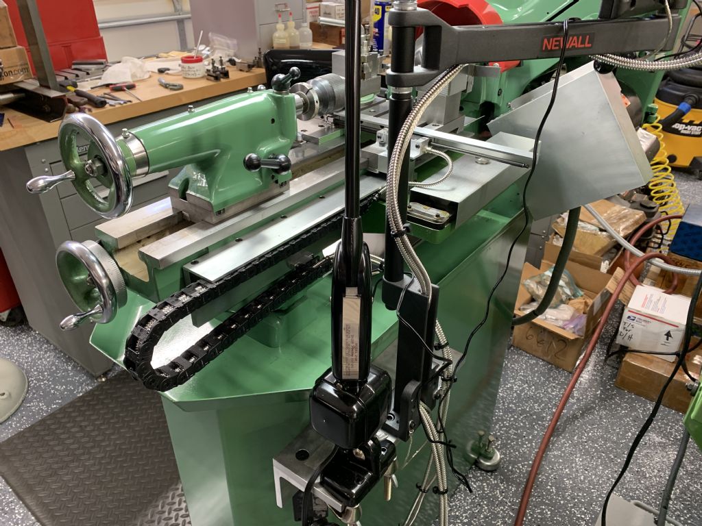

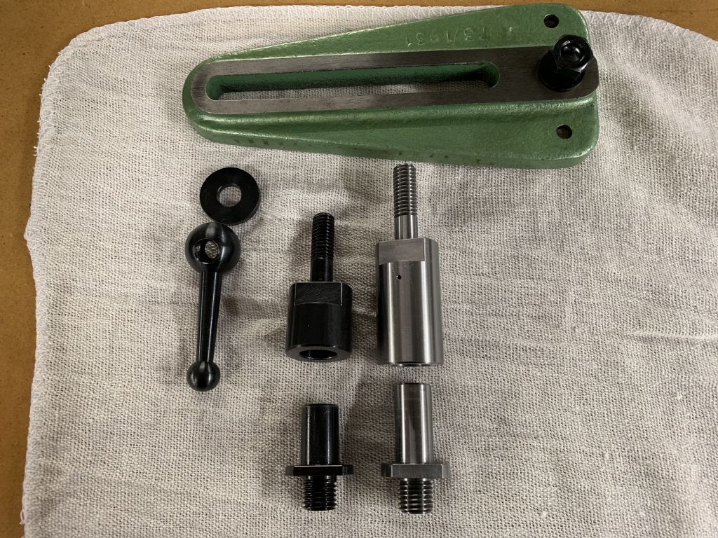

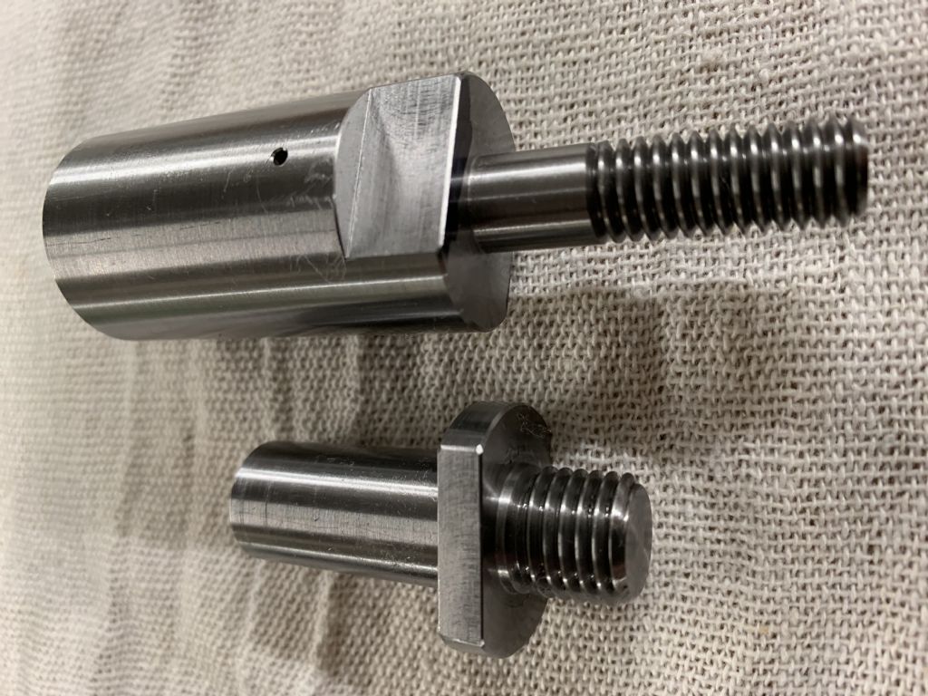

        While trying to navigate this forum and figuring out how to post in order to ask a question today, I realized that I owe Barry Harrison aka ‘KWIL’, I believe, a long overdue thank you for his article in MEW December 2002/ January 2003 and his posts here on installing a Newall DRO on a Myford S7 lathe.
        What was unique about his installation concept is the ability to retain full use of the rear bed mounted taper attachment. I have actually completed this on two different S7 lathes I have owned over the years. Long story, sold the first one due to a cross country move. Big mistake. Just made more work in the end. Recently completed the second one. Here are some photos. Happy to answer any questions.
        Edit: Thanks Barry Harrison for the concept in his MEW article and thanks to Ken Wilson (KWIL) for the photos in his album of a very similar installation and for answering my questions during my first installation, especially for pointing me to the article on the front mounted ‘MYFORD SADDLE LOCK’ by Don Ainley. Not sure what issue, but think it was in ME. Thanks Chris Tice for setting me straight.bdc1e243-2420-47ba-8f75-aa37ec026117.jpeg
        Myford S7 Serial #SK164898 (1994?)
        Rear view of the encoder mounting and installed taper attachment.
        Back of lathe view showing chip guards, DRO cable protection and display/light mounting.
        Required extensions for taper attachment. Z axis scale and taper attachment are mounted to a steel plate which is attached via the original T/A mounting tapped holes. T/A is installed lower than original mounting necessitating the distance be made up with new extensions.
        Installation requires moving the carriage lock to the front of the lathe. Sorry for the rotated photos. Can’t seem to fix this.
