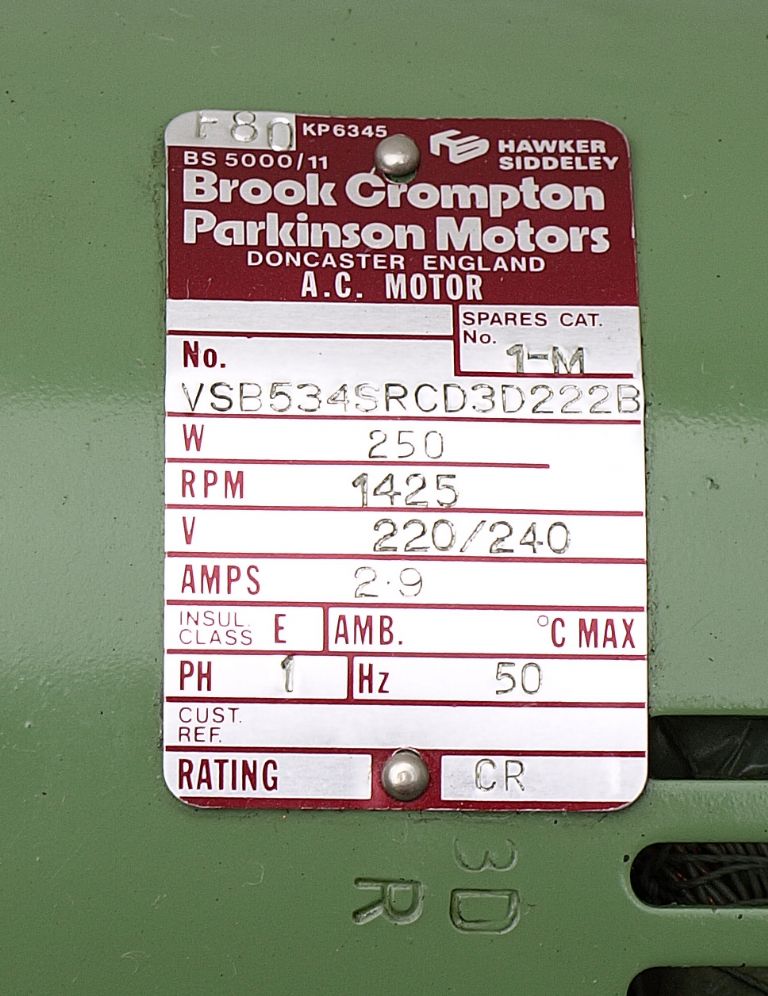

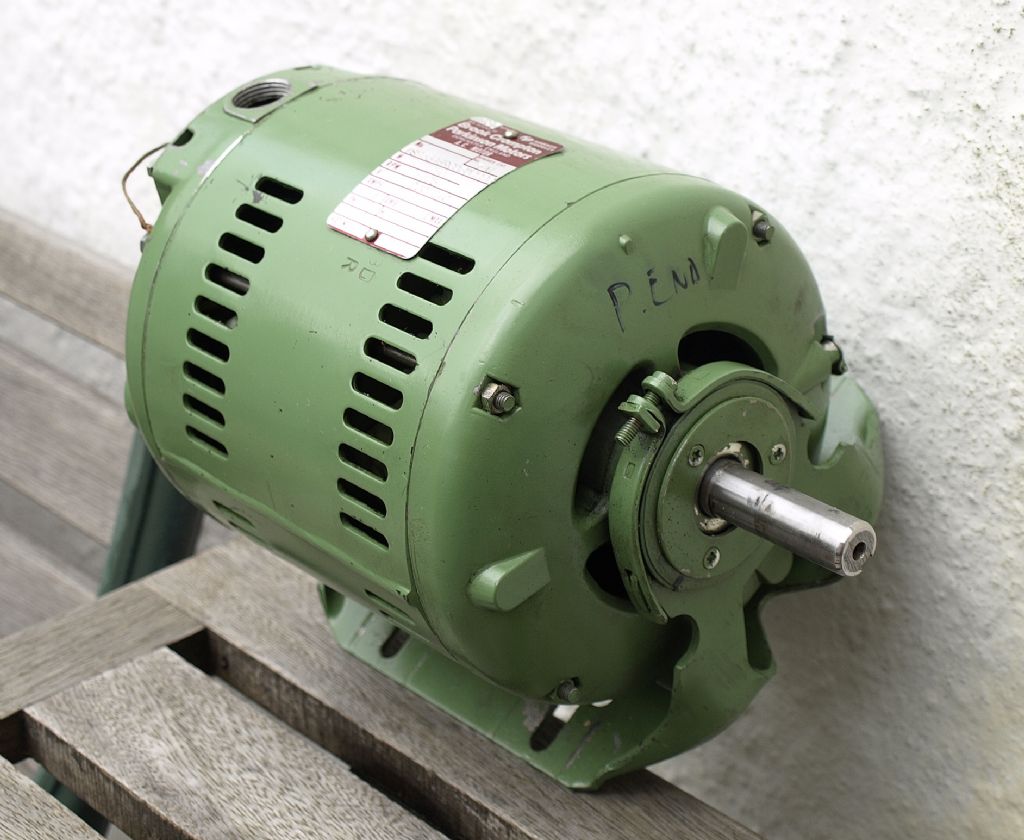

      Can anybody throw any light on how a ML7-R lathe purchased in 1984 as brand new from Buck & Hickman  came to have a 1/3 HP split phase motor fitted whereas the handbook states 1/2 HP three phase or 3/4 HP single phase (capacitor start)
      The colleague I purchased this lathe was never aware of this and it has performed tirelessly since 1984.
      I wasn’t even aware that Myford produced  a 1/3 HP motor.
      I’d put some images on of the motor and  plate on this thread but I haven’t cracked the system yet.
      Len P.

            It was starting to give problems Les.
            I’d completed a few jobs with it until one day recentIy switched on and It started smoking, something’s not quite right I thought .
            I changed to the lower speed range and it performed OK.  I still felt uneasy so I stripped the motor down to look for evidence of start windings being overloaded but nothing was  visible.
            Anyway I had a spare 3/4HP Brookes motor lying around as one does and I put that back on.
            The lathe goes like a bomb now (not a smoke bomb I might add) throughout the complete speed range.
            Thanks for your help on uploading images.
