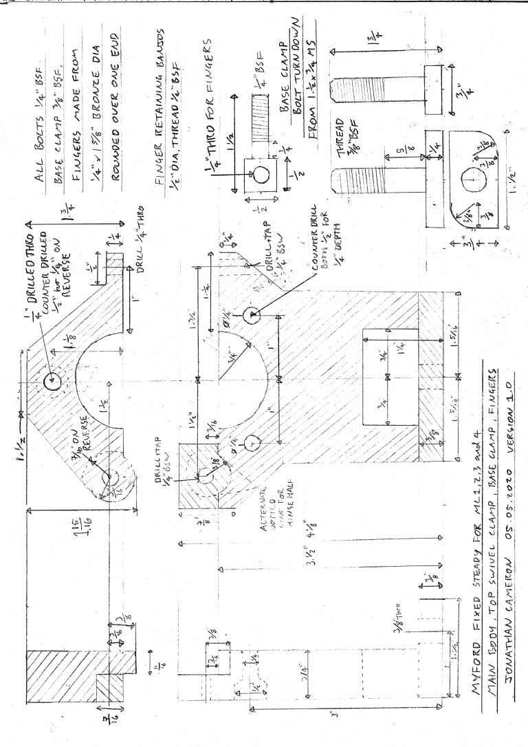

      Posted by Jon Cameron on 06/05/2020 11:14:29:
      Hi Michael,
      That may be clearer than the windows snipping tool I used for the image posted above.
      Here we go …
      [ click image for full size ]
      Nicely done, Jon yes
      #469562
      Jon Cameron
        @joncameron26580
        Thanks Michael,
        I have also posted the steady on a new thread, as it's likely to get lost in this one for anyone searching the forum via Google. It can be found here for reference. **LINK**
        It'll also be posted on a couple of myford related facebook groups in the files section as the PDF. So is easy to find again.
        Luke, I do have the materials in stock that were dug out the skip at work. so I could possibly get the steady to the point where you need to just make the fixing bolts and finger parts for it. I have already volunteered myself to make one, which is why the drawings were produced. Most of it can be made up on the pillar drill, but until i've got my lathe back together I cant turn the fingers, bolts, and base clamp for you.
        Jon

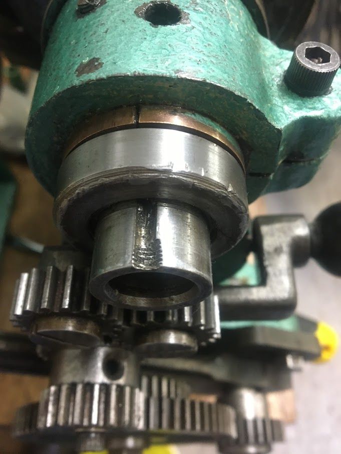

            I managed to order the wrong thrust bearing. I ordered a very similarly-size metric bearing and it was just too small. I've now found what I believe to be the correct size (1 x 1-5/8 x 3/8", often written FT1) and ordered one of those. That was a waste of £15, I shall have to think of a suitable project for it.
            Jon, I know we've spoken elsewhere about your suggestion but I'd like to address it here so that others may benefit. I think that the bearings were installed correctly for two reasons:
            1. The grub screws locate in small indentations in the outside of the bearings, the holes aren't visible on the inside.
            2. The left-hand bearing has a shoulder that protrudes and abuts the casting. I don't think there is space for this on the right-hand casting as the bull gear/pulley assembly occupy all of the spindle.
            This photo shows the protruding bearing shoulder. It's a bit covered in paint – which I will clean up when I get around to repainting the lathe – but the bronze is visible.

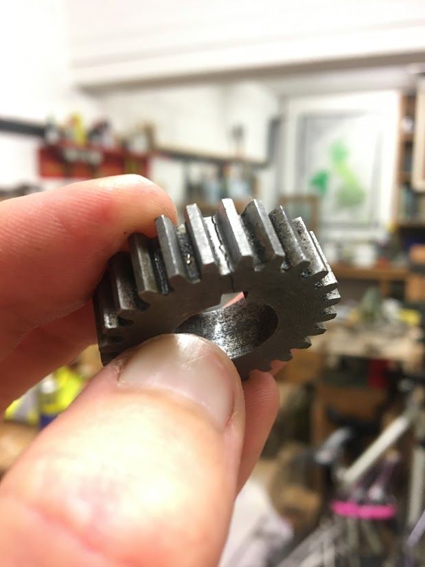

            Brian, I've cleaned up the gear and will post a photo below. It has cracked all the way through and I believe it will need to be sawn + brazed, as per your revised instructions.

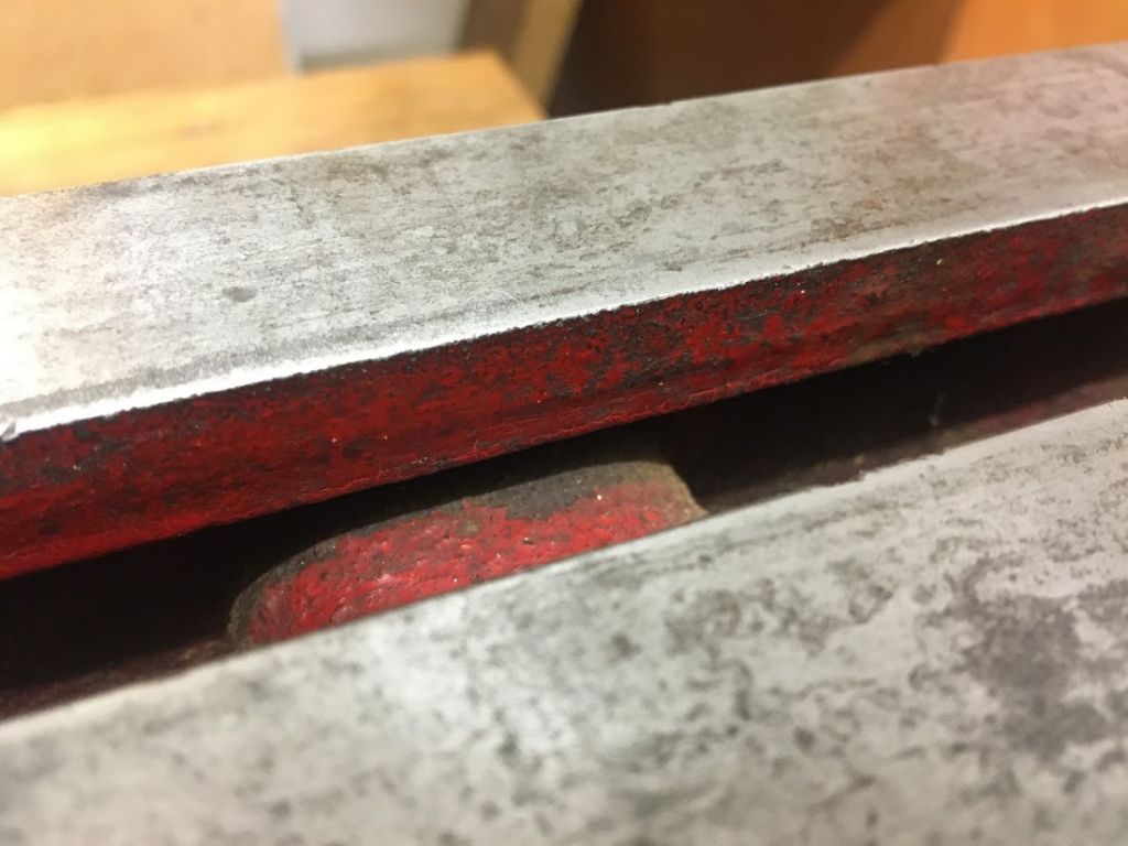

            Regarding the lathe bed, here is a photograph of the condition of the gap between the ways on my lathe. They are definitely not an accurately-machined surface (although, as someone mentioned, they could become so with relative ease if I can find the right person/mill!).
            The gap that I measured was between the ways themselves but it did occur to me, as I took this photograph, that the space below the ways could be used as a clamping surface. I'm not sure what this distance is as I don't have any telescoping gauges with which to measure it. Perhaps I was mistaken in my understanding and this is the clamping surface always used?

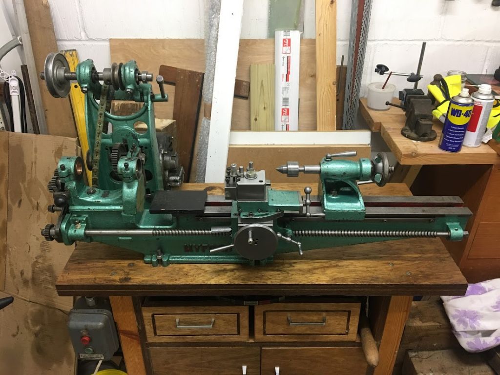

            Finally, here is the lathe as it sits this evening. Hopefully I'll get the spindle re-installed soon – I've been spending a lot of time cleaning up all of the little burs, of which there are many!

              The slits in the bearings chould align with the slit in the casting so they close together. The grub screws in the casting are not factory fitted. I'd suggest that at some time in the past the bearings have been rotated counter-clockwise by 90 degrees to compensate for wear and the grub screws added to allow compression of the bearing.
              With the bearing rotated like this you need to be even more careful than usual when tighting the bearing clamp bolts becuse the bearings can't close and it will be very easy to crack the casting. The rotation of the bearings has also blocked the oil holes, on the rear bearing at least. The only path for the oil is through the slit in the bearing, but of course the oil will run out of the ends of the slit rather than onto the bearing surface. The slit is not even properly aligned with the oil hole.
              Ideally you need a new pair of bearing bushes.

                Yes as discussed, and shown above the bearings have rotated in the headstock, and there is no way to adjust the slack out of the bearings, and close them down onto the spindle.
                Robert the grub screws are a standard factory fit item their position has changed from the earlier models but this is probably due to the amount of people suffering the cracked headstock, so the screws been off set help to eliminate a weak point with the two holes for oil and grub screw been in line.
                As correctly said by Robert with the slit in the position shown there is a real risk of the headstock cracking, so check alignment of slit and grub screw/oil holes on reassembly, studying your photos that the posted a link to it would appear that the rear bearing doesn't seem to line up with the oil hole, although it could be just the angle the photo is taken, but these are my reasons for assuming the bearings have been installed front to back, and back to front, as well as been spun at an awkward angle for adjustment.
                  Hi Luke, Above photo, the lower surface on the underneath of the beds ways, is the clamping surface the fixed steady uses on my lathe. mine measures 1/4" but is tight on two ribs so 3/16" may be a better thickness for the clamp. As with my reply above buy two feeler gauge sets from toolstation or similar, mine cost around £5 each. you can then measure the gap on the underside of the ways for reference, and use both to check the gap when reinstalling the spindle. been able to clamp the bolts tight down onto the gauges while checking the spindle still turns freely.

                    This gets ever more interesting. You and Jon have far more experience with these bearing bushes than I had. Dad never touched them other than to adjust for correct running. Neither he nor I fiddled with the grub screws and as Robert Atkinson has observed, maybe they need replacing. Certainly the slits should align with the split in the bearing housings, the shells will be unable to close otherwise.
                    I would be guided by the position of the oil holes as to whether they have been transposed at some time, but from the condition they seemed to be in as shown in your earlier pictures, they don't need replacing in my view, nor that of Howard Lewis; it is more a case of deciding if they have been mixed up and getting them back where they belong.
                    The cracked gear. Well now, it is so obvious once  the dog can see the rabbit. When you come to repair it you do need to ensure the tooth gap across crack [which you will have sawn out by now] is the same as that for the other teeth.
                    Measure adjacent tooth gaps with your calipers over the outside of the teeth and note the values. Then do the same measurement over the one to repair and adjust the value by squeezing it up carefully in your vice before you apply the heat and braze metal.
                    Do make sure you have a support below it to stop it dropping within the vice jaws when it gets hot.
                    Measured that way it is so much easier than trying to get consistency in the narrow gap right above the root of a tooth. I think you will find the gear has opened up slightly, the crack has width and will have eased some local stress. It is still a curiosity to me though !!

                      Brian, I've already repositioned the bearings so that the splits line up with those in the housings. Next time I work on the lathe I'll take some more photographs – I may extract the bearings again to double-check that they are positioned in the correct location but I am almost certain that they are.
